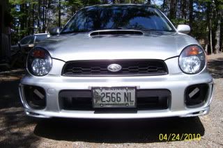

Before

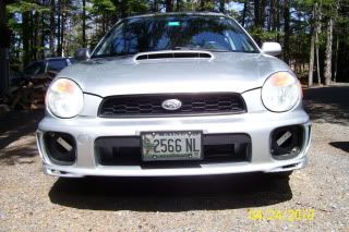

After

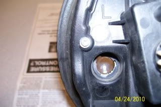

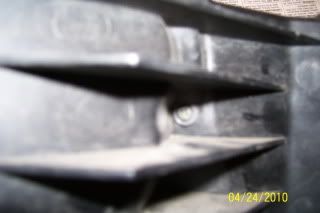

There are two small screws on the back of the assemblies that need to come out.

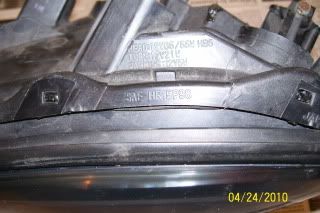

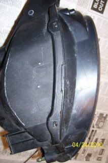

I put the assembly in the oven at 195 for 10 minutes. There are some tabs around the housing. Take a thin screwdriver and gently start prying apart the housing at the tabs.

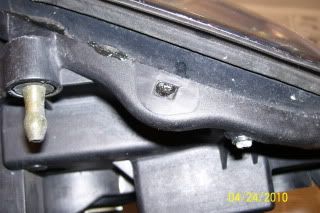

When removing the lights this post kinda holds it after you remove the bolts. The post is towards the outside of the light/car.

"Baking" the lights, and getting them apart is actually wicked easy. If your thinking of doing it, just use your common sense and go for it.
