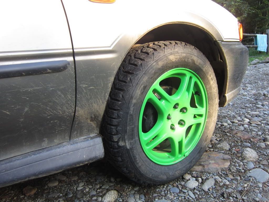

they are 215-60-16 firestone winterforces, had them for about 2 months and love them so far! good on road behavior and great on dirt and mud

These tires are WAY too small, they're off my old 04 WRX, and they were small on it... the car is a lot higher than it looks in the pics...
