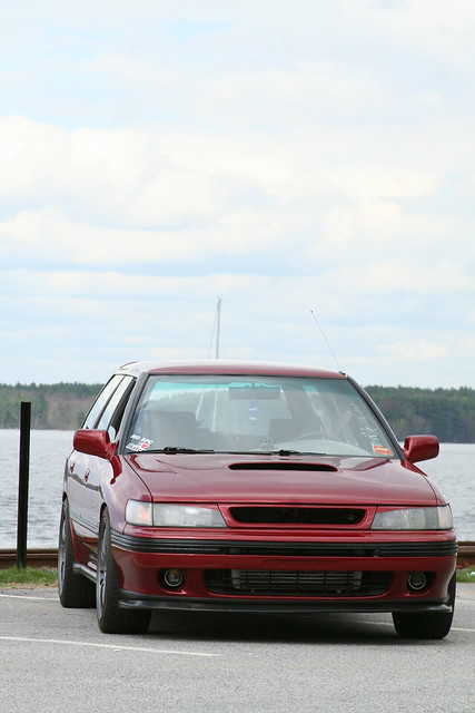

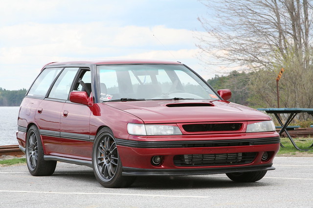

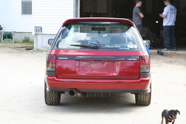

My 94 Legacy Wagon
Can't wait to see this in person! Saw the color on a little piece of tape before it was painted and it looked awesome!
Man this thing looks awesome. I can't wait to see it in person too. And I like the eyelids. Makes it look aggressive
That car does look amazing. Great choice on the color and I agree about the lids making it look more aggressive! I can't wait to see it at the meet.
