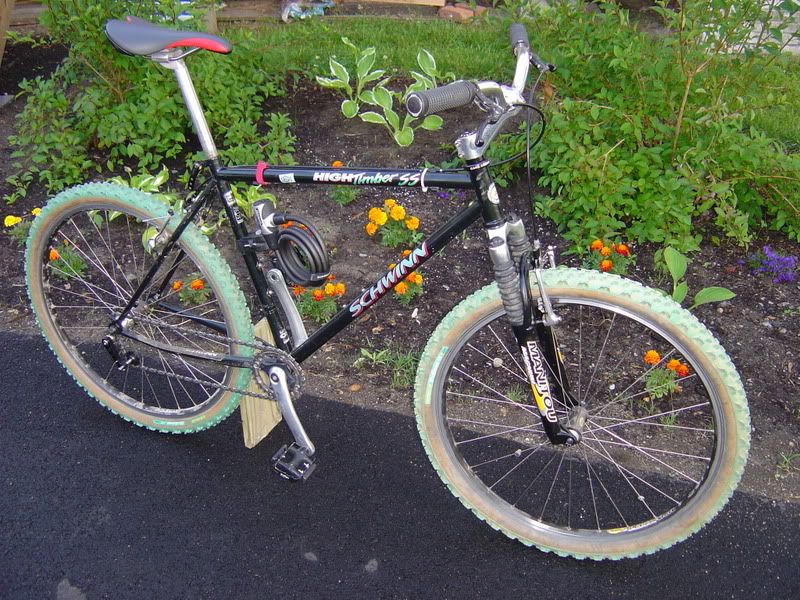

Completed the single speed today. Cost about $70 in parts that I didn't already have.... would've been less but the headset was borked then the damn pedal blew up on a test ride. arghhh!

Those are Michelin Wild Gripper Lite S tires! I like 'em cuz they match the writing on the frame.
This is the "around town beater" soon to be seen at places like Hannaford, Shaws and a few trips across teh bridge to Standard Baking. It should really have a semi-slick tire on it but i'm just workin' with what I have.

Well SoPoSube was over yesterday and he took it for a spin down the street. Said it was skipping on the back ring when under "force". Hmmm... I wonder if it's the Nashbar tensioner cuz Pedro is having a similar issue with his.

had my buddy that works at a local shop take a look at it today @ work. He is pretty convinced that the rear cogs are for a wider spaced chain. so basically Nashbar sold us some BMX sprockets... grr.. time to give them a call...
Typically that's what i'd expect them to have, BMX cogs. But i've run them before with a regular chain and it all worked out ok.
The link spacing is off. so under power it jumps. I am going to order one of the king SS cogs and see how that goes. I am going to pop the Cassette back on for now so I can actually ride it.
One of you guys try a BMX chain? Let us know if that works.
I think the link spacing will be too much for the chainring and wear it prematurely.

If by "link spacing", you mean the distance between each roller bearing lengthwise, That is a standard 1/2" on all chain. Only the inner widths are different. At least on all the chains I have.
Maybe, whoever makes that cog for Nashbar doesn't have very good manufacturing tolerances and the cog spacing is off.?.?.?.
Pedro - what cog are you running from teh Nashbar kit? The 14t, 15t or 16t?
I have an old BMX cog that I bought a long time ago and used on a singlespeed. I'll see if I can dig it out and compare it. My guess is that Nashbar is goign to say to use a BMX chain or a Singlespeed chain. I've noticed a few "singlespeed" specific chains on the market these days.

14T is what I am running.
