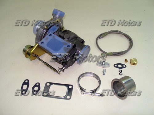

$247-turbo- t3/t4 .48ar compressor (new ebay with garret internals going to save for another bt people say they last)
.60ar turbine
-internal wastegate 8.3psi
-oil inlet line
-fittings/ block adaptor
-vband adaptor and vband downpipe

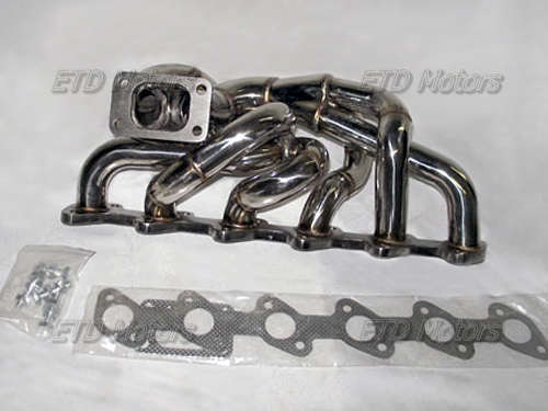

$160- cx racing manifold t3/t4 new stronger style (cxracing.com same as my fmic)
