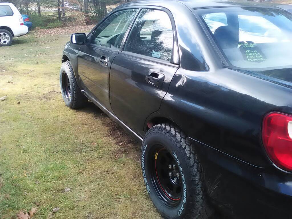

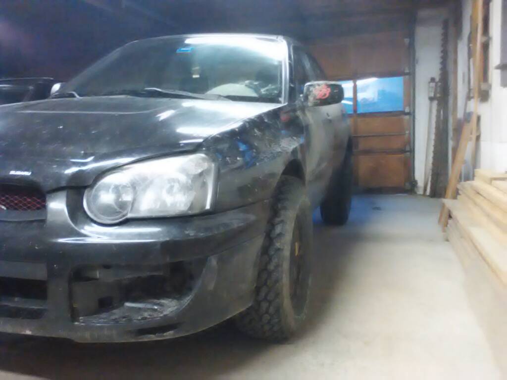

Finally got some Bassett's and new Grabber's. 225/70 on 15x7 +0 pics to come.

Have a few cell phone pics to add for now
The wheels and tires are noticeably heavy. They also did not balance out great and I have some shaking over 30mph but it's manageable lol

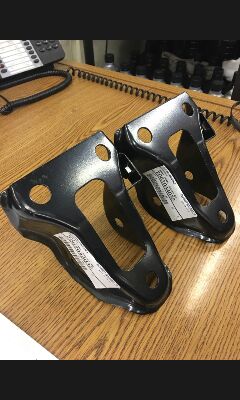

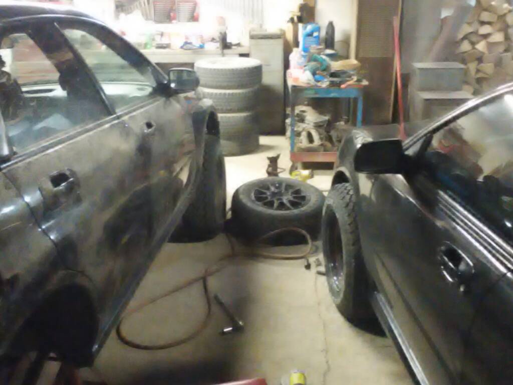

Ordered some outback trailing arm brackets! Got two sets, here's one on the counter at Quirk. I buy all my oem parts through Travis, he's quite a helpful guy! The second set is for my buddy's WRX, there's a pic of it with one of my Bassett's somewhere in those above. I'm saving my set until I can get new struts and more lift parts in a few months since I already trimmed my rockers to fit they're not necessary yet. The WRX is getting Foz struts to go along with his King WRX lift springs(which I believe are just standard height foz) and he's trying not to trim anything for now so I jumped on buying the spacers for both of us!

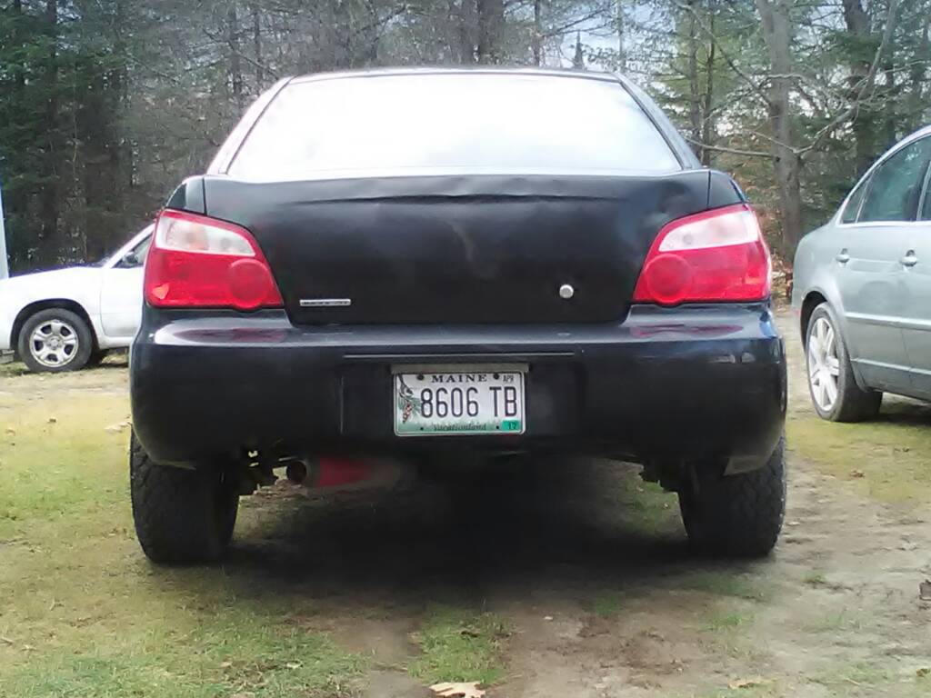

Been pulled over twice in the past week, both times for loud exhaust and tires sticking out. Gonna try and find some cheap flares and weld a muffler on

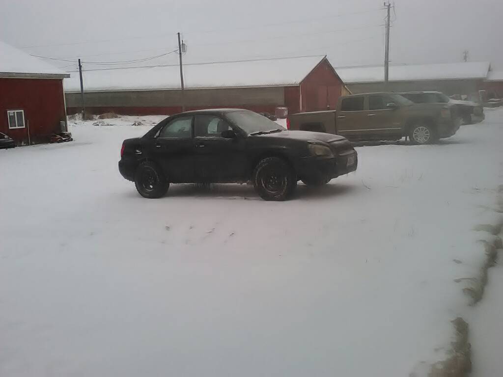

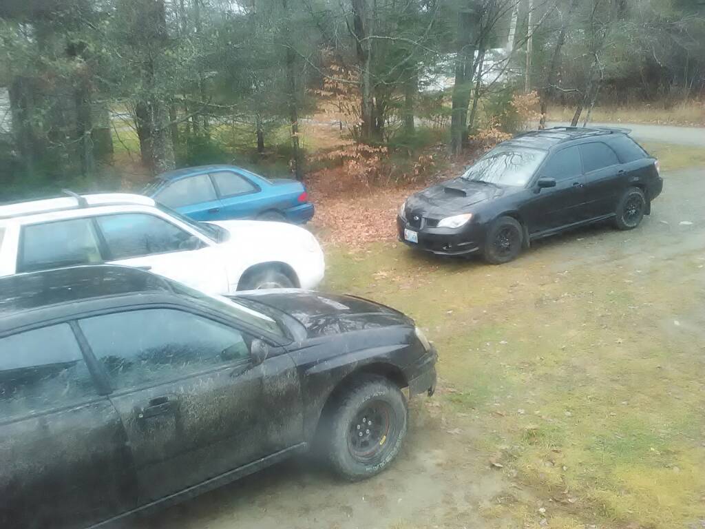

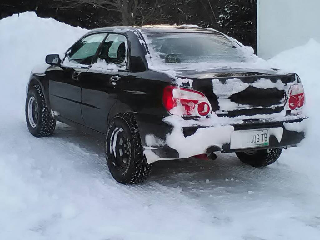

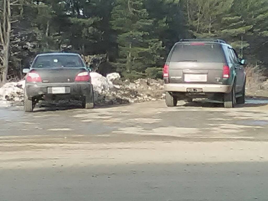

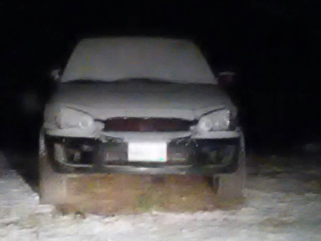

Few random pics from the winter!!

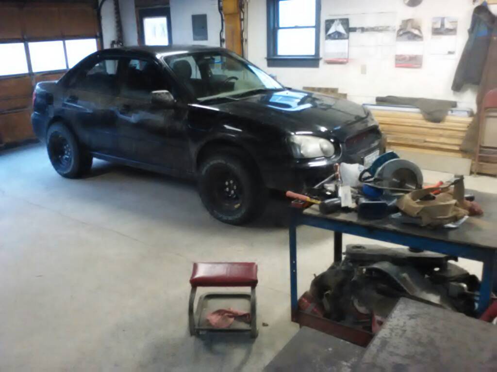

Thinking of the old girl today since the transmission seized up on me a couple weeks ago. I'm ready for the driveway to dry up so I can get to work!
