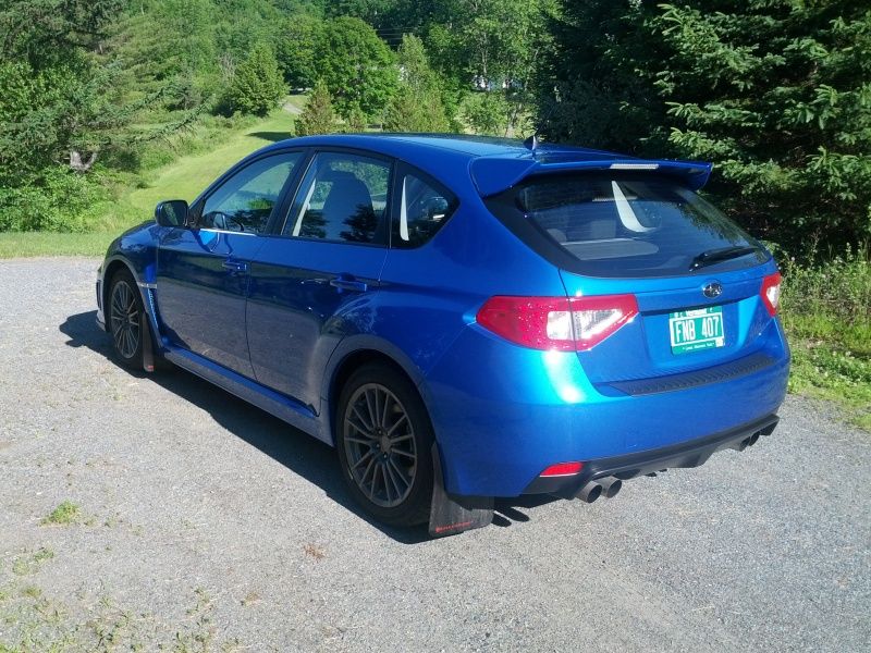

Few pics below.
Little to no mods at the moment. Stg1 and some minor interior/exterior mods.

Cheers! sorry for crappy cell pics
yes, i'll be rockin VT plates until reg ends next year
Welcome. I grew up in Alna, the next town to the south of whitefield. Where in whitefield are you? I'm right in Jefferson now. Car looks great!

Welcome to the club. Car looks awesome. Boost leak is unfortunate. If you don't mind traveling I'd always suggest Mikeymeyagi on here. One of the best technicians i know.
This. He's great. Knows his stuff and is extremely reasonable in price.Welcome aboard btw. Nice ride. Get some Lobster plates when reg is up... It will look good with the WRB!
