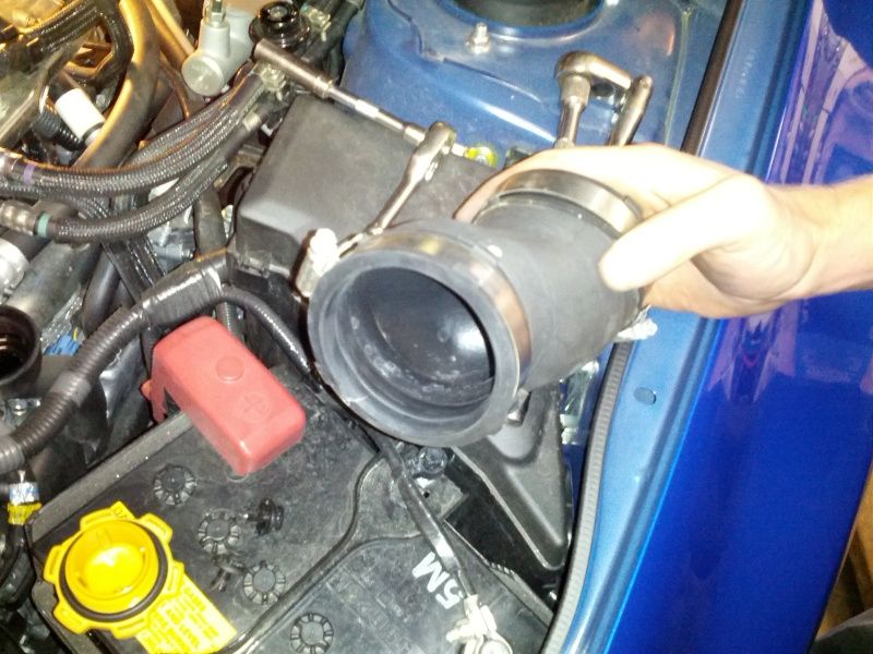

Fixed!!! Saw Mike and we quickly confirmed a leak. As soon as we took the tmic off, the culprit was found!
It was the hose between TB and TMIC!
. The inner lip had "lifted" creating a leak and causing the issues.
Hitting 15.5-16psi beak boost and no more "woosh" sounds!! Yeah to Mike & to an easy fix!
Congrats! Glad it was an easy fix. Too bad the dealership couldn't have taken the few minutes.
Many peeps had suggested this may be the problem, I just did not feel comfortable doing/troubleshooting it on my own!
I also agree that if the tech, at dealer, had actually taken the 10 minutes it takes (not even) to take the TMIC off, he would have spotted it. Not that I am defending him, but I maybe he doesn't work on that many GR's and certainly doesn't have the tuning experience. On the other hand, an argument could be made that the least he could have done as a tech is to inspect the hoses under the tmic, and not just check the visual hoses in the engine bay...
I will make sure to tell him of the issues as a FYI, not that it's gonna make any difference, and i'll TRY to not be an ass about it (I am feeling a bit frustrated/pissed).
