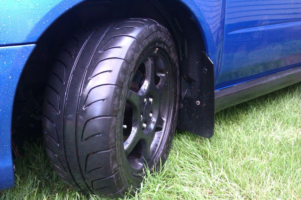

Car is back in 100% perfect order! I drove it a lot today and it pulls nice and sticks to the road like glue with the new tires. so incredibly nice to have my car back!
Think it needs some lows now however....
Saw it today. Looks great. I think I saw you last night on rte 4, also. I waved, but didn't know who it was at the time. Figured that out this morning on my way to work.
