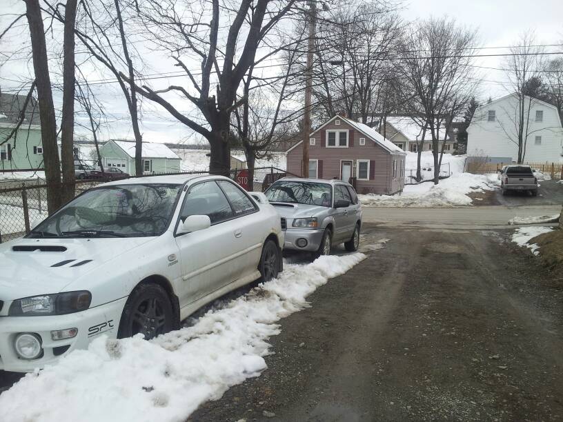

Snowball!!
Sent from my SCH-R760 using Tapatalk 2
Im guessing snowball's feeling a little neglected and betrayed :-)
This one's getting parked at the garage tomorrow for about 2 more weeks, during which time, I'll be swapping parts from the RS to this.  Sway bar, endlinks, Coilovers, Pitch Stop, The new Perrin Motor mounts (Already installed the tranny mount), HID's, Hella Horns, Driving Lights, stereo etc...Then snowball can go to another new loving home with a big static lift!
