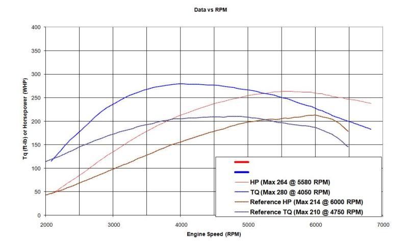

With cars that can run on the stock ecu mapping without blowing up - we do overlays
Here's a stock 2010 WRX with the stock map VS. my tuned map, same day within 2 minutes of each other.

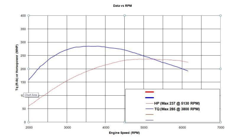

Graph from the day of the tune:
Will post an updated graph after I run another 3rd gear log. It's super fun to drive! Torque hits early and hard!
^^Nice curve.. But good God the TD04 runs out of breath fast. Turns into an over sized hair dryer.

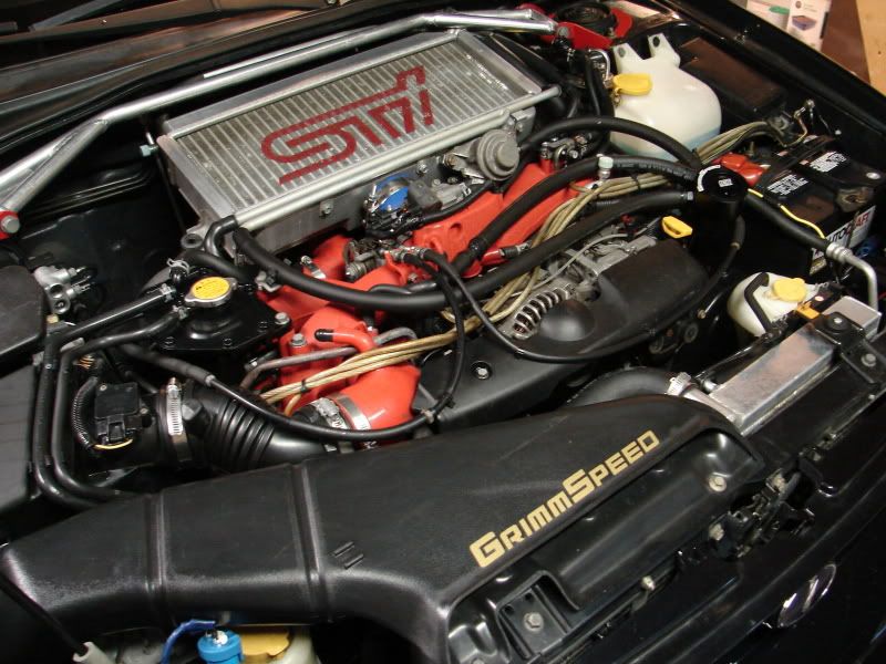

GrimmSpeed AOS and Group-N Motor and Transmission mounts went in this week. Also did a compression test at Lobstah's and showing 185's across the board. So far so good.
Awesome!! Good to hear it's goin strong!!! You notice a big difference with the motor and tranny mounts?
Very solid feeling. No more engine vibration on start up/shut down. Definitely makes a difference. My 126k mile stock mounts needed to be changed anyway!
