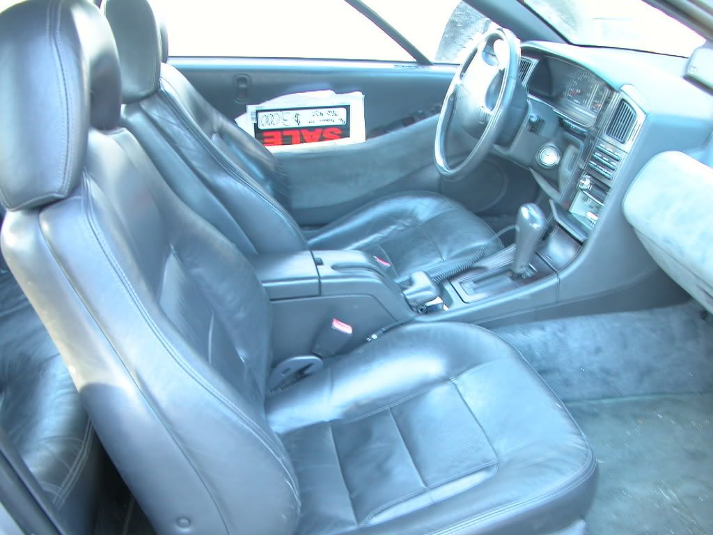

Ashley was looking at an SVX for sale but it needs a tranny ...

This is what the owner told me about the car ----- it is actually the front differential that is gone and somepthing with the selenoid c which the differential is in the front of the tranny and the selenoid is in the back so u prob could get the tranny fixed cause it shifted great and i was told when i got it that he had already put a tranny in it so it would be up to you on what you wanted to do get taht one looked at or just get a new tranny

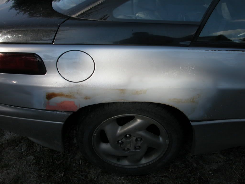

if they want as much as i think they want for that with a blown tranny and what looks like a badly patched pannel... just walk away.
there are way better cars out there for less.
