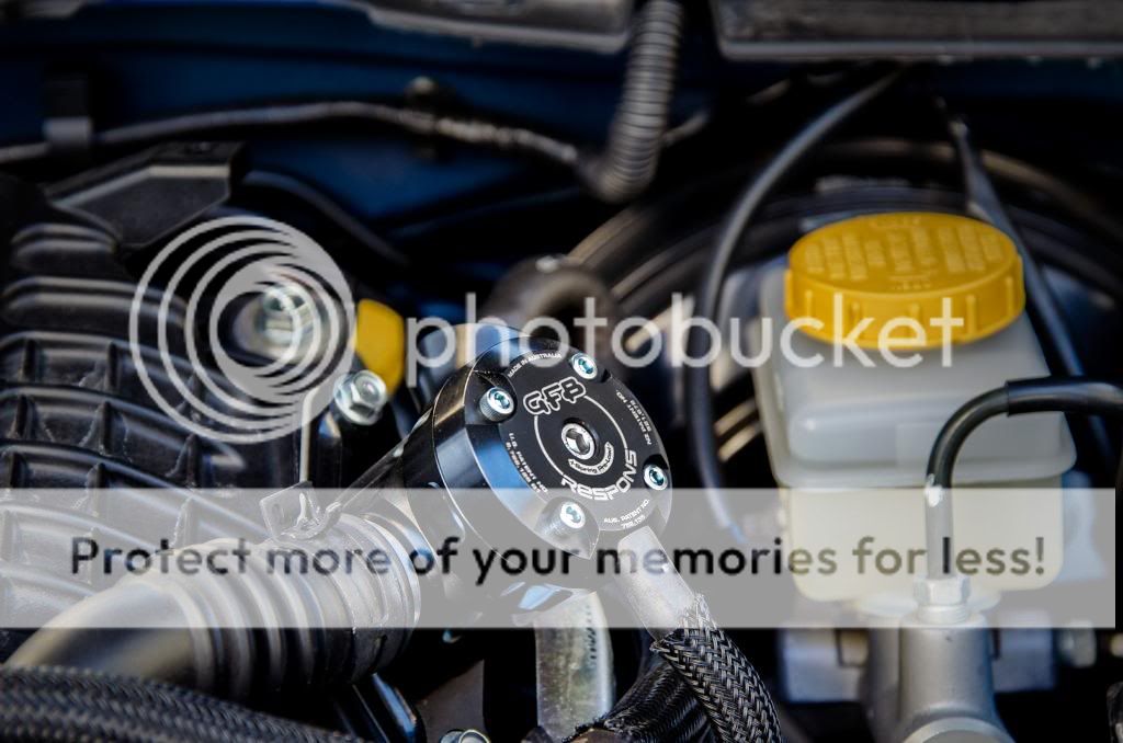

GFB Hybrid BOV - Set VTA: ~25% / Recirc:~75% - I've always run TIAL BOV's in the past, but I liked the stock fitment option, plus I have a feeling I may be going back to full recirc...

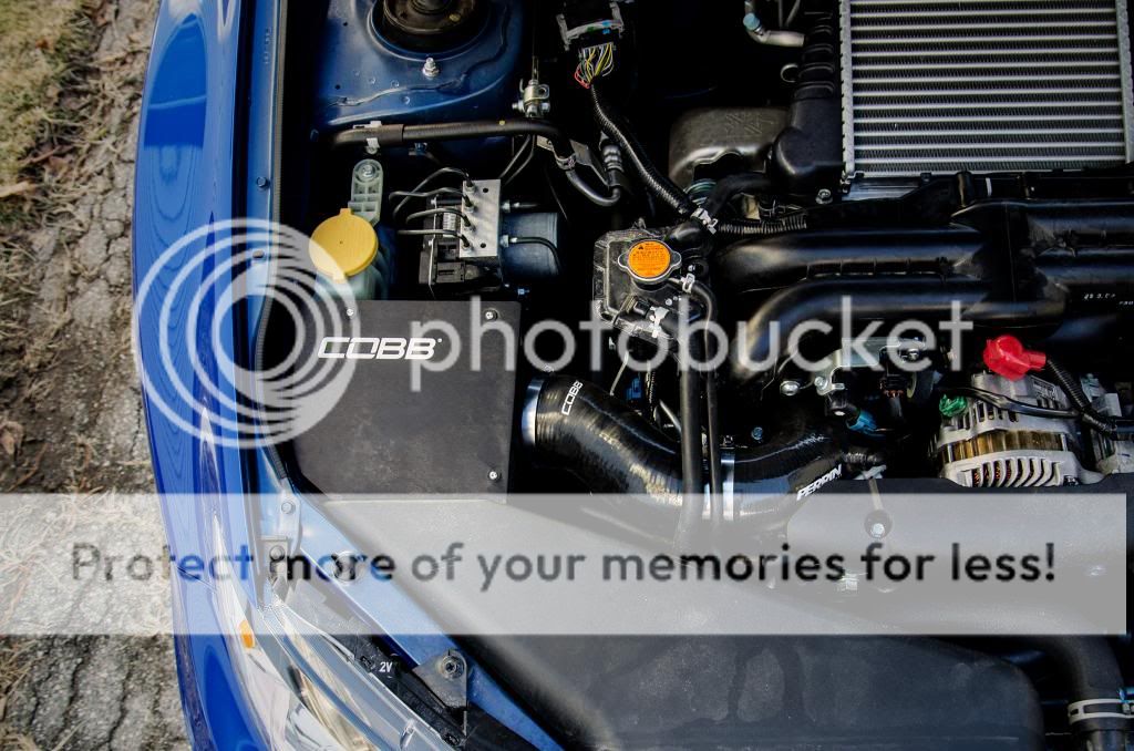

Perrin Turbo Inlet Hose (Dont know why some people say this takes 3+hrs to install. I had prepared myself for a big job, and was pleasantly surprised by how long it took)

how do you like the GFB valve? can you still hear it at 25/75?
Yeah, I can definitely hear it still, although its not quite as distinct as a 100% VTA Setup. I tried it at 50% VTA and the car would intermitenty stall  when coming to a stop. I'm sure that by spending more time adjusting the preload on the spring, I could run closer to 50% VTA, but as its freezing cold, and I just wanted to drive home, I set it closer to the 25/75. Honestly, atleast from inside the car. I could not tell an audible difference between 50/50 and 25/75.

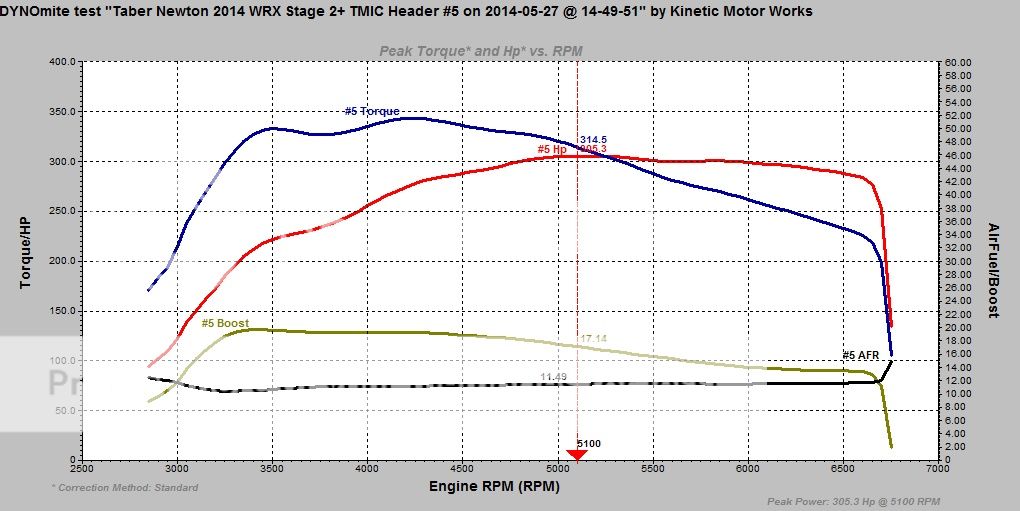

So I made it down to Kinetic Motor Works Today:
Car feels good. I'm pleased with the power for a stock turbo. They use a Land and Sea Dyno
