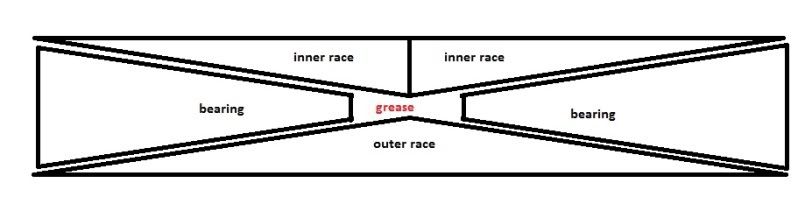

they dual taper bearings. Kind of like this::
This would just be for the bottom half. The hub would be below this and then the axle above this. Then invert that and you'll get the top.
So you're changing your tune on how tight the bearing should be?
Took me a sec to understand that pic, but yes. That would be a longitudinal cutaway.
Since the force of the axle and hub are applied to the inner race, the preload on the bearing will never change no matter how much force you put on it.
Assuming no deformation in the metal, you could put an infinite amount of torque on the axle nut, and it would still have the same preload.
