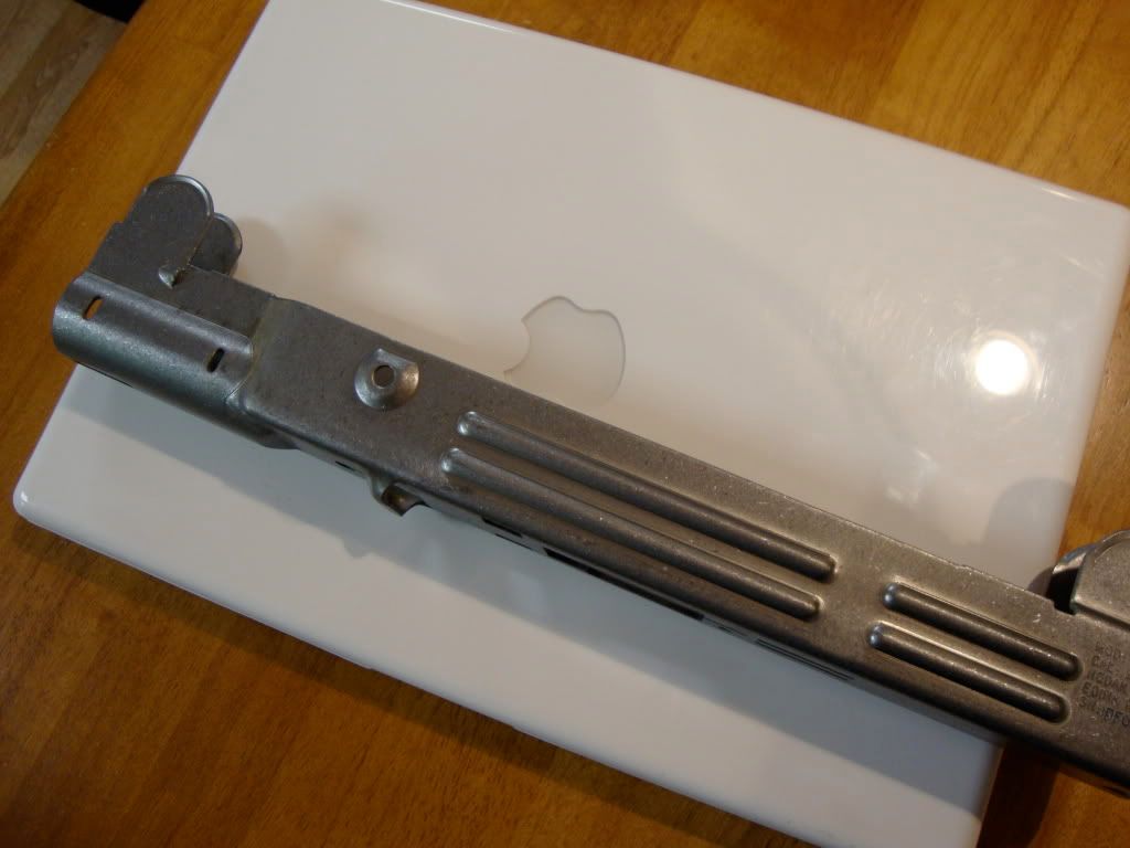

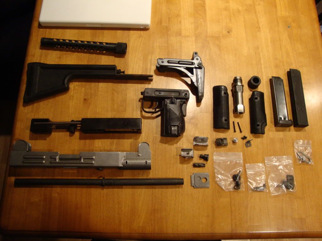

Got my receiver shell... still waiting for the rest of my parts.

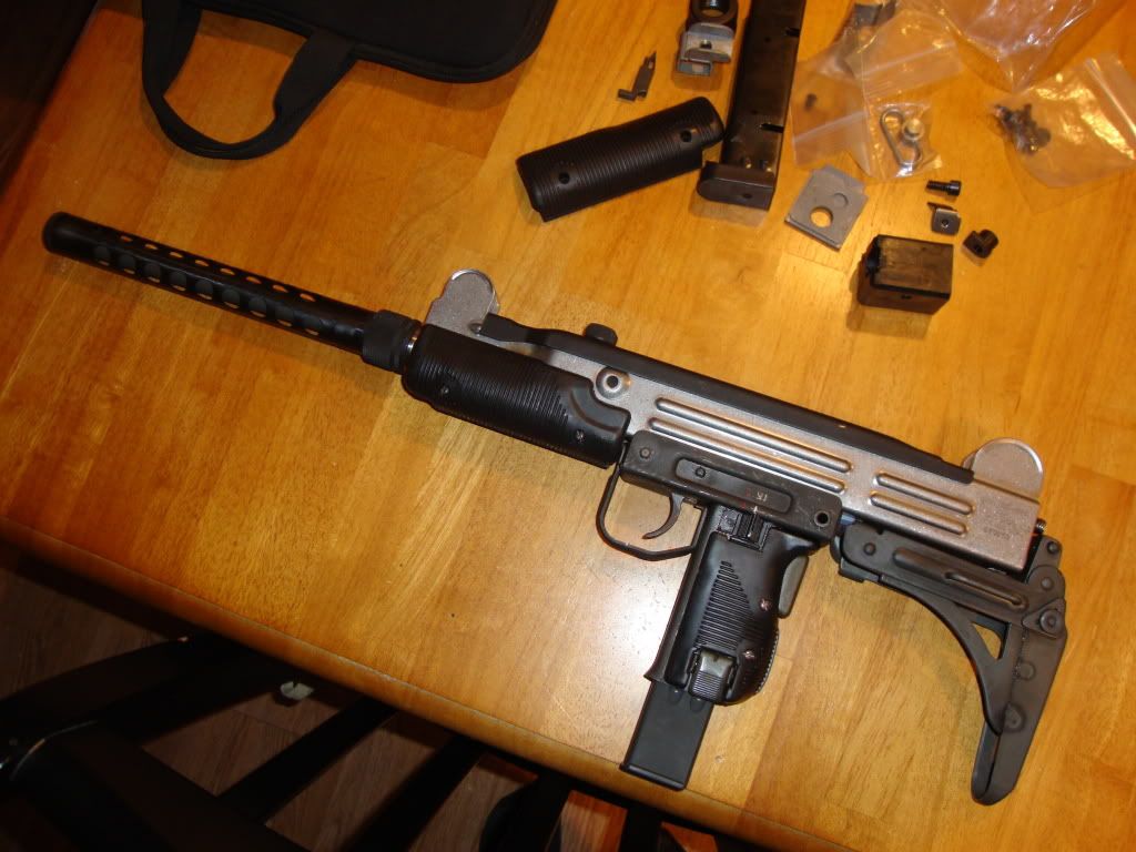

Are you doing a long barrel and sliding stock?
hahaha, ya, theres a lot of holes in it..

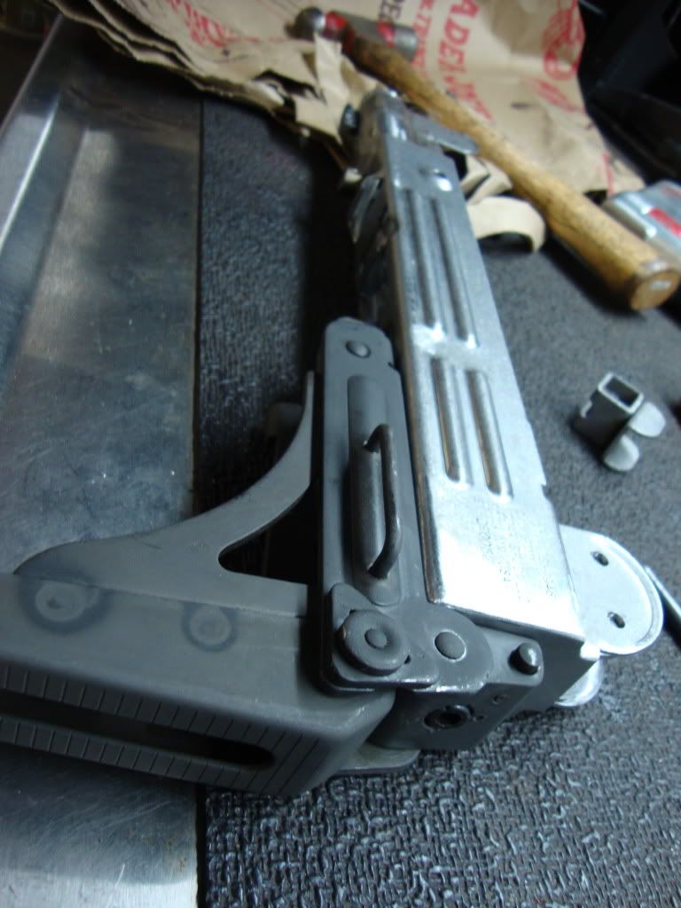

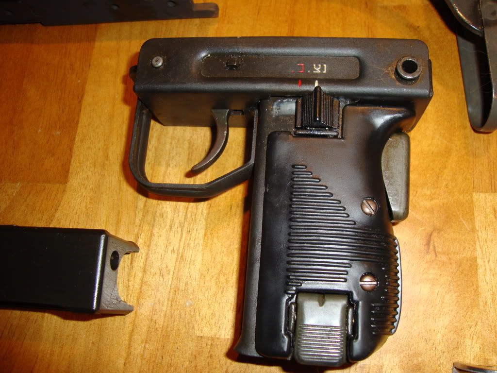

The barrel will be 16", and the stock will be the steel folding type. If you look at the pics near the top, you can see the original stock. Of course it's folded up in the pic, so it doesn't look like much.
I should be getting the rest of my parts tomorrow, at which point the pics will continue

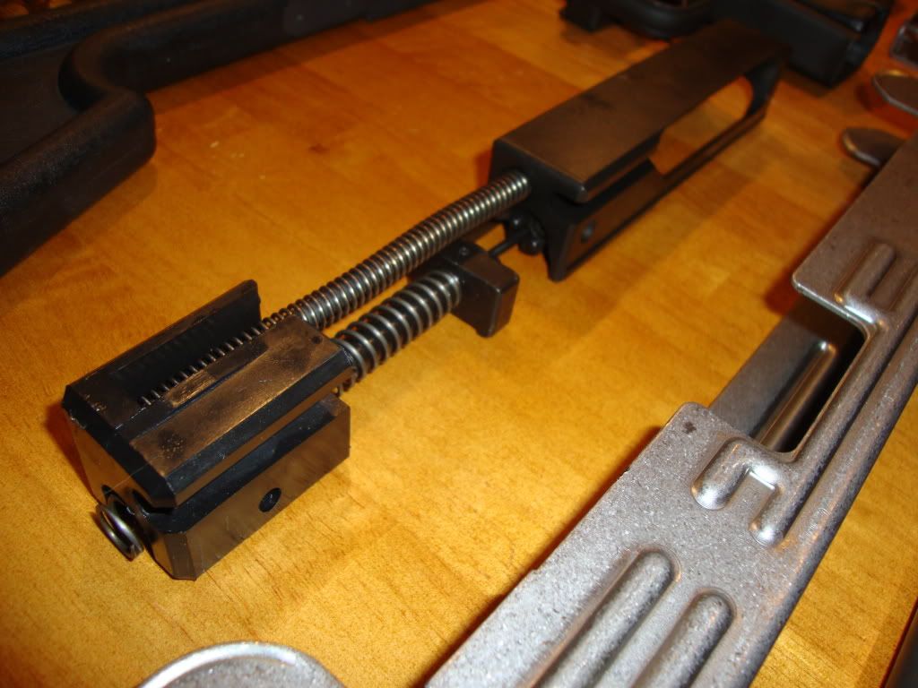

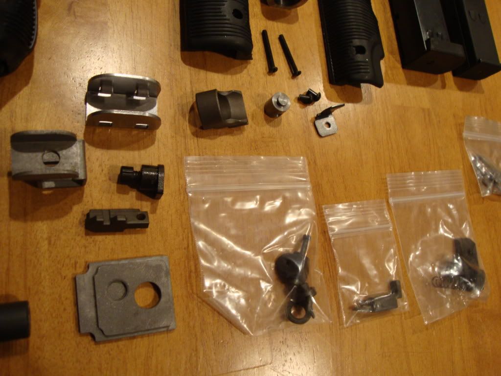

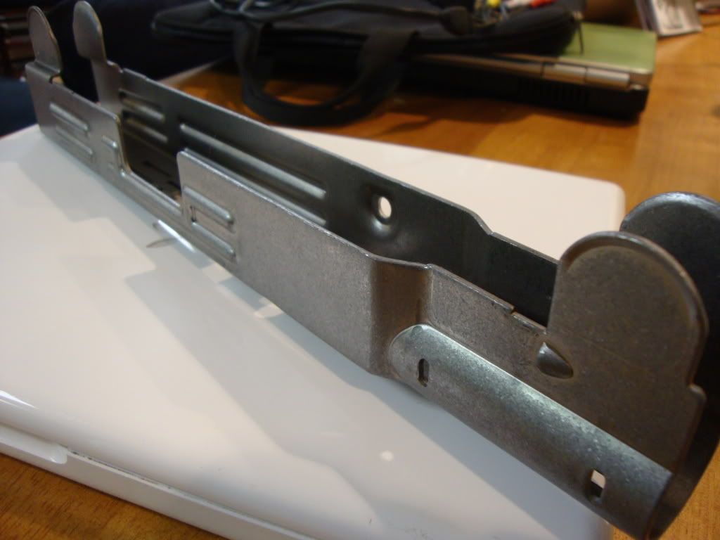

Got 95% of my parts today. Still waiting for a top cover and one part to weld into the shell. I'll post pics when I start mocking it up and welding.
I didn't realize how heavy these are... especially with the 16" barrel. I stuck some of the parts in the receiver and lifted it up and was amazed what it weighed.

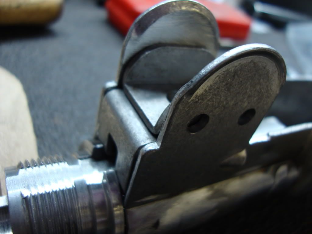

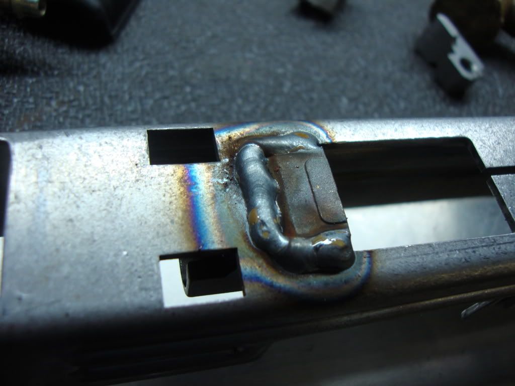

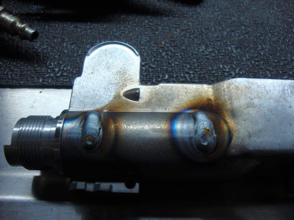

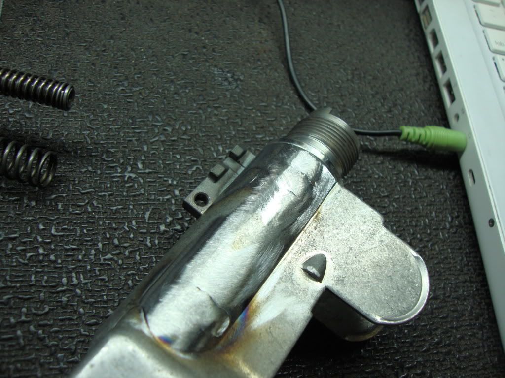

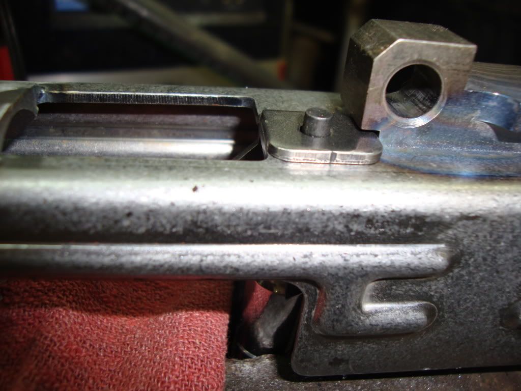

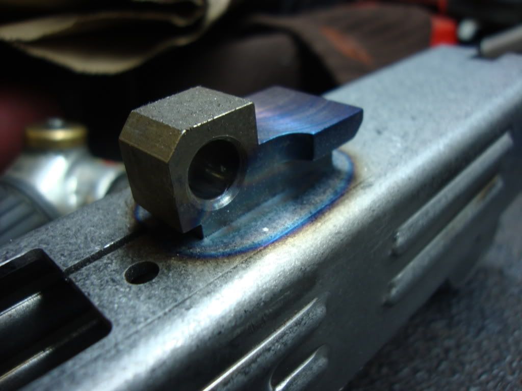

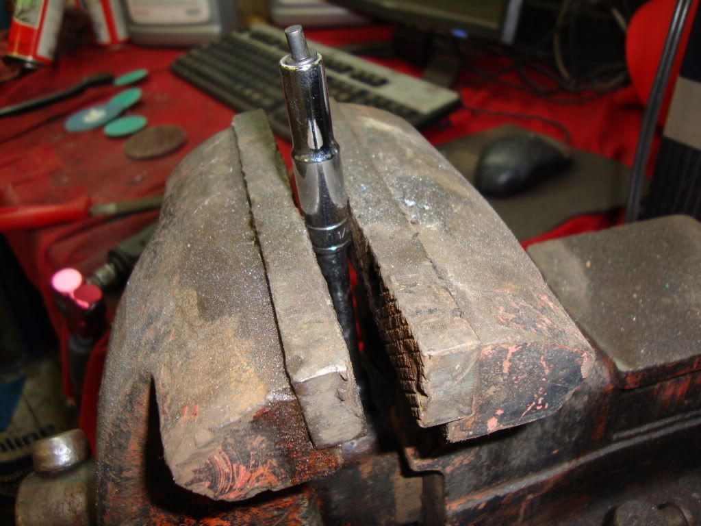

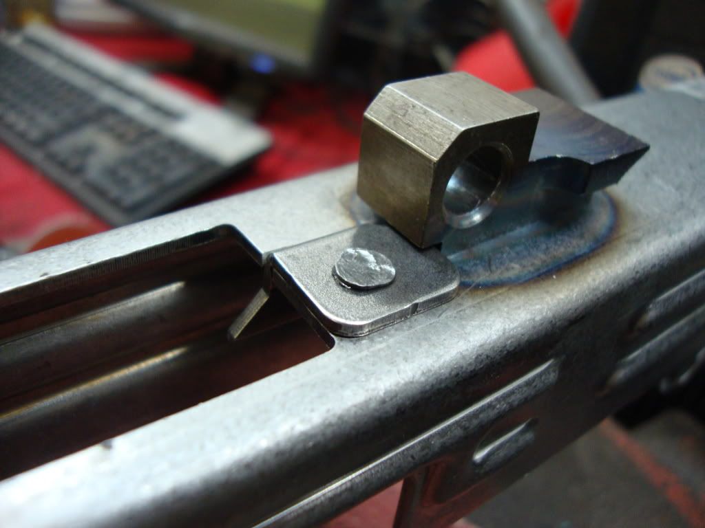

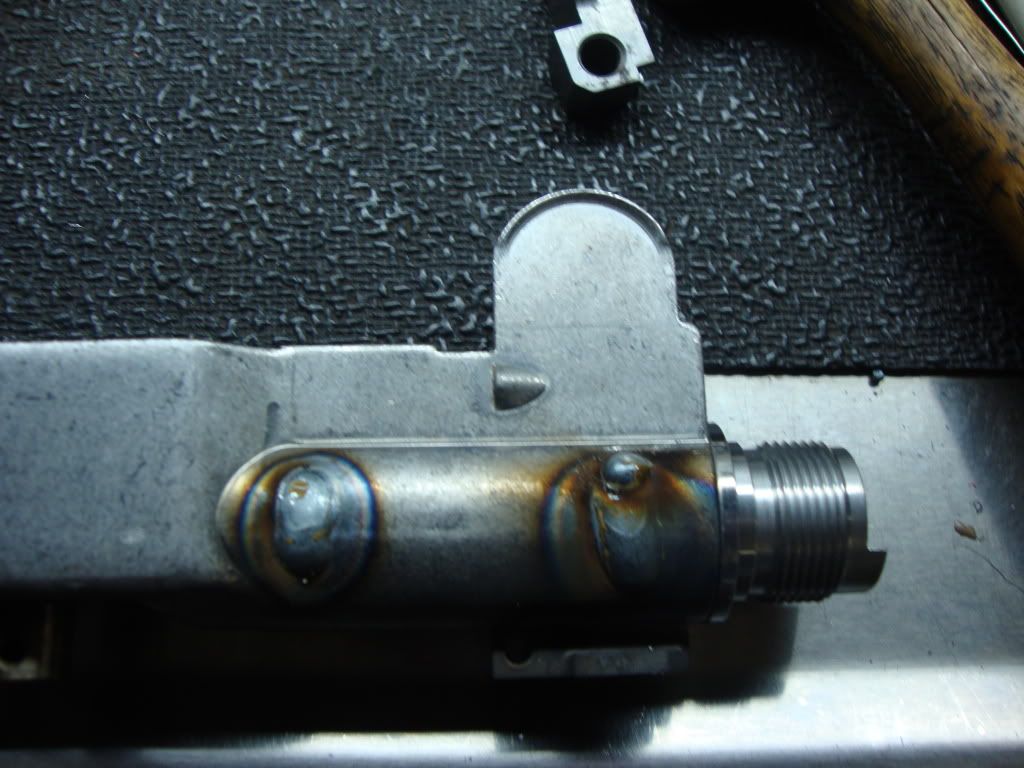

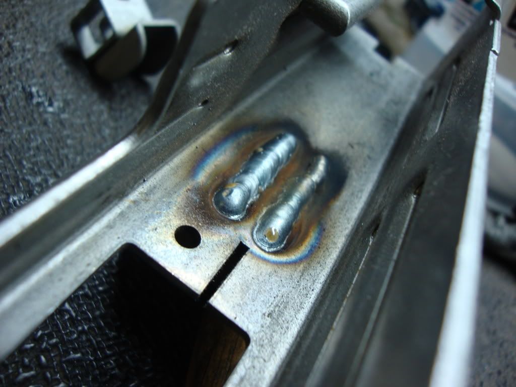

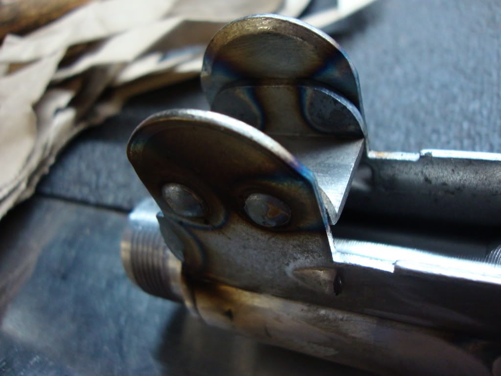

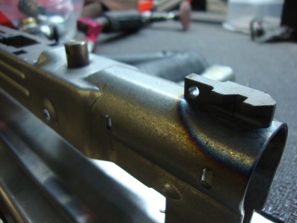

getting ready to weld the bayo lug and grip lug

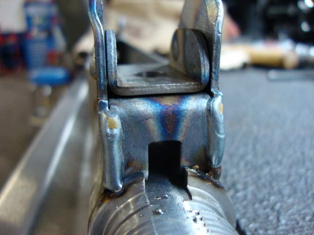

welded, need to grind to fit the trunion in there

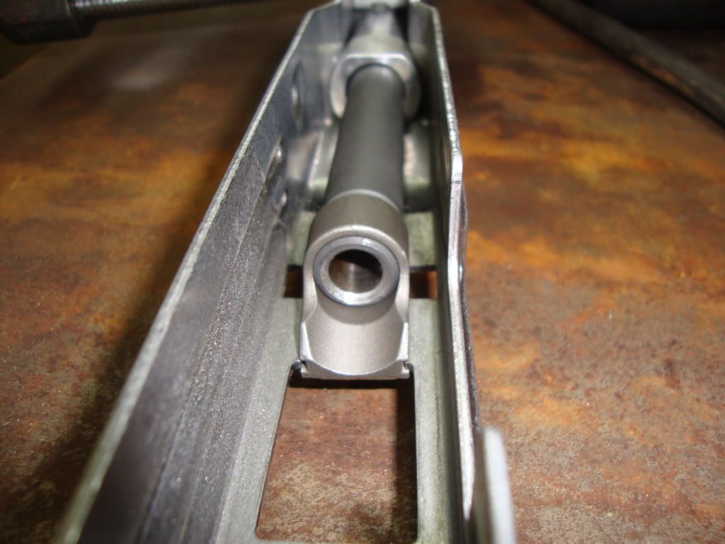

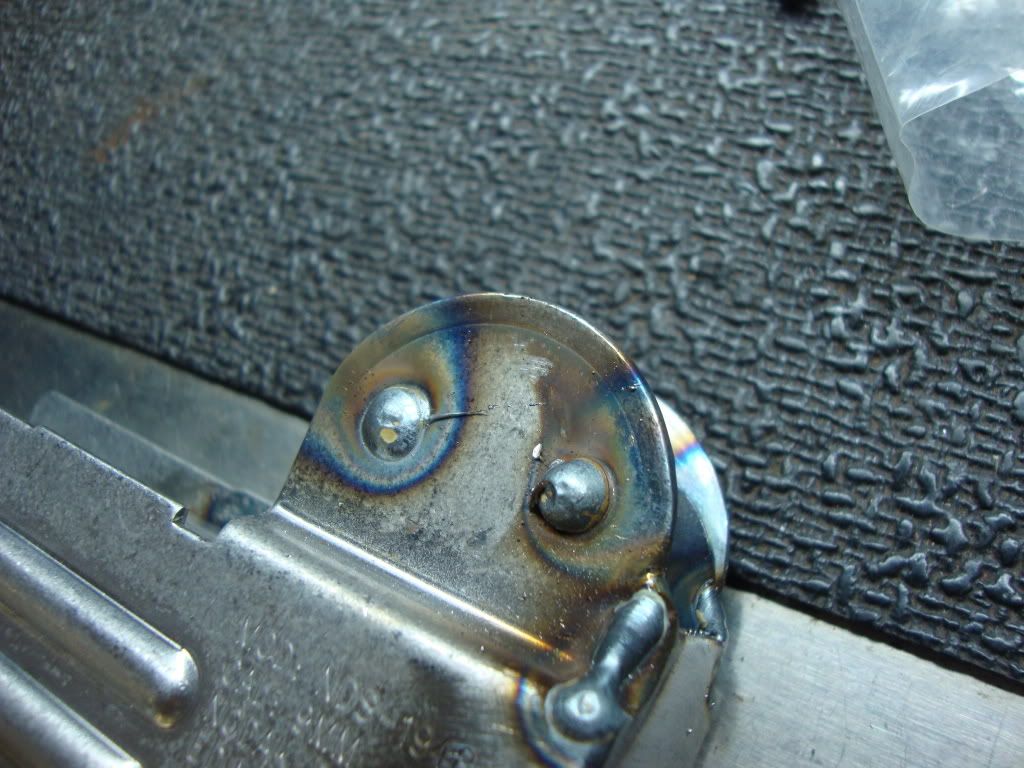

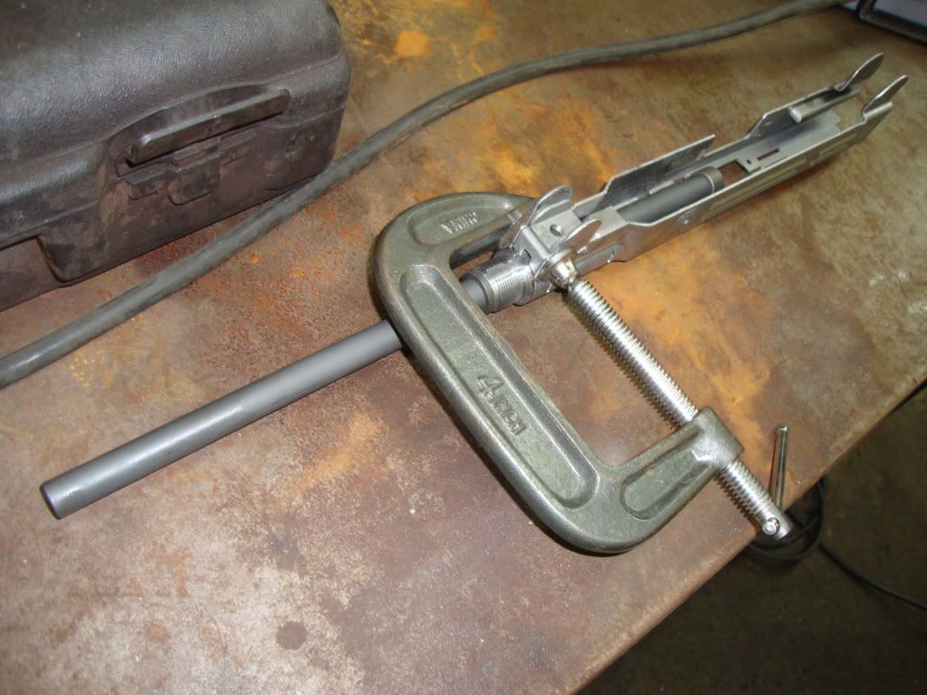

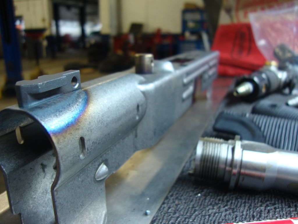

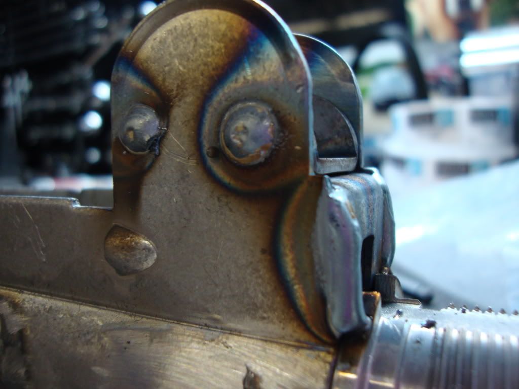

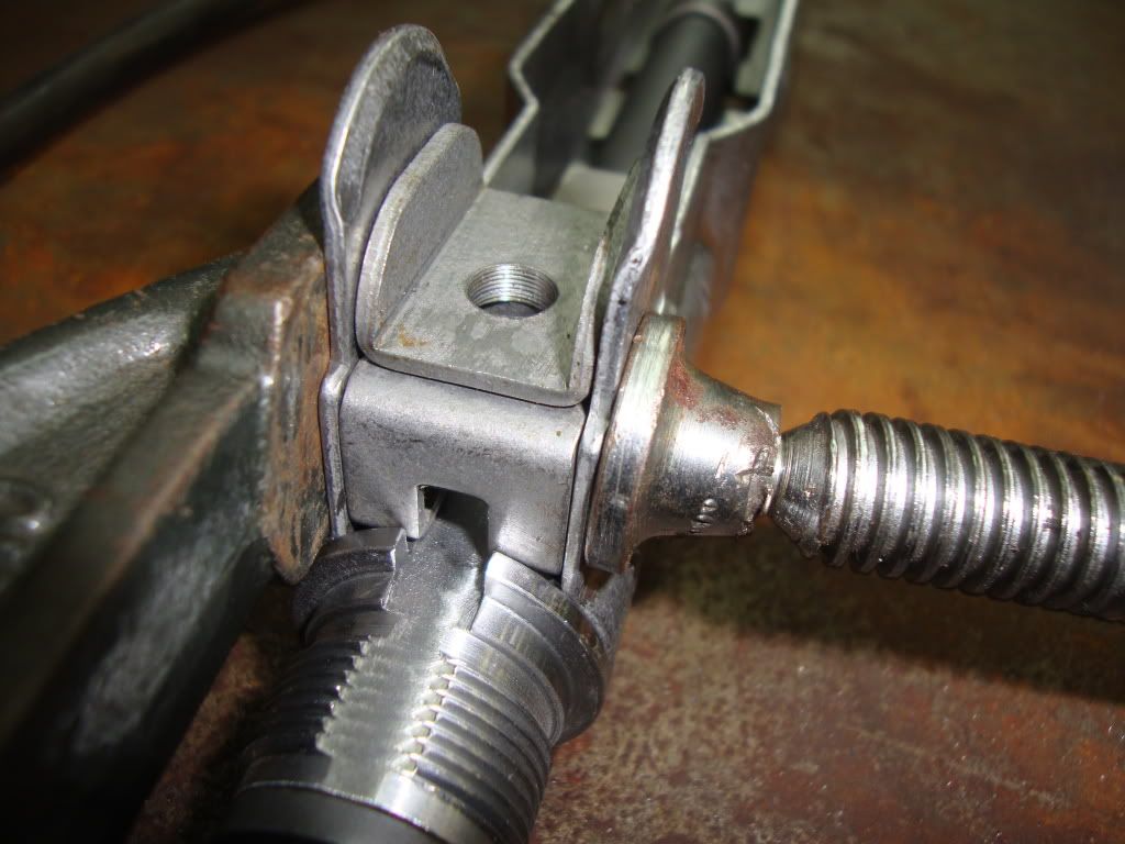

clamped the trunion and checking barrel fitment before welding.

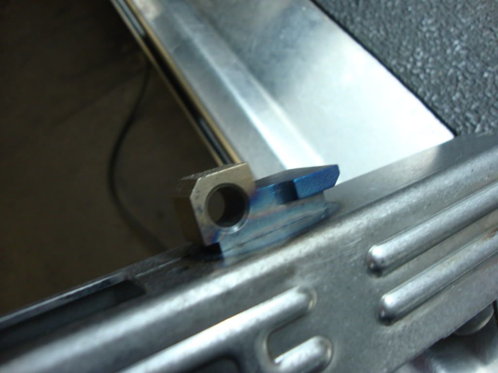

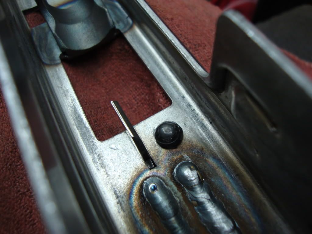

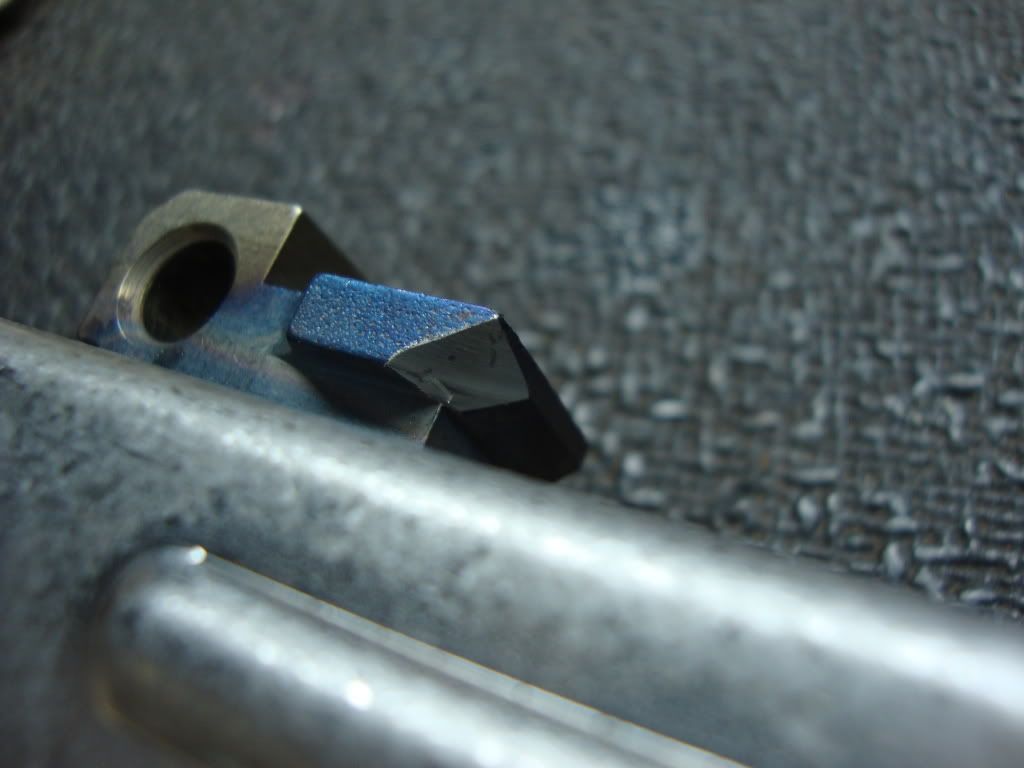

feed ramp in place

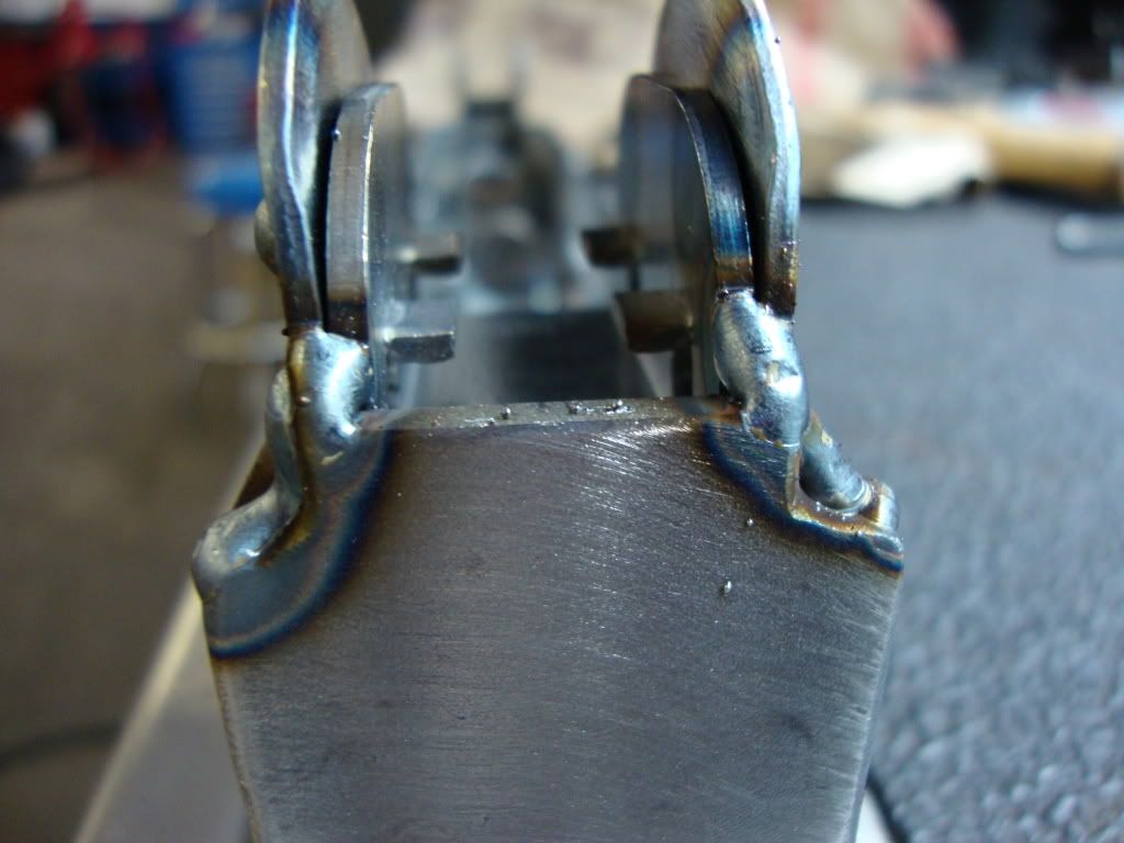

not my best looking welds, but they need to be ground down anyway
feed ramp welded, also needs grinding
grip lug welded

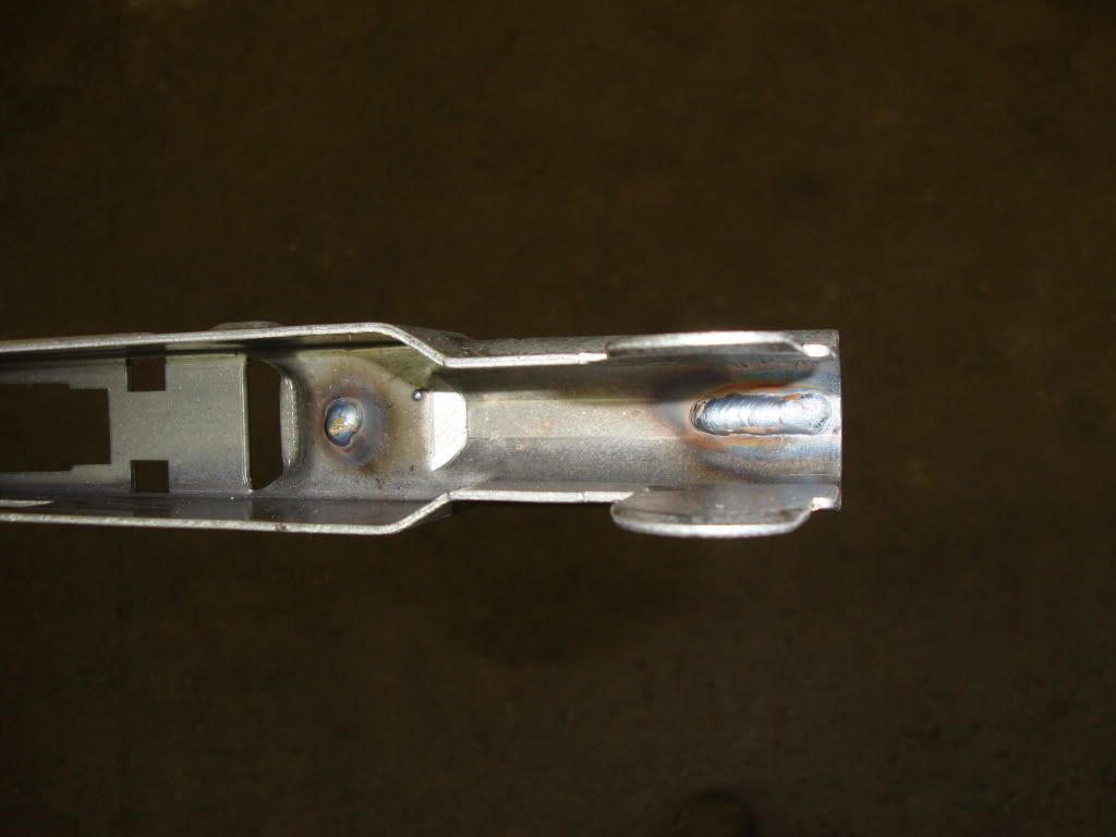

inside
and one more mock... cuz I can't help myself

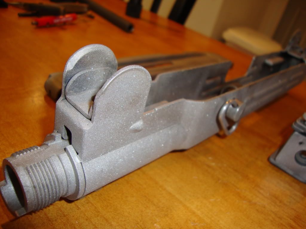

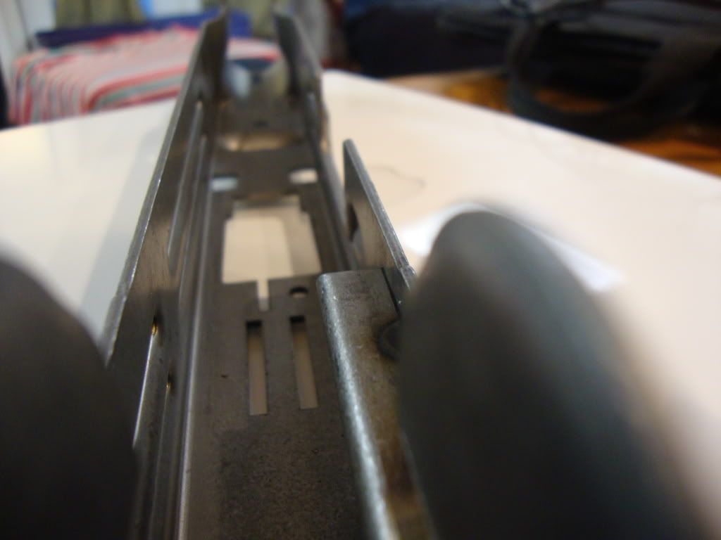

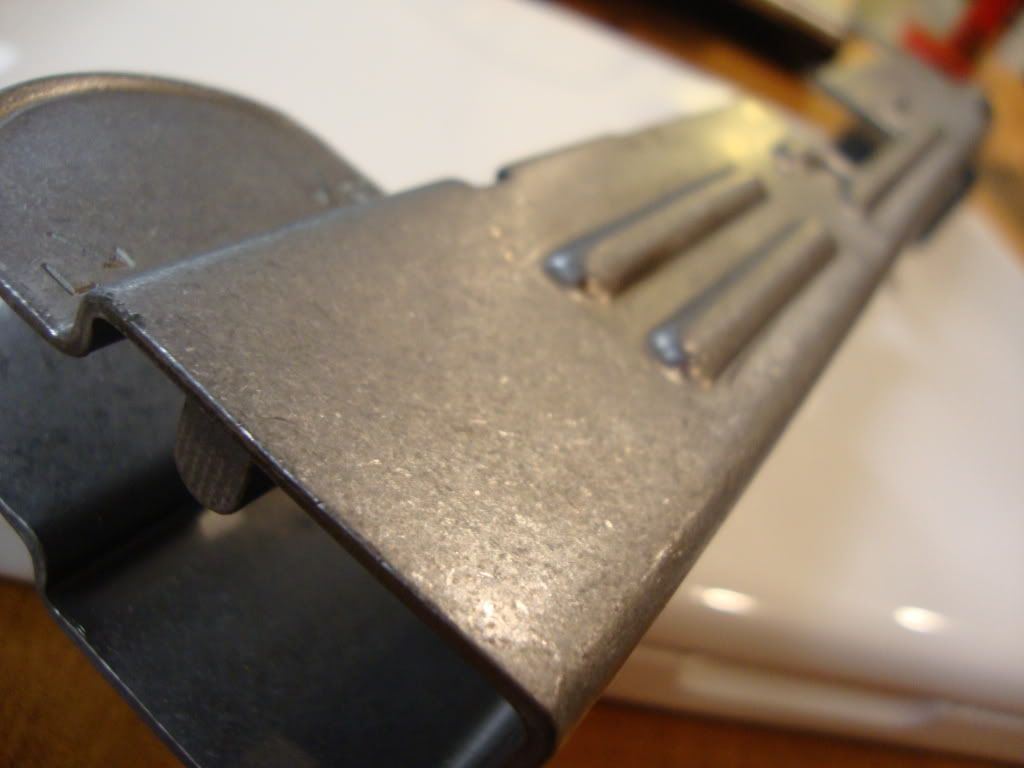

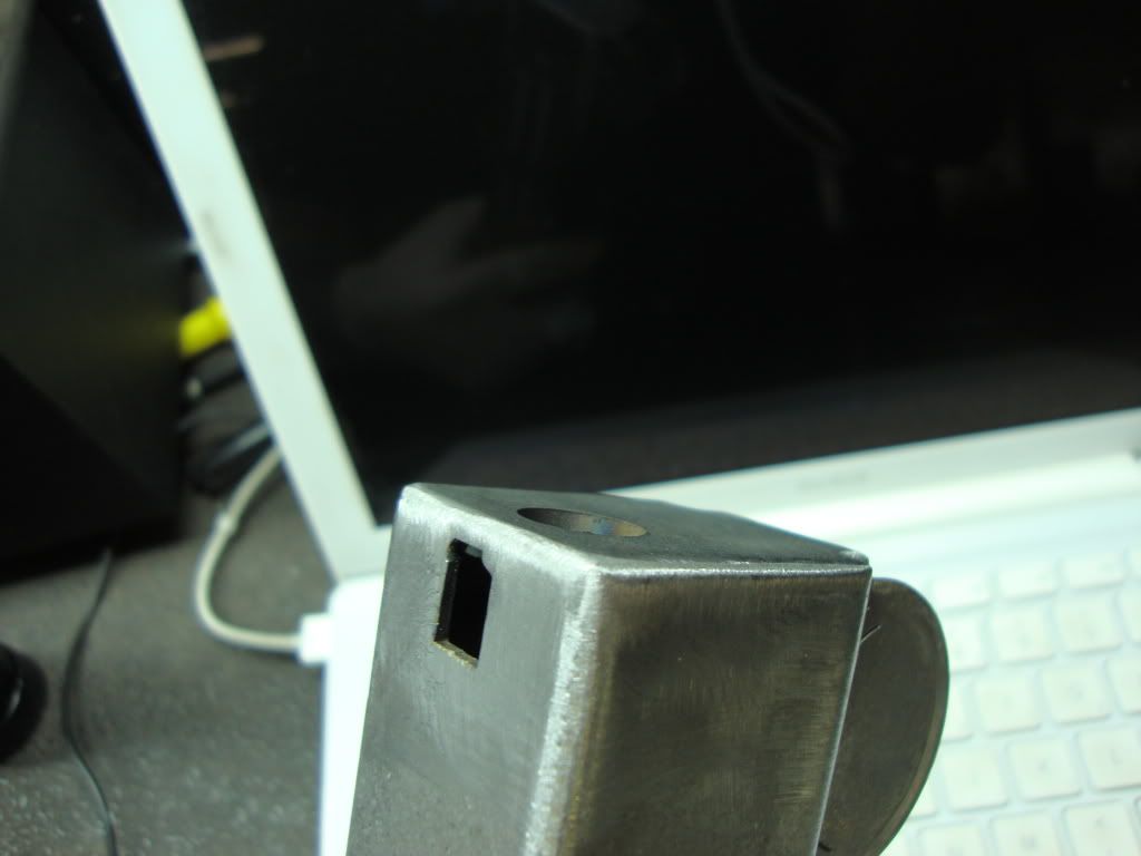

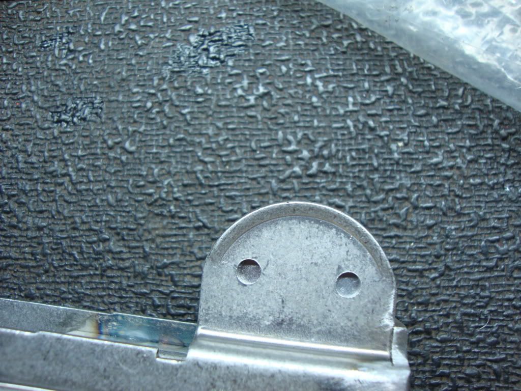

Ran into a snag. The receiver is twisted ever so slightly. It's my fault, as I checked it before welding and it was square. I might give it a quick twist to snap it back.. or might leave it alone. Not sure yet.

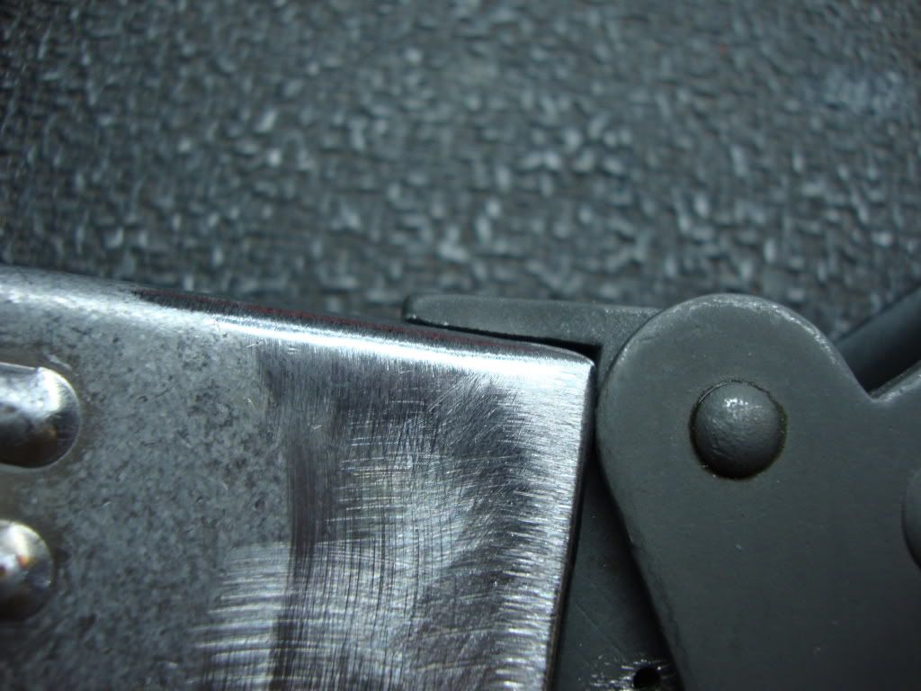

The top cover was not sitting flush. After some messing around, I found it was hitting the sling "bump" in the left side of the receiver. I decided to file the inside lip of the cover rather than modify the shell. It fits good now.
I also realized that I welded the grip frame lug a bit too far back and it is now making the stock not fit against the lug when collapsed. No big deal, as I can file a bit off the stock.. or the lug.

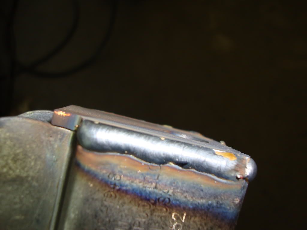

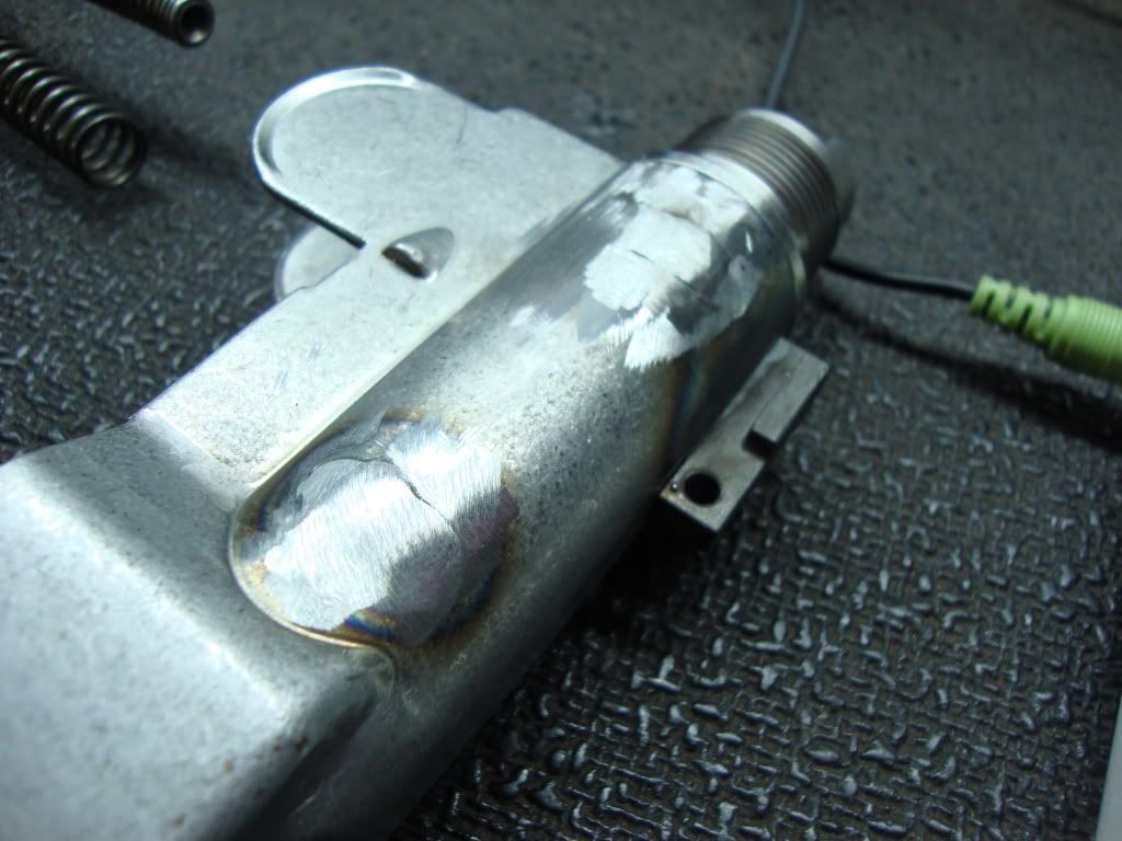

I ground the trunion welds, but not too much.. as it will sacrifice structural integrity.
pics...

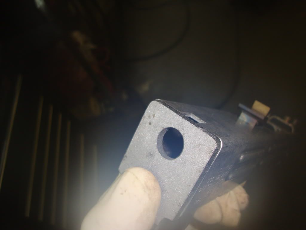

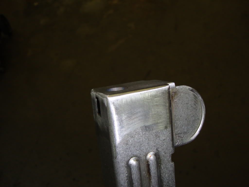

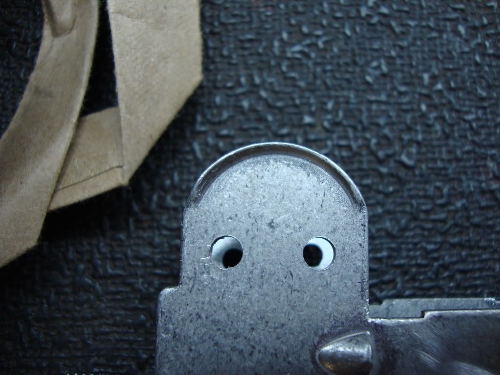

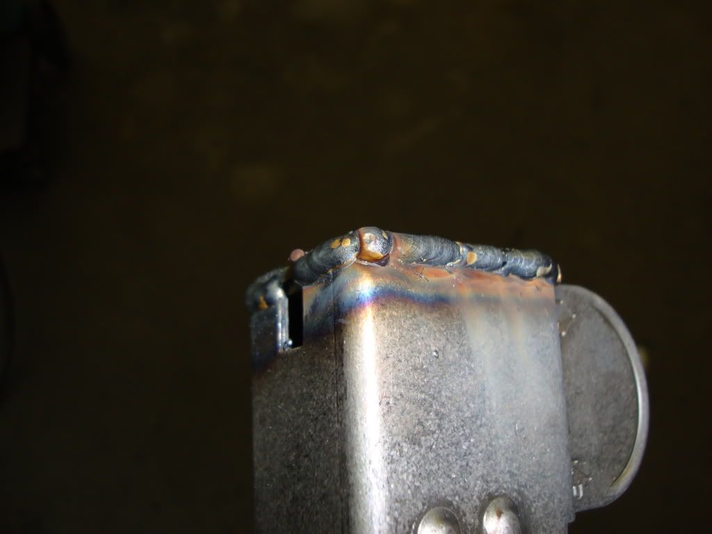

I put a chamfer on the edges of the back plate to give me some room to pile up filler material while welding.
After some grinding and sanding

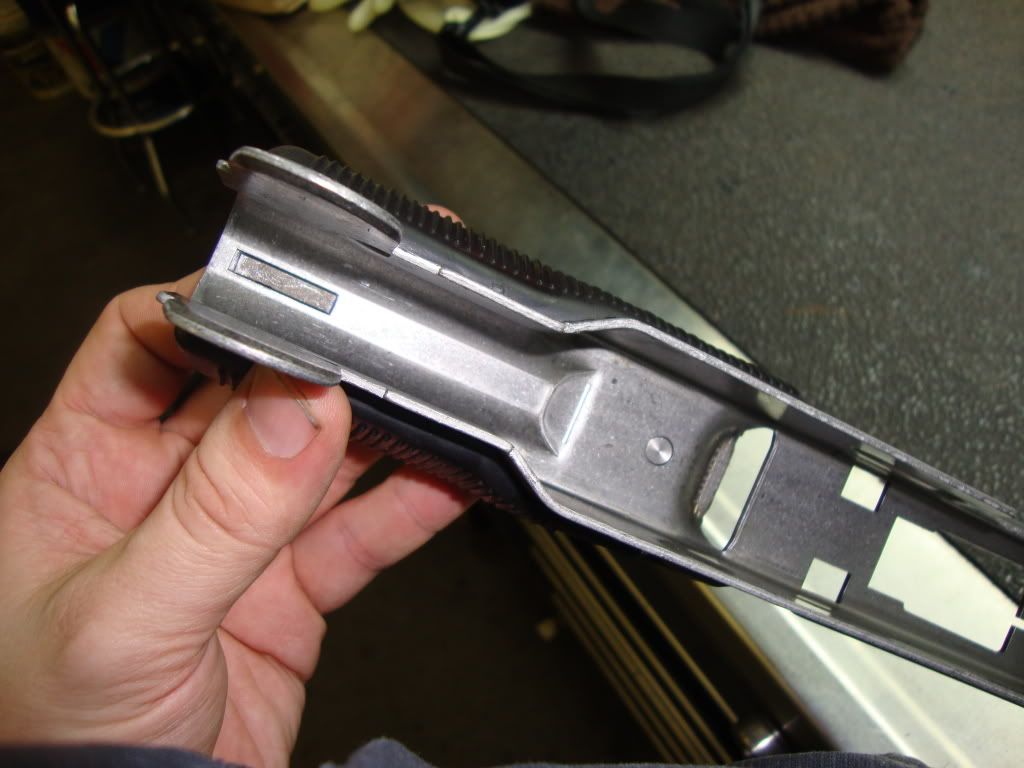

That's it for now. I will try and work on it tomorrow.

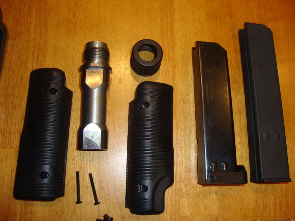

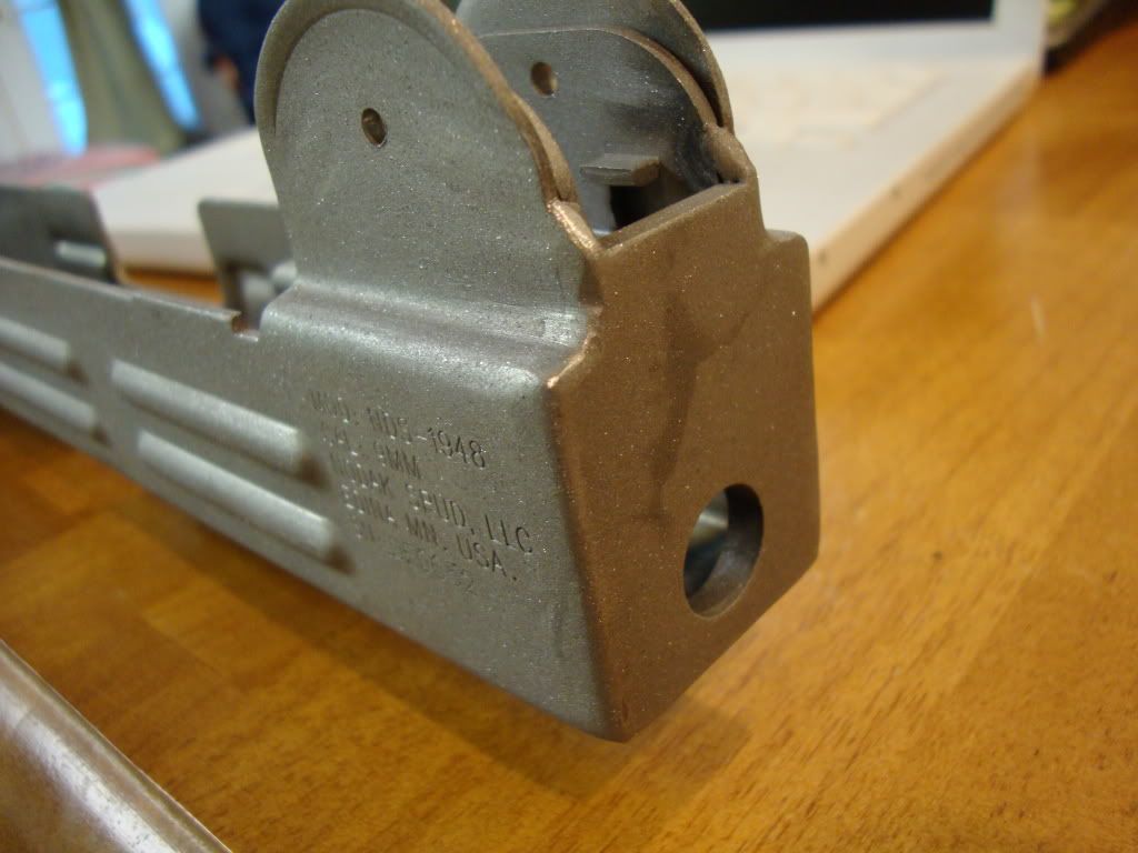

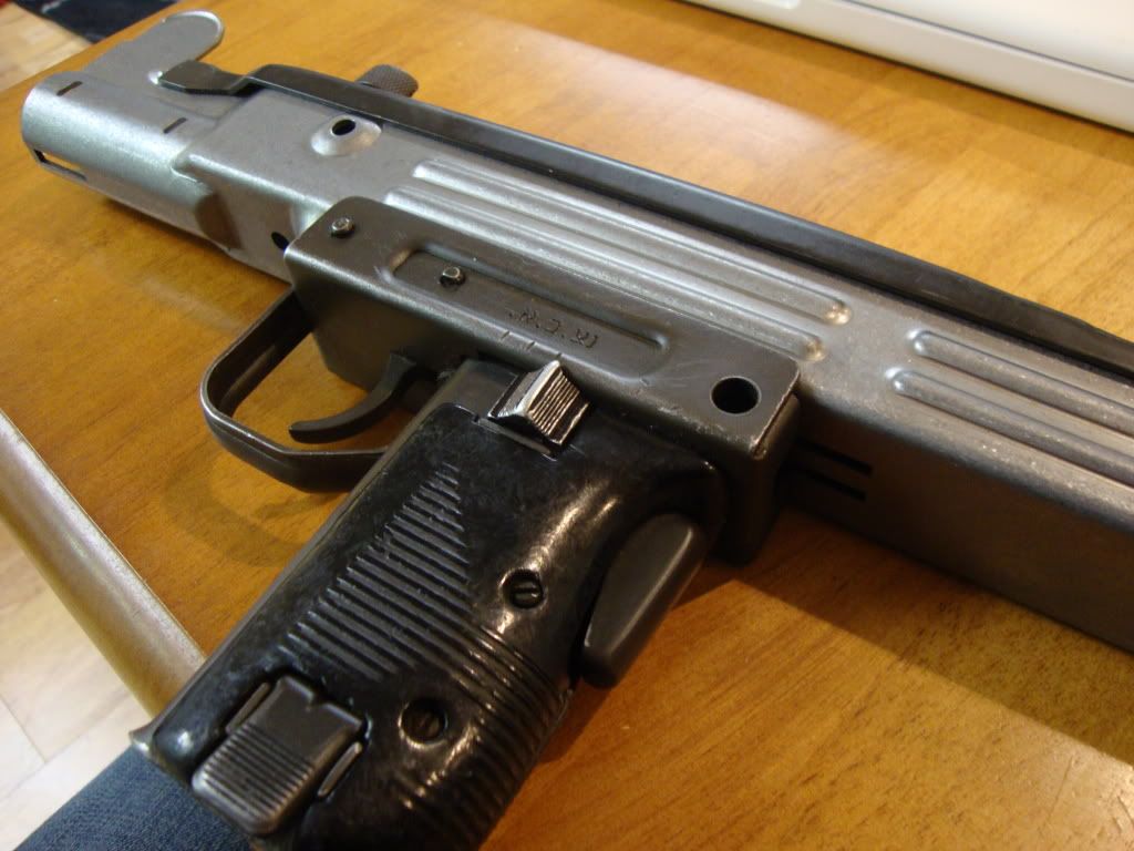

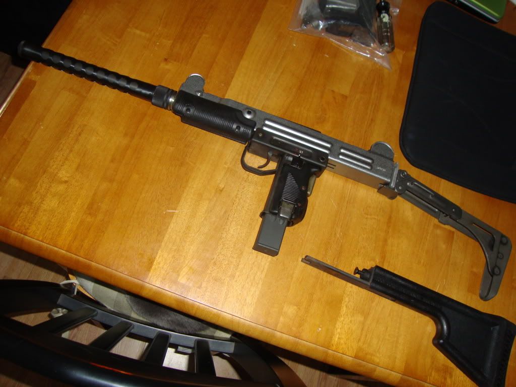

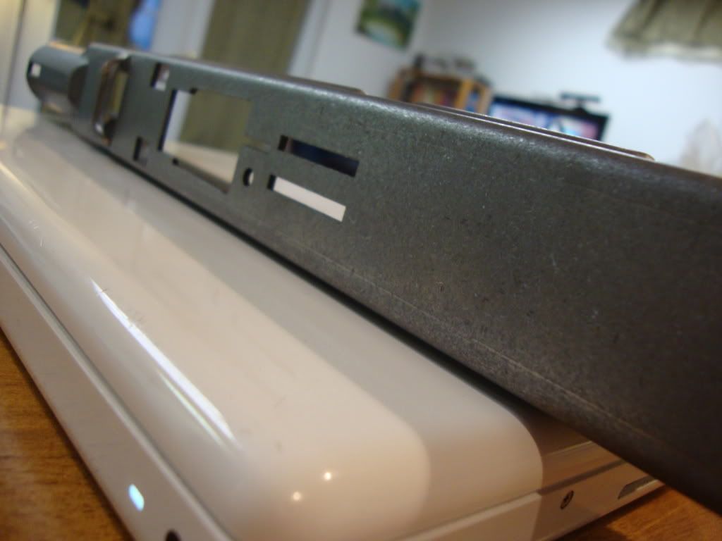

Almost done! Need to strip the lower and refinish it, as well as the barrel shroud.
I used Krylon BBQ paint, works well, but it's a bit shiny. I might strip it and use something else.
