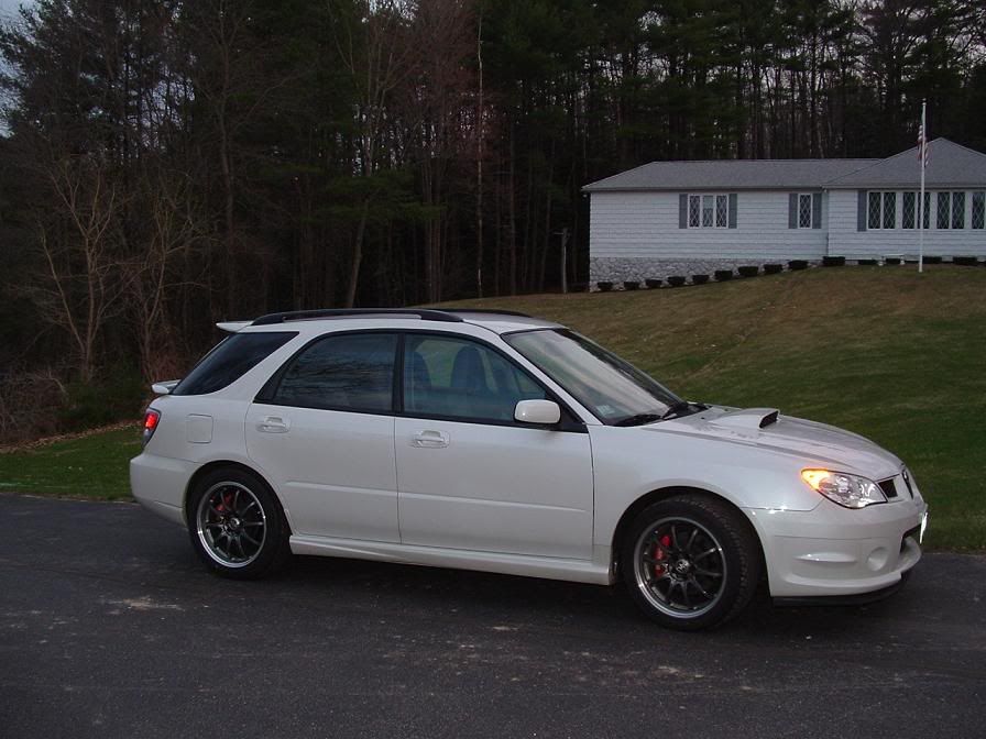

For me i've always preferred the feel of a linear spring to a progressive spring, i think the ride is actually better too. The RCEs ride great, completely usable for DD. I take them off in the winter to gain ride height, but you could even run them year round.
would your pinks fit a wagon?
Subaru makes the STI pinks for the sedan and wagon specifically. The rear springs differ, but you can run the fronts on either a sedan or wagon. The part # for the front pinks are- B2010FE500, for the rear sedan, it is - B2010FE510, and for the rear wagon it is- B2010FE520. They will fit WRXs and the RS/TS as well as 2.5i's in the model years '04-'07. This is a link to subaru of america's SPT site- http://www.subaru.com/subaru-performance-tuning/performance-parts.html#
