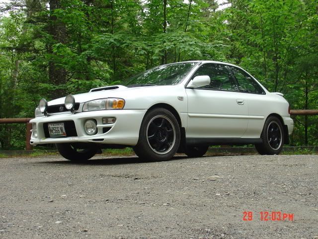

last set of hellas, before the new mount. i also have fogs hooked up under the fog light covers, much cheaper than the $450 kit

oh yeah with out a drought the 6inch hella lights rock! once i traded my old car i gave my 4 to my dad to put on his baja if u haven't noticed. but with the lights on the rack instead of out front they put out so much light!(off maine roads of course:D) and i put in a revirse light for him for thows dark nights backing up with 20%tint:rolleyes:

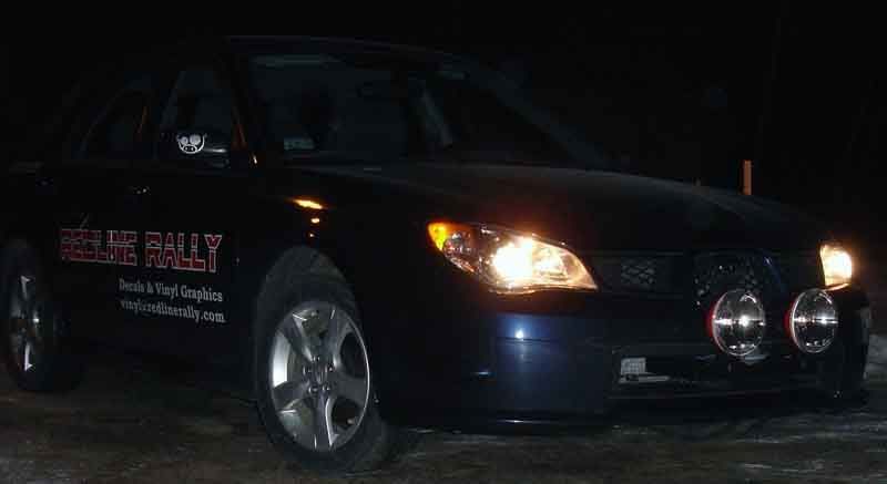

Sorry for the poor picture quality..but here is what I have. Silverstar Hi and Low Beams along with Hella 500's mounted with a bracket fabricated by iwagon.....they do the job:)

on the WRX is did the fog light mod to keep them on with the high beams, i run silverstar bulbs in the standard headlights, i made a light bar with 2 - PIAA 40 series pencil beams, and 2 - Hella 500 cornering beams for the sideways action at night.
i can usually have truckers flashing me from behind about 1/2 mile down the road.
