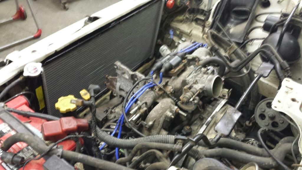

So I had an unexpected day off yesterday so I worked on this. Gabe came up and hung out too. I got the pitch stopper all modified and mounted. I take all hooked up with some modification and help from Gabe. Power steering lines close to finished. And a bunch of the wiring is connected now. Still some figuring out to do with that though. Hopefully not much longer before it runs.
A few pics
This is the EJ intake installed, using an 88 GL turbo air box
And this is an EJ pitch stop mount modified to fit. I cut and spread the top mount to fit the EA transmission, then rewelded down the middle, and then ran a long bolt thought the lower hole after drilling a hole in the clutch cable bracket.
