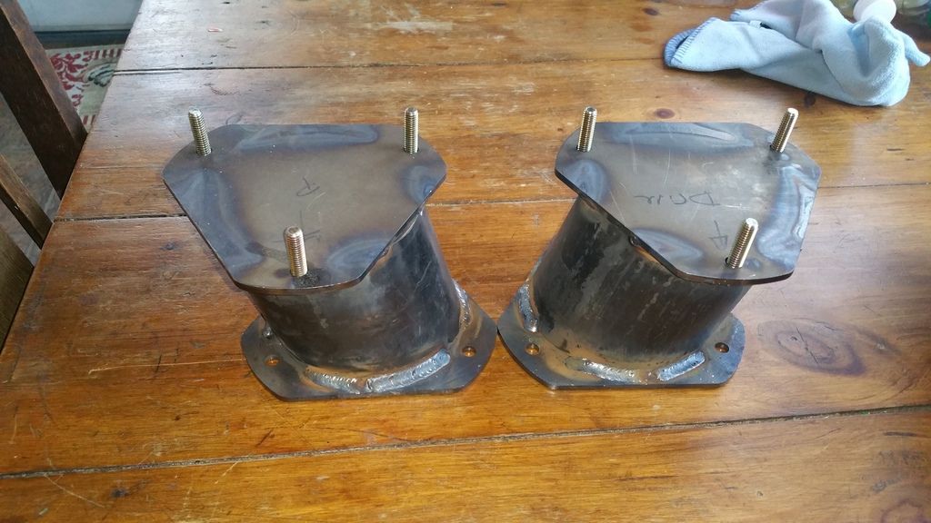

Got a yakima Loadwarrior extension piece for this, and new, better, and more camber correct front strut lift blocks from ADF. Because I like buying things for a car that doesn't work.

Got my new front strut lift blocks installed tonight. So much better camber now. Anyone wanting a lift, even for newer subarus, check out Anderson Design and Fabrication on facebook. He makes some really awesome lifts and has prices that beat most others.
