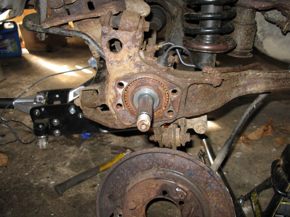

Dear outback. Please stop breaking. I found and killed my coolant leak tonight. Bottom radiator hose. I made the biggest damn mess replacing it.
It still need rear parking brake shoes because one disintegrated when I was changing the wheel bearing. I'm gonna make a guide for that. It's wicked easy, but everyone is scared of them.
Then I need new front brakes, but I can't afford that right now. I'm gonna go with smaller ones from a 2nd gen because I want to be able to clear 15" wheels. I already confirmed 15" wheels clear the rear brakes.
Then long term, it needs a new transmission because the 3rd gear synchro is totally effed. Which I'm kind of bothered by. I have a trans I might use, I just don't feel like doing a tranny swap. I HATE transmission swaps. I can't even complain about cold because I have an insulated garage and a heater.
