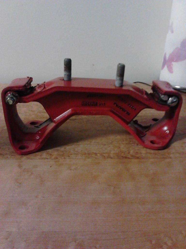

One coat of anti rust spray, couple light coats of paint then clear coated it:
If those bolts don't work out, I'll have to figure out something to stiffen this up more. I was toying with the idea of filling in those voids on both sides with some sort of filling compound. Then paint it again, durrrrp.
