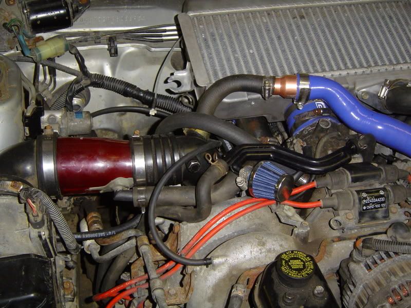

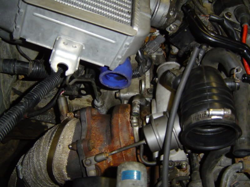

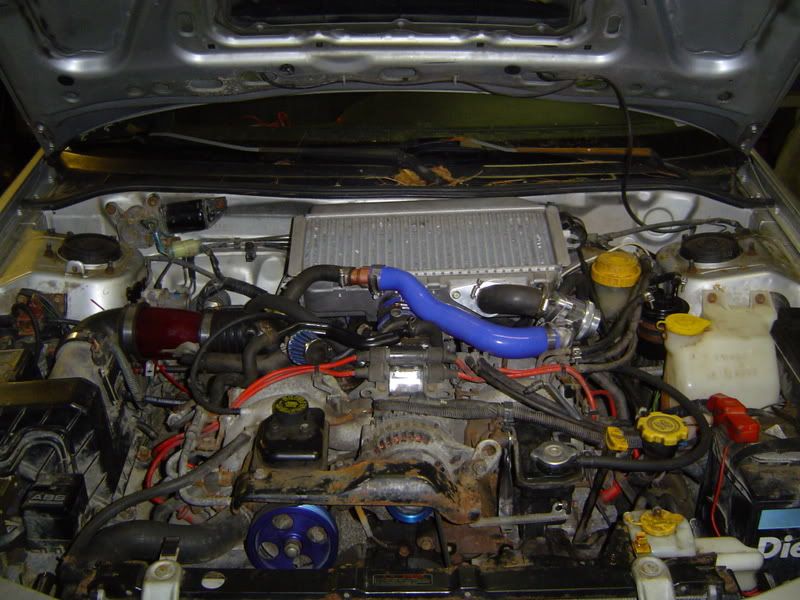

Turbo is back in. The IC fits pretty good now. Just need to extend the piping.

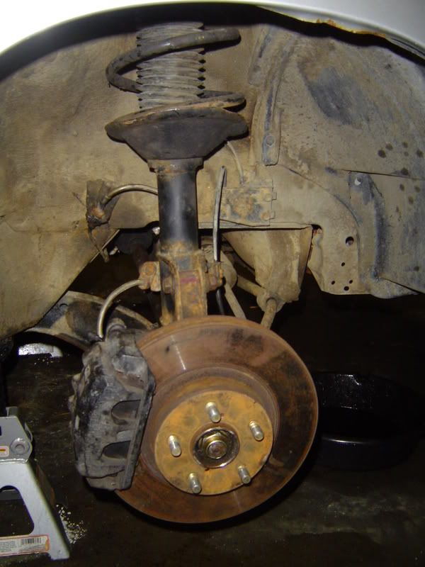

WRX struts and springs are in. As well as 03 legacy front calipers, SS lines all around, and axis pads in the front.

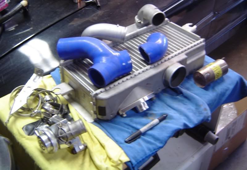

I know I'm not around to get them to you but I have some hoses left over from my intercooler setup. I can bring them down next week after I get back. You can add it to the grocery list :
I should be all set as far as plumbing goes for the IC. But i could alway use more hoes.
Oh, i mean hose.

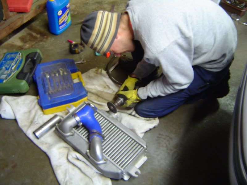

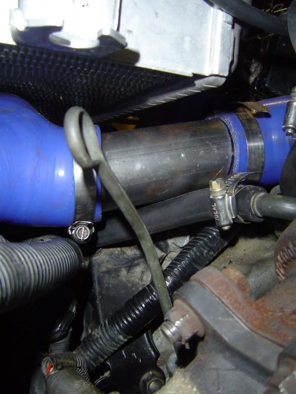

Had to cut the perrin. :'(
Had to cut the IC. :'(
But it was worth it!

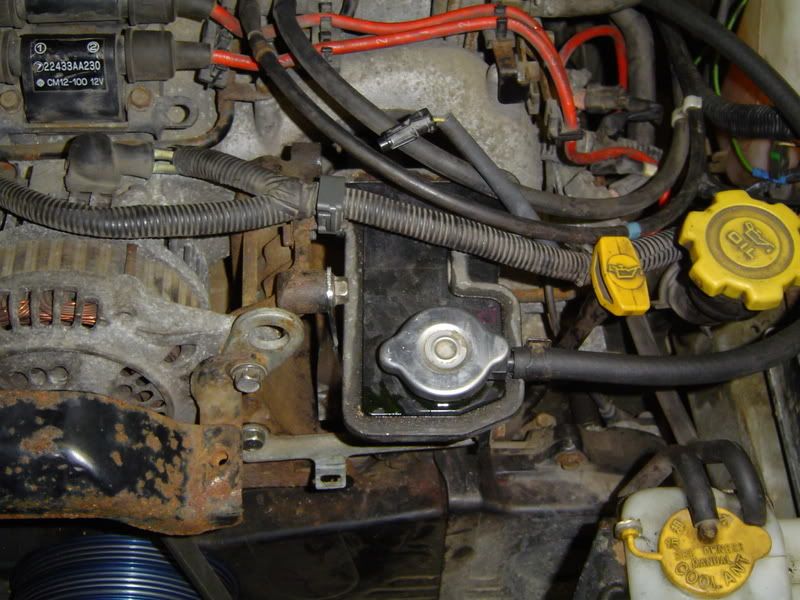

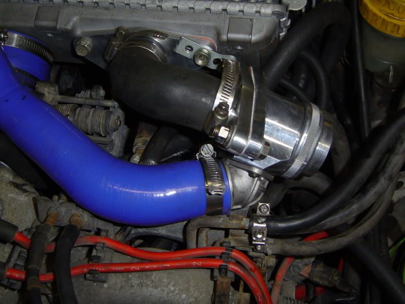

Getto rigged BPV.

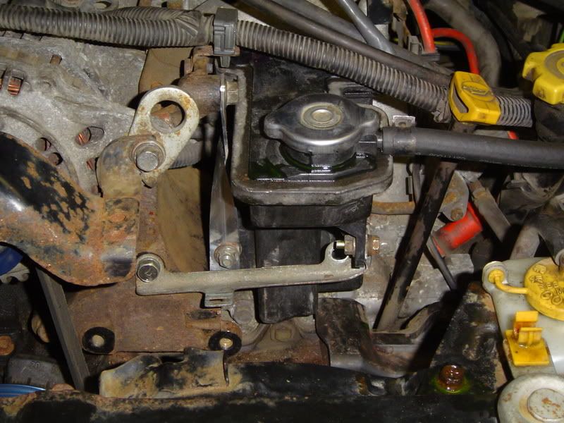

Getto rigged coolant thingy.
Everything might be kinda gettoed, but its all very sturdy.
This still needs to be cleaned up some.

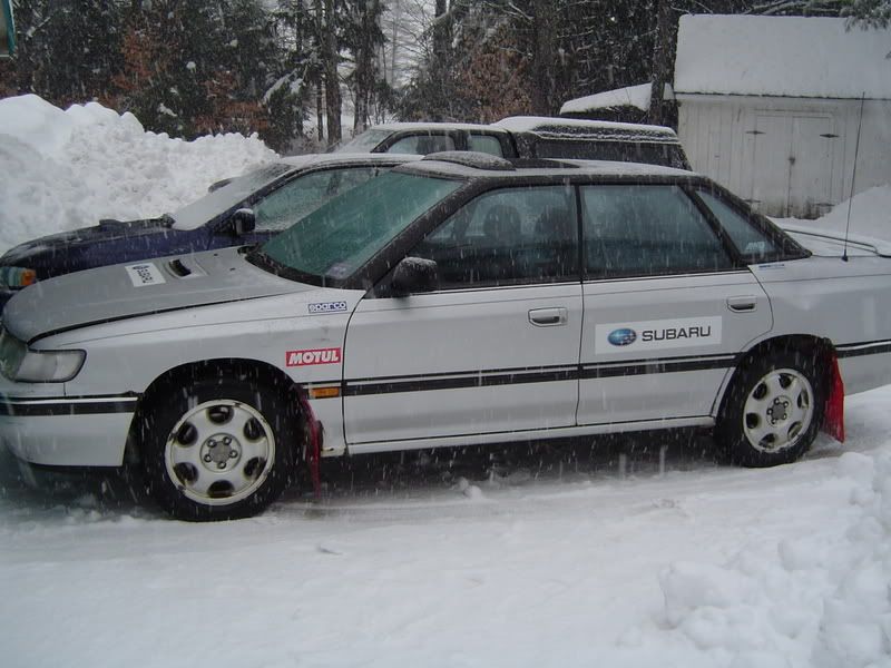

Fitting her maiden voyage be in the snow. ;D
She started first try, and nearly immediately when i turned the key. Always been like that.
Runs good so far. There still is a little exhaust leak just under the turbo. The uppipe had been leaking. I'm thinking something might be warped or the uppipe actually has hole.
But it's better then it was.

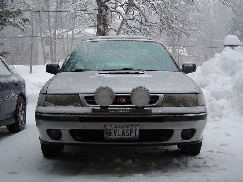

So after my first drive to work i have found a couple of things.
It handles great!! The WRX suspension and the straight rear tighter bar do a great job.
The brakes feel good, despite the ABS light still being on.
It pulls like a motherf*cker!!!
But with that something is still not quite right... My boost gauge read 23psi at one point!!??!! ???

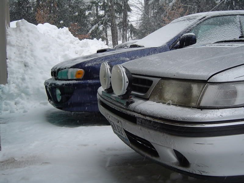

If you look real close you can still a bit of the shoe print.
I'm sure that wasn't the first time she got a good kick.
and i know it wont be the last! >

Suggestions:
Cut off the tails of the clamps for a cleaner look.
Visit siliconeintakes.com to find some plumbing to eliminate a lot of your reductions and splices.
