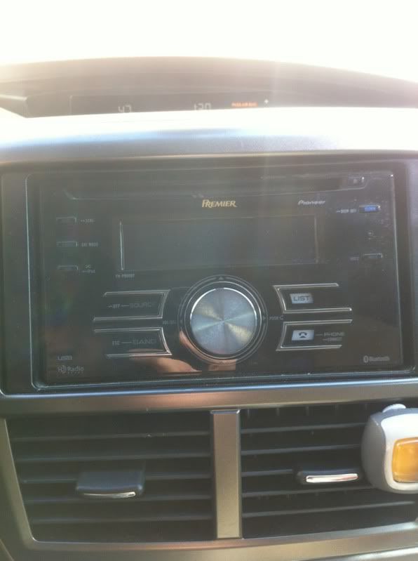

Ok so the HU is in and working thanks to Apkarian!!! He knows his stuff! Some minor issues to still deal with.
Scosche trim ring would not fit
Need to reprogram the steering wheel buttons again

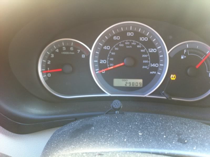

figure out where I want the mic
I really like this HU! Sound quality is so much better. I need to figure out how to hook up a USB and Aux in the back of the HU. Biggest down fall to the HU is no BT stereo streaming.....
Joe, I removed the stock BT mic and put mine in there, its where the sunroof button is. You probably have the same one as I have a Pioneer unit too.
Get rid of the Sosche trim. For a small price you can get the JDM trim that fits perfect. You would use your original metal mounting brackets. It looks way better.
The cable you need for the iPod connectivity/USB connectivity is the CD-IU51V (there is also a CD-IU50V) but go with the updated one. www.bestbuy.com Not too expensive. Ebay may be cheaper but make sure its the IU51V.
