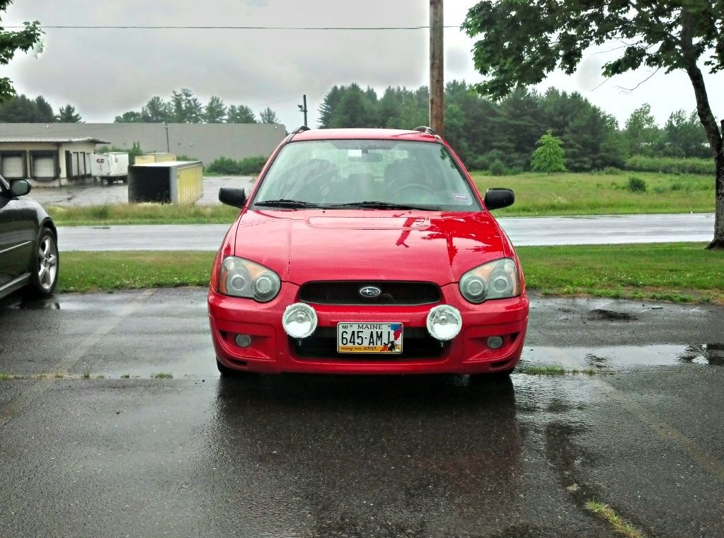

Who has mounted big fogs on their 04, 05 blob eye subies? I want the look of the bug eye subies with the big fogs, but I can't seem to find anyone that has a fog light cover for a big fog light on the blob eyes. I've seen the JDM fogs which are big, but they cost 500 for the covers and lights. Using the stock locations, has anyone pulled this off?
7" of 1/8" almuinum angle bracket per side & bolted to the bottom of the bumper beam looks like this:
To mount larger fogs in the stock location you would not only need to modify the fog cover but you would need to hack into your bumper beam for the added clearance. The stock fogs mount onto the fiberglass bumper cover. You might need to find a sturdier mounting point if you are mounting heavier lights.
Just FYI, those will shake like hell with only aluminum. I have doubled up 1/8" aluminum and it still shakes. I am going to swap to steel.
aluminum angle is more rigid than flatstock. I use 1/4 inch flat steel and wouldn't go any thinner for flatstock. Angle use a good 3/8 to 1/4 alu or steel.
After a spirited run on Beaver Berry Road in Limington I am happy to say that the 1/8" angle mount dances no more than the headlights
The only problem with this mount is if someone runs into you

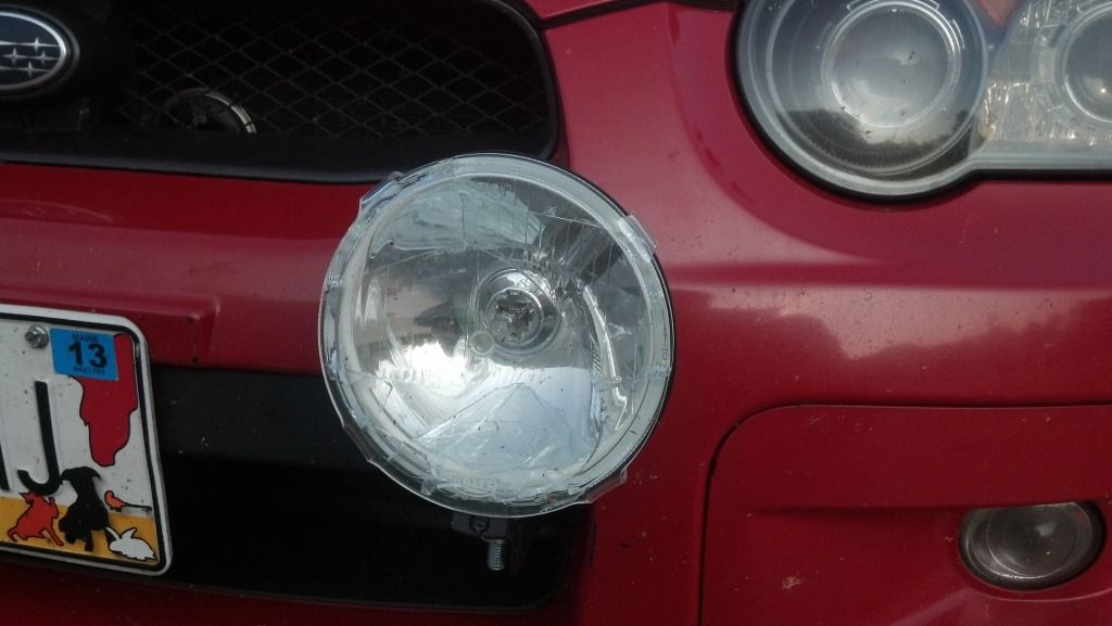

Yeah... I still need to figure out a way to repair the lenses, since Hella doesn't sell them by themselves. I was given four Hella 500 bodies without lenses, and I recently smacked my FF1000 and shattered it.
I wish I could make one completely out of clear tape! lol
I Could use a spare FF1000 chassis if you don't have new glass for it Stein.
and that mount has no impact on the lens shattering if you are hit. the mount will give before the glass does.
Mounting methods aside, it's waaay better to mount aux lights above bumper level. They are much much less vulnerable to impacts there, like from parking dings, snowbank surfing, and unplanned excursions into the puckerbrush. There's good reason that rally cars mount aux lights up on the hood, not down in the impact zone!
I've said that all through out this thread but no one wants to listen.
Put your lights in line with your headlights behind your bumper beam.
I broke both the crappy plastic mount and the glass out at OTR. I think I'm going to hold on to the chassis at least until I get another pair of driving lights.
