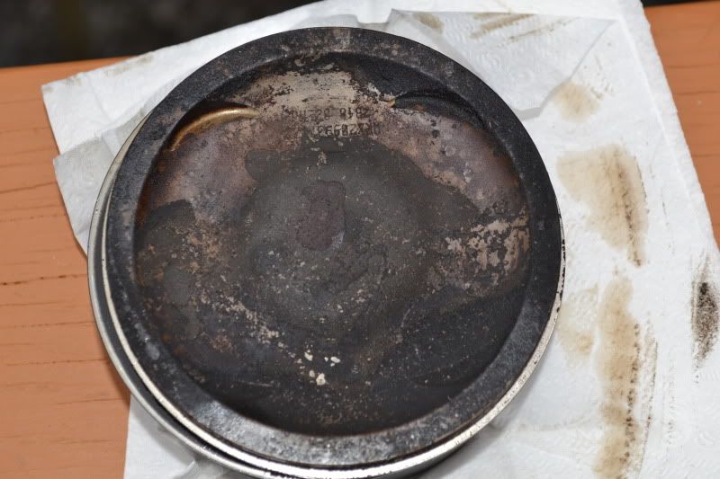

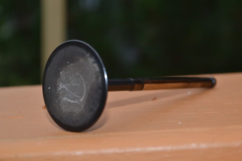

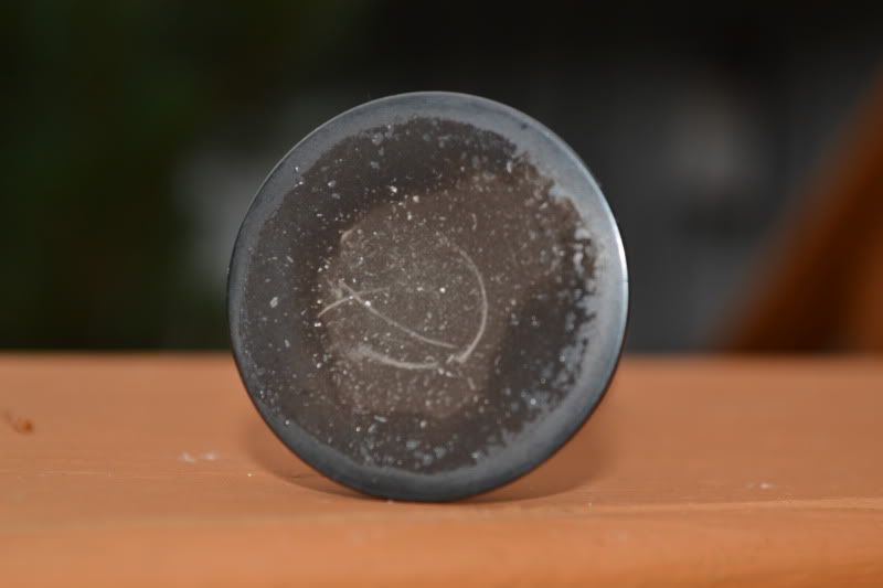

where are they saying contact was made? If they suggested that the valve relief was contact, they should not be in business. seriously.
That's exactly what they are telling me.

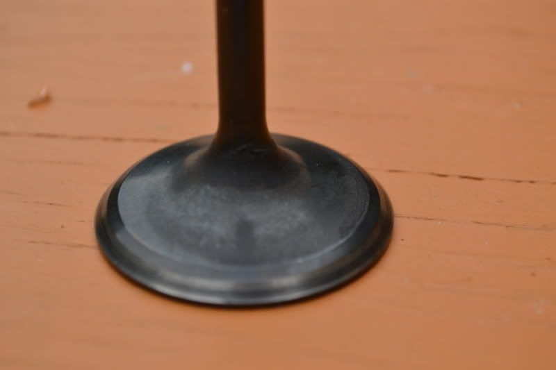

And yes, valve rim is perfectly round. If the piston was making contact, there would be much more damage.

I was asking about this part(circled in black)

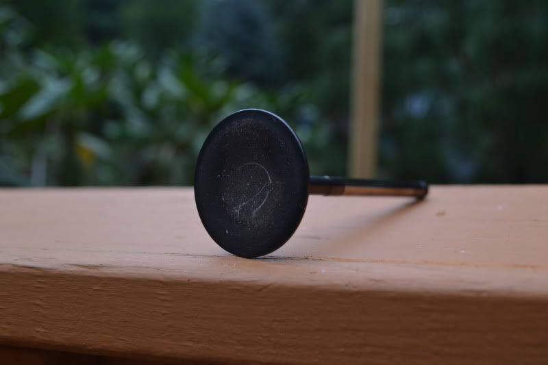

Well the valve that failed didn't fail from being bent because of the reasons everyone has said. It either falls on them or the valve company(if the valve is found to have been defective). A valve can not take the force required to make those reliefs nor could they make them that perfect and machined.
I'm no mechanic but I think that the engine build was botched. You said that the clearance on the valves was supposed to be .08 and they said they set it to .14 or something like that. Sounds like they set it up with the wrong settings. Not good!
Valve relief was the valve hitting? Counds like they're trying to bs their way out of being responsible
Well it blows my mind that they want to only discuss this theory of the intake valves hitting the pistons, yet avoid to talk about what really caused the failure.
is there any sign on the other pistons of the valves hitting the piston? be it that they were set at almost double what they should be youd think there be some sign of it, with it being set at that gap did the valve seat properly in the head? misfire codes?
that is complete BS. do you have pictures of the parts when they came in? I would bring those in and drop them on their desk. They seriously cannot be that dense.
