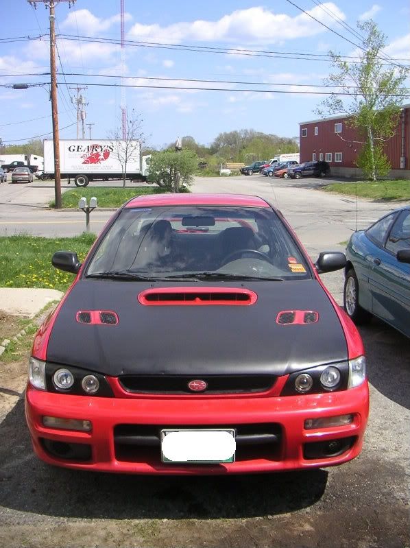

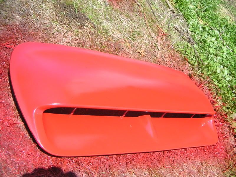

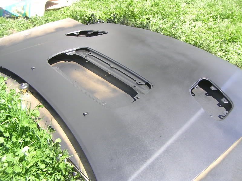

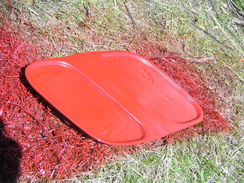

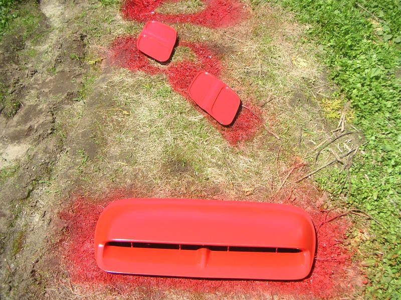

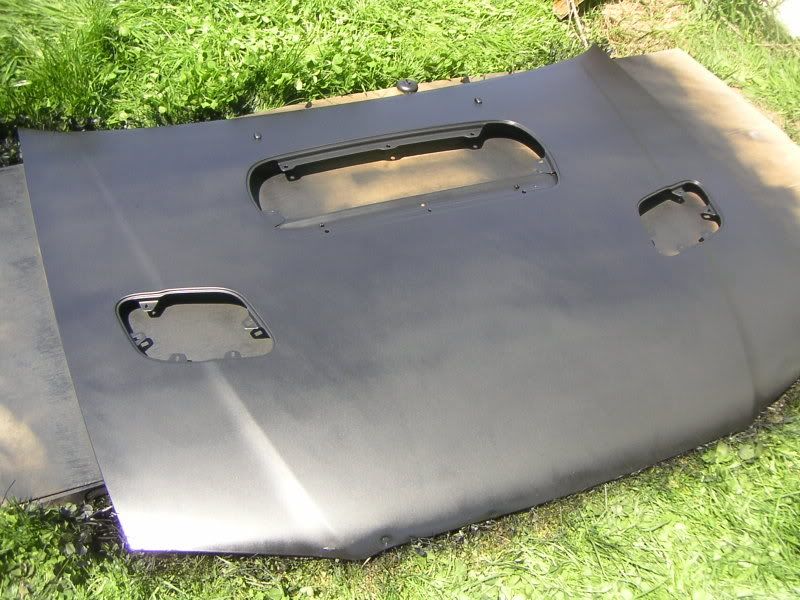

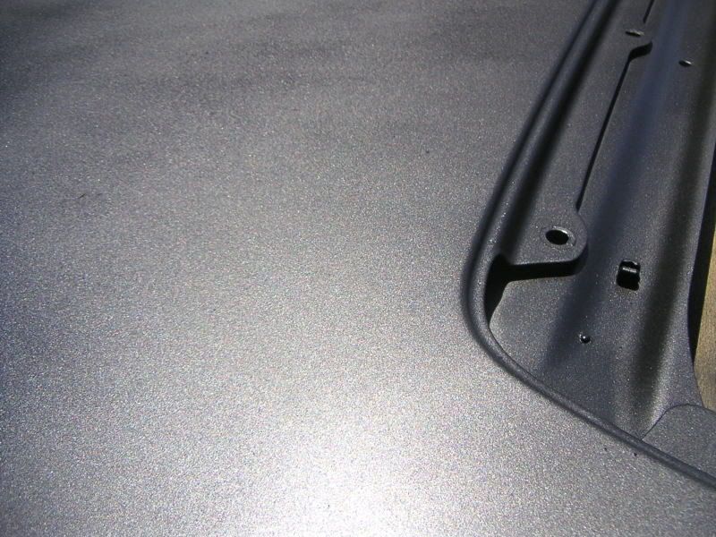

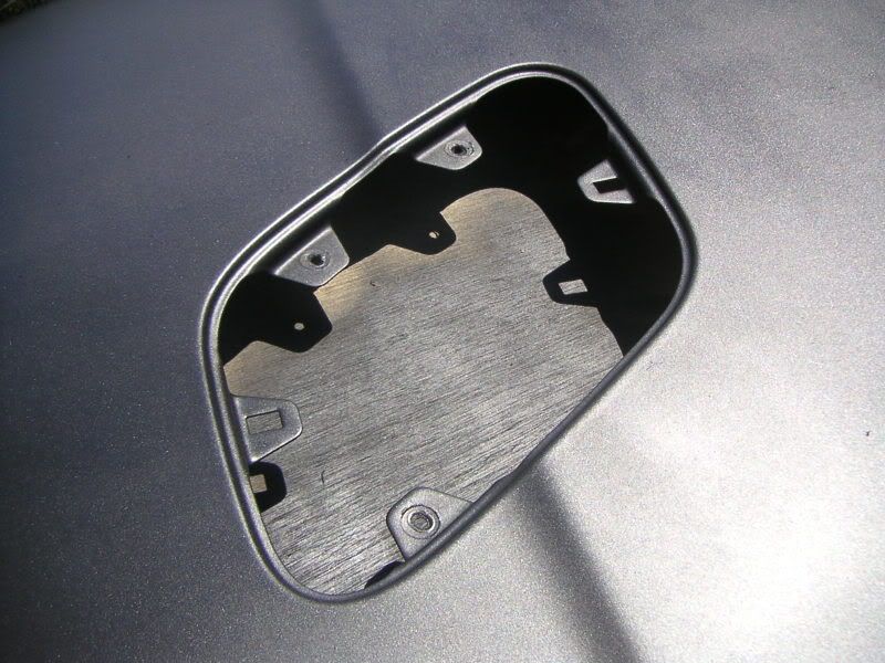

Alright, last coat for now ... I need time for it to dry and I'm almost out of paint anyway. I decided to go with the red scoop and vents to try it because one of my cans of black wasn't spraying right .. I fixed it but I ended up using both cans on the hood. If I don't like it when it goes on, I'm gunna do all black, but I did test the red, and it's pretty close .. a bit lighter, but I don't think it'll be too noticeable with it being separated from the other red.

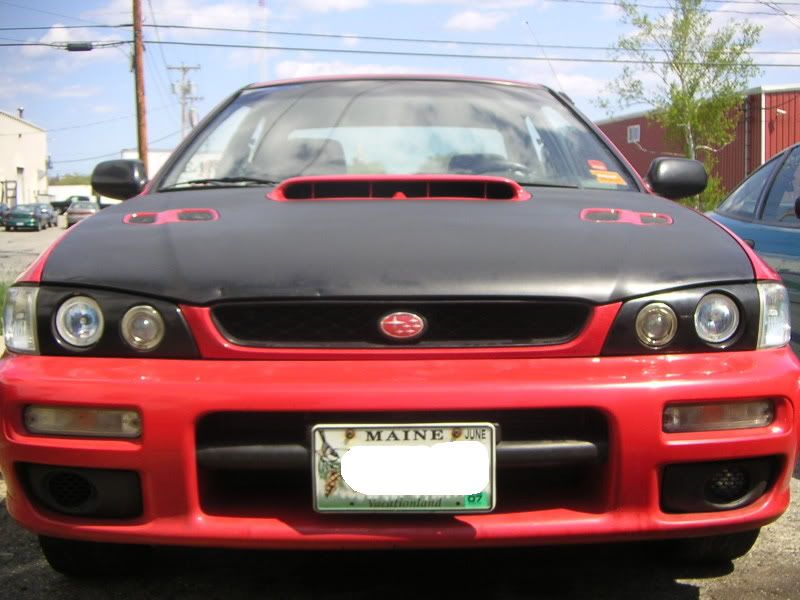

Here it is, the final product ... the red is slightly different, but it's hard to tell if you aren't standing right up close ... I like it a lot!!
Woah!
Nice job, man! I like it too!
However, IMHO.... let the paint cure more than that! Yikes! That stuff will chip in a heartbeat!
Haha, too late :
I needed to drive it.
Should I clearcoat it too, or will that ruin the flat blackness?
yeah the black hood looks pimp. i would have tried to hammer out that dent or what ever that was. but the car looks great man! good work!
I don't think the dent is gunna come out so easy .. it looks like someone took a punch, and hit it with a hammer. I think when I have it done, I'll see if they can fix it .. however I could be wrong.
And thanks, I like it too

Yah meng, that looks awesome. You were right, the black and red combo. I think the black lights help it to all come together.
