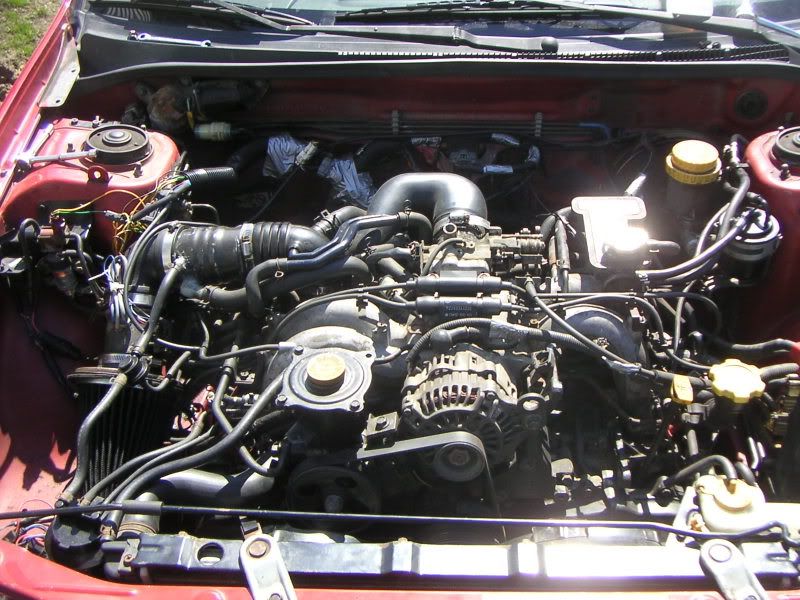

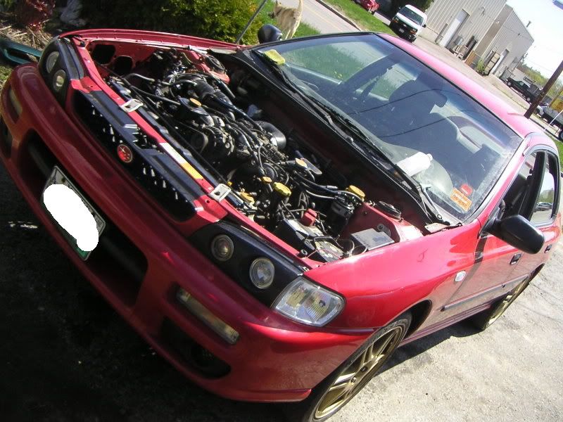

We were driving it around today. We traced 60 wires going to the TCU. Checked where it was, what color, where it went, what it did, what it should have for voltage. whew!
We found two wires that were un-hooked. the Leggy ECU didn't have a place to hook them 'cause they were coming from the Imrpeza TCU. Found out what sensor signal they were suppose to getting and stole the reading from the sensor directly, bypassing the ECU.
It's going real good. It's not far now. He needs a hood with a scoop! I've got a WRX scoop he can have if anyone is good at cutting a hole in a hood.

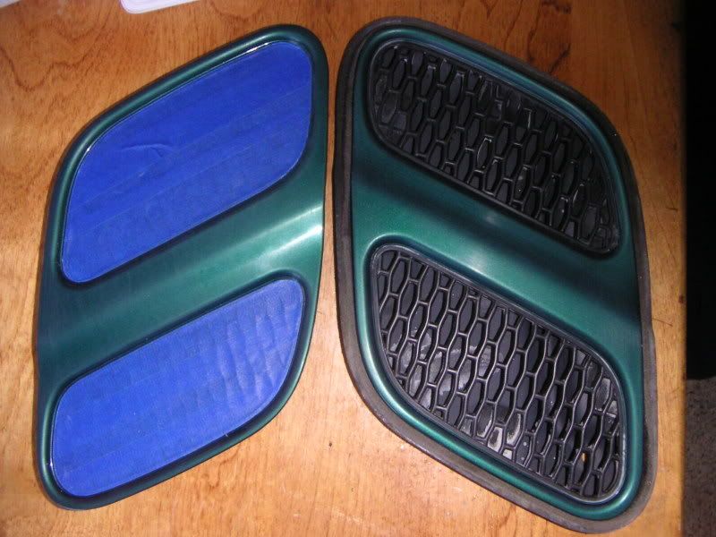

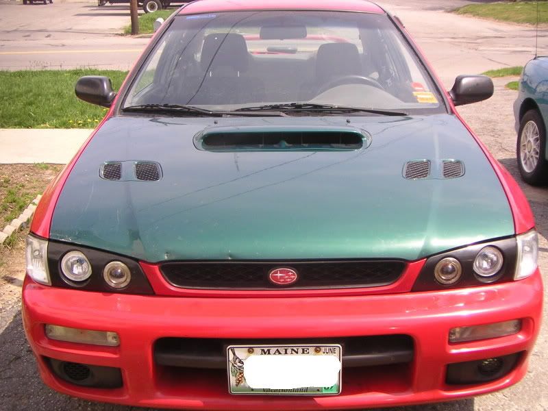

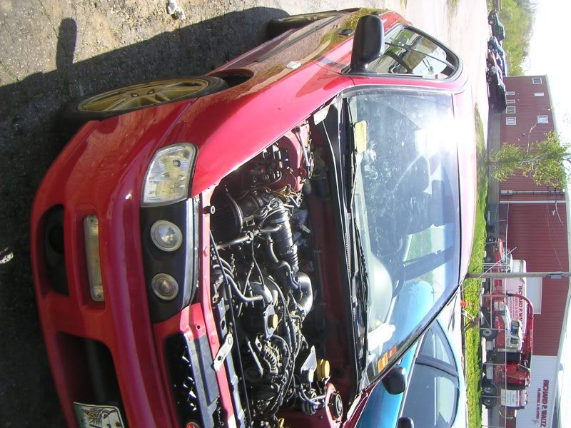

haha I do like it, although I would like it much better if it shifted at redline and not 4k when I floor it .. and even more if it shifted anywhere but 4k ... it will only shift to the next gear at 4k, but it won't rev past 4.2k. I do however LOVE the turbo sounds and the turbo power (what I can feel of it while it's not shifting right), but I'm sure my transmission is hating me for it, because when it does shift, it clunks, it's not smooth. I need to paint the hood .. I got semi-flat black and some cherry red .. I was thinking of painting the hood black, and the vents and scoop red to mach the car .. What does everyone else think about that?
Here's one pic that I have .. I'll get more later -

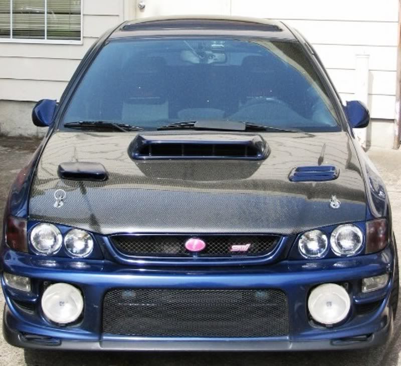

i don't suggest black with red vents. all black, or all green, or all red

Haha, yeah .. it doesn't smoke so much now. I got some not quite but still flat black paint .. I may still try out the red scoop and vents ... I just thought this looked good:
I second the painting of the headlights! Now that I see those examples, its worth a shot
if you had the resources, the best outcome would obviously be color matching... two shades of red won't do you justice.

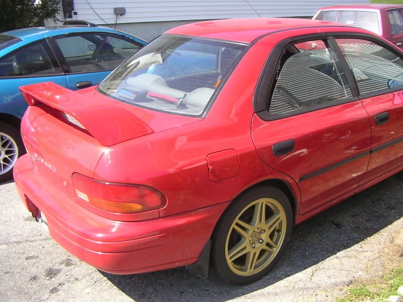

Some pics of the car .. she needs a good wash, hasn't had one since sitting in the garage for 2 months
My Little Baby Turbo
That's what everyone else calls it :

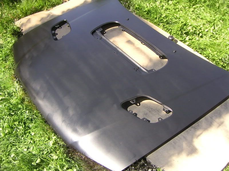

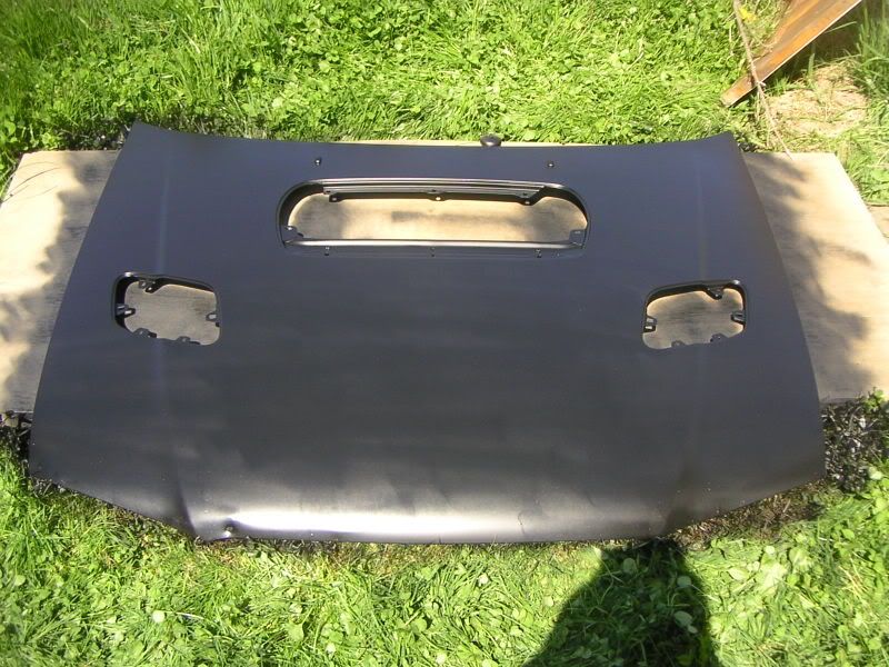

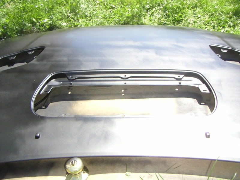

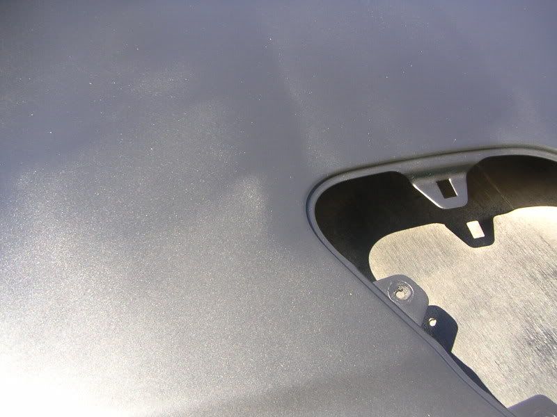

Alright, doing some painting ...
First coat on hood - Semi-Flat Black, I like it so far

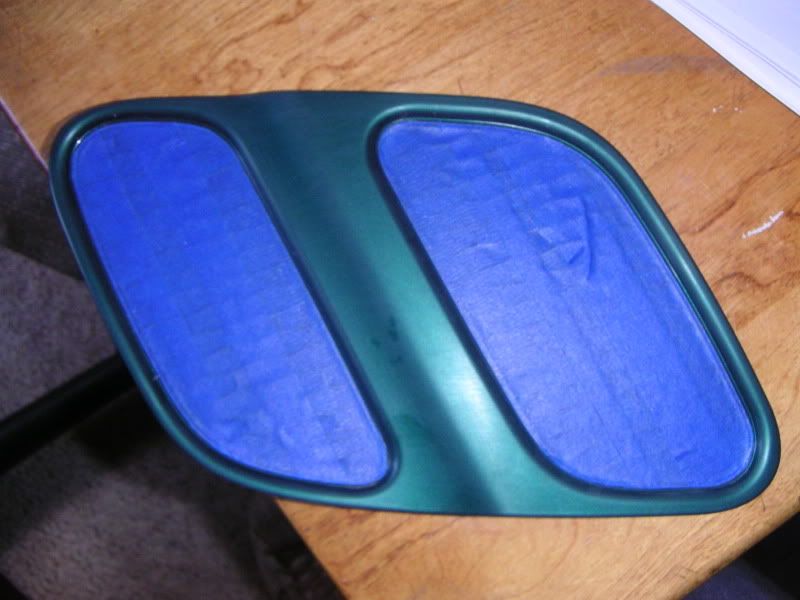

Taping the vent grills
