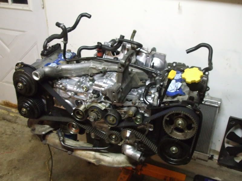

STi EJ257 short block going in!

Update: The pass. side head had 25% leak on the worst cylinder #1 and 18% on the #3. Lapped the valves and brought both down to 10%. yay

****ing timing belt tensioner put everything to a screeching hault today. Everything was going well too...
his old one. You could see the oil was seeping through the top, and i was wondering why it didnt take me too long to compress it. When rotating the crank, you could see the tensioner moving up and down quite a bit.
I totally looked over getting a new tensioner with everything else for this swap. Probably should have been replaced at 100k w/ timing belt.
