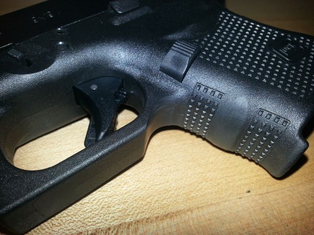

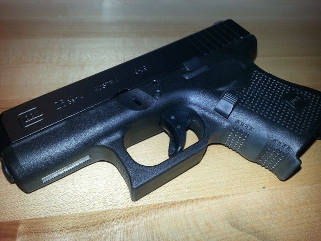

Reworked my G17, and G26 trigger guards. Man I love that undercut. Here's a couple shots of the G26. I smoothed the finger bump too.
