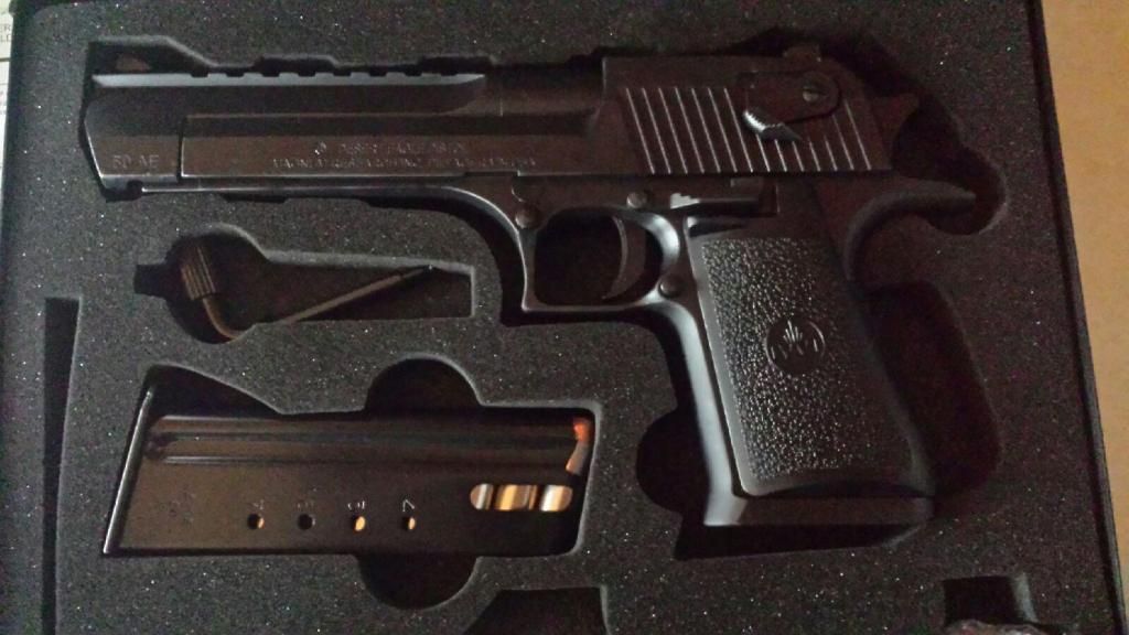

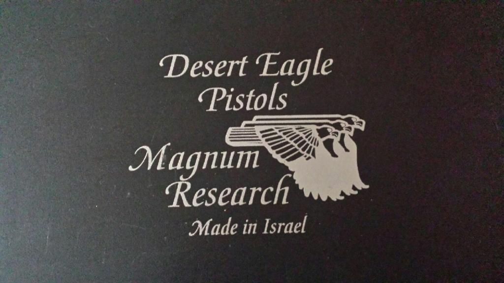

I couldn't resist
Love it!!!    You will have some fun for sure!   I dont shoot mine a whole lot, but just got a set of dies, so it might come out to play more often now.
