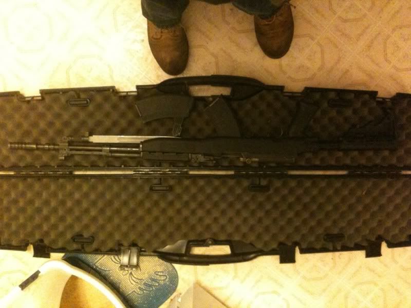

Mmmm cosmoline. Theres been a recent import of SKSs all smothered in cosmoline. Maybe that's causing your issues.

Talked kid I got it off they are aftermarket he was told it was the spring in the magazine causing the proublem but it does the same thing for both
. Figured I'd share sorry for crappy iPhone pics

Take that sks to a gunsmith. Its a sharp lookin rig, def worth fixing it.

Yah think I'm goin to drop it off at howels This weekend anyone know what there labor rate is ?
its ok at 25. decent at 50 and does a 2 inch + group at 100. I've read its common for the military trigger to adversly affect accuracy. found a tutorial on how to tweak the origional and if I screw it up I'll just buy the drop in.
Not sure of the actual rate. They had my M1 Carbine for a couple of weeks. They fully cleaned it, polished the chamber, finished pressing on my rear sight for me, greased all the movables, and then put three mags through it to make sure the problem was gone. Came out to $45.
