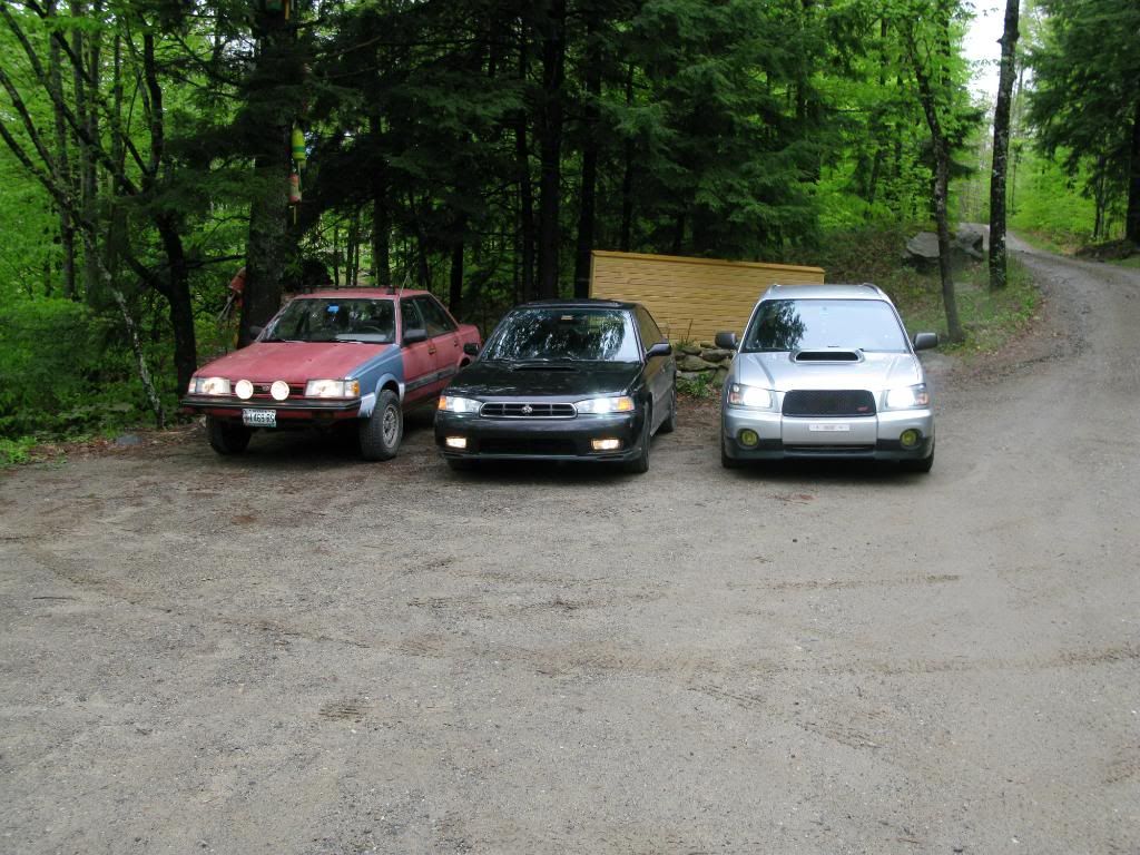

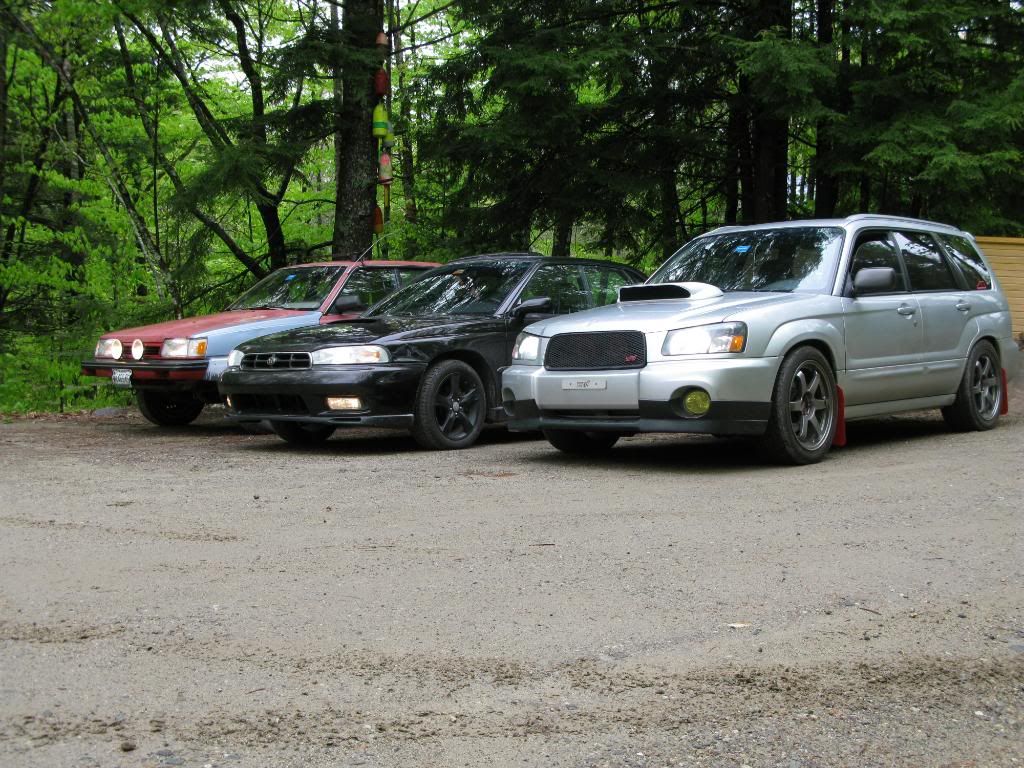

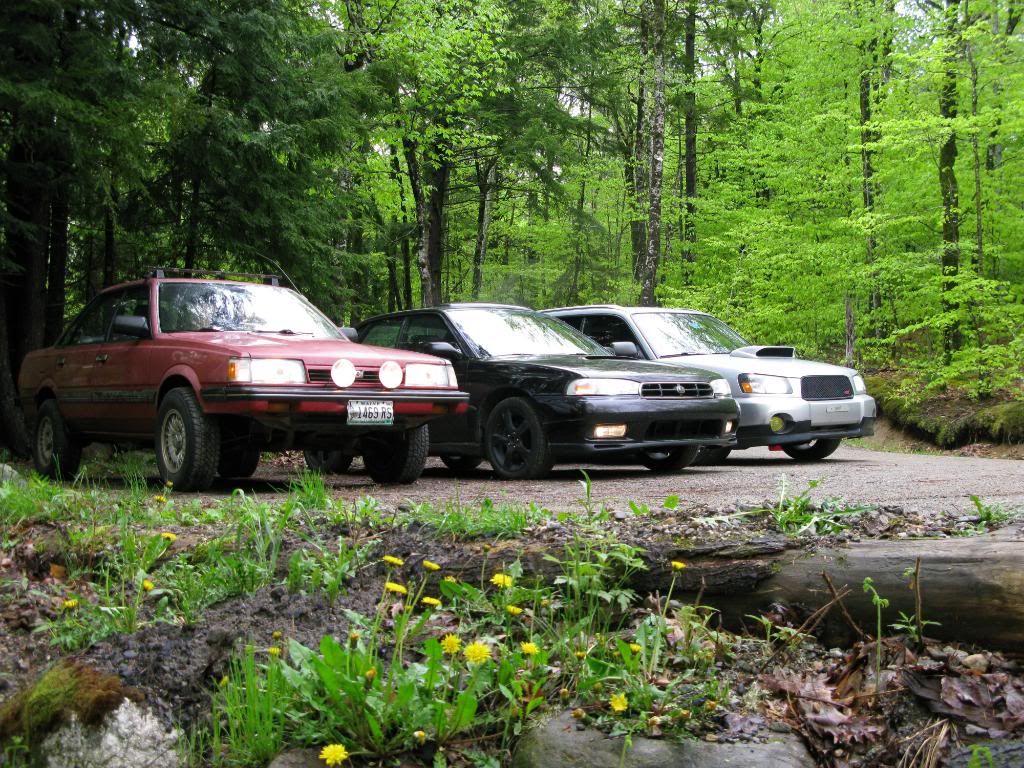

Oh, and pics. Mandatory when one has three awesomebarus in their driveway.
And my fav
