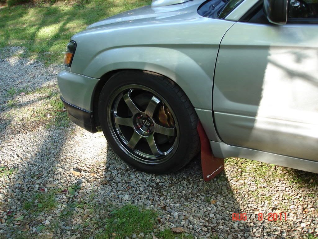

Won an STi gas pedal on ebay for 10 bucks, which is cheap compared to what they go for. I wasn't really looking for one, but figured why not. So I installed that today. Ooooo shiny.
I still have a few things to install, so maybe within the next few weeks, some of it will get done.
And the only real big job to be done in the future, is to replace the clutch. The brand new one that went in with the 6 spd is terrible. It chatters so bad, that I just don't want to deal with it. So I got a steal on a brand new 6 spd clutch kit, and I have an STi flywheel as well, so I just need to get that refinished, and then find someone to help me install it. At this point, I can't afford to pay for anything to be done, so I will have to do it myself/get help from the great people on here! Haha

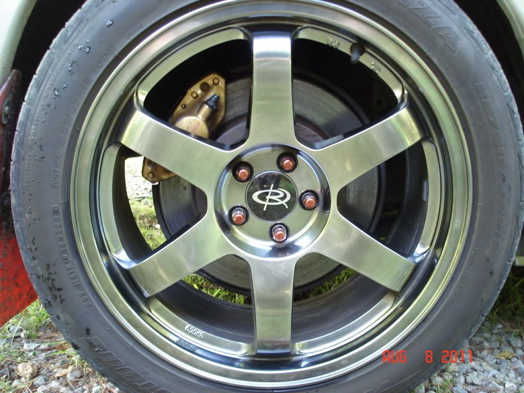

And I'm still waiting to here back from ROTA about the wheels flaking. Hoping they are going to do something for me, since wheeldude flat out wouldn't do anything. They have terrible customer service. They were rude, and just didn't even try.
And the things I need to get are brake pads. Found a great deal on turninconcepts for front and rear stoptech pads for 90 shipped!! That's cheap for decent Brembo pads. And then maybe a Group N tranny mount to take care of some of the drivetrain slop.

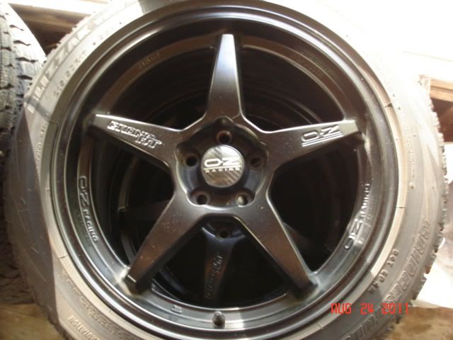

Picked up my new winter set up last night. 17x8 OZ Crono HT's. Should make a pretty decent set up, and they clear Brembos, which is all I was really after. I'll get pics soon.

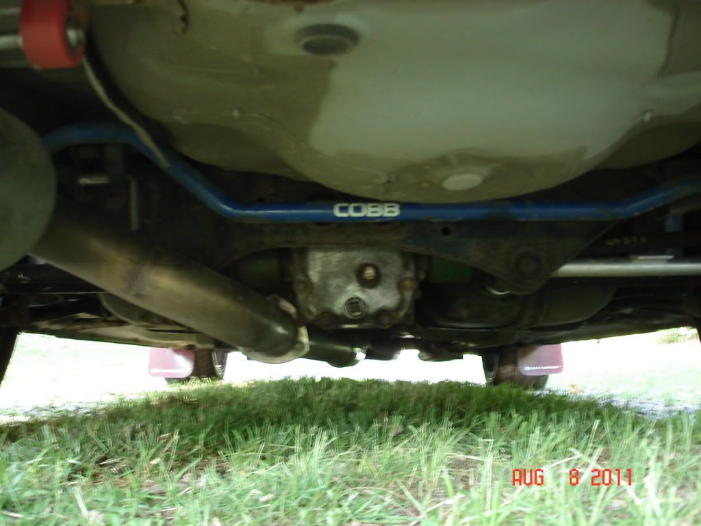

So I learned over the weekend that the reason I have a bad vibration/noise is because I need to use a Forester auto driveshaft, not an Impreza one. The Forester one has a lower mounting point than the Impreza one, so it drops the driveshaft down to have the correct angle coming out of the transmission. So to just test the theory I added a few washers to drop it down a little, because I don't have a Forester driveshaft yet. So today I drove the car to work and that is DEFINITELY the issue. Just the 2 or 3 washers I used on each side, was enough to help. So, I either need to find a Forester driveshaft, or find longer bolts, and use a few more washers. It will be nice to have it back the way it was.
Lol, hell no!! If I was that sick of it, I would just sell it!! But I do need to find a driveshaft! Or longer bolts, which surprisingly I don't have any!!
So Gabe hooked me up with an older Forester auto driveshaft. Finally got it installed today and it's fixed!! That was the issue all along. Something as stupid as a slightly wrong angle on the driveshaft caused all this. I'm jut glad it's fixed. I did find that the mouting ears are smaller on the older ones, so I had to modify them to work, so it would be nice to find a driveshaft out of an 03-08 Forester auto, but this will do for now!
