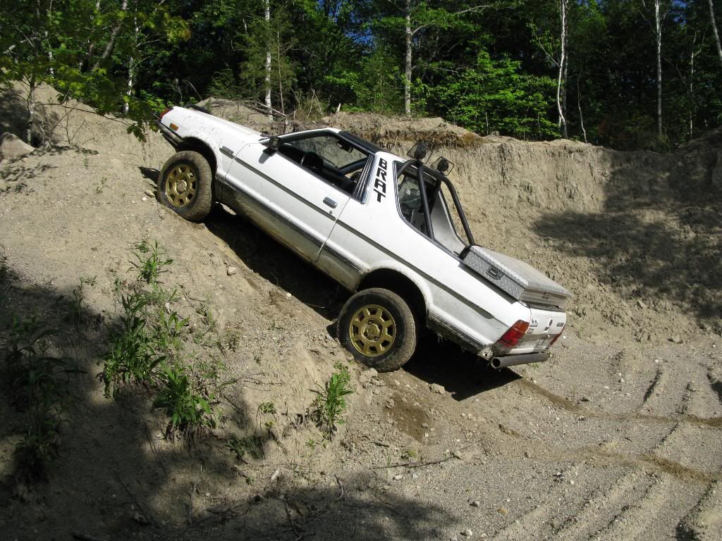

So I broke an axle toward the end. Just put it in 4wd and it kept going home... Unfortunately (for some retarded reason) the brake pad decided it was going to follow suit and commit suicide too. So I'll need front brake pads. Monday I'll get that and my warranty axle, should be good to go! Yay. I love my old suby.
(Jason didn't get off without breaking his either; fuel leak, so I'm not alone breaking stuff

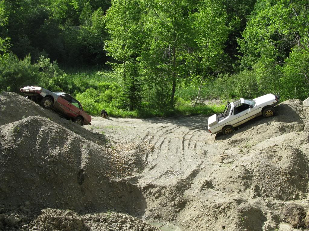

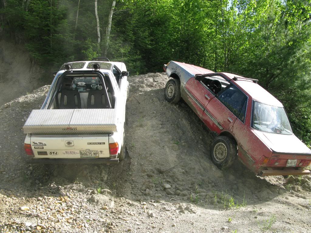

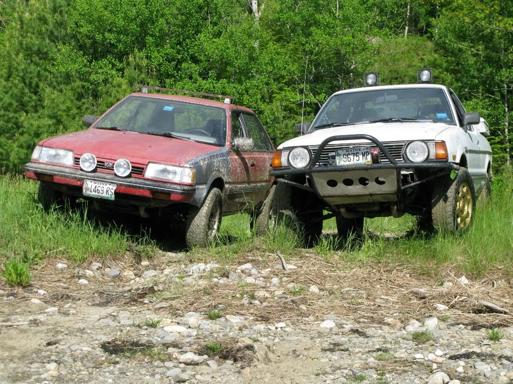

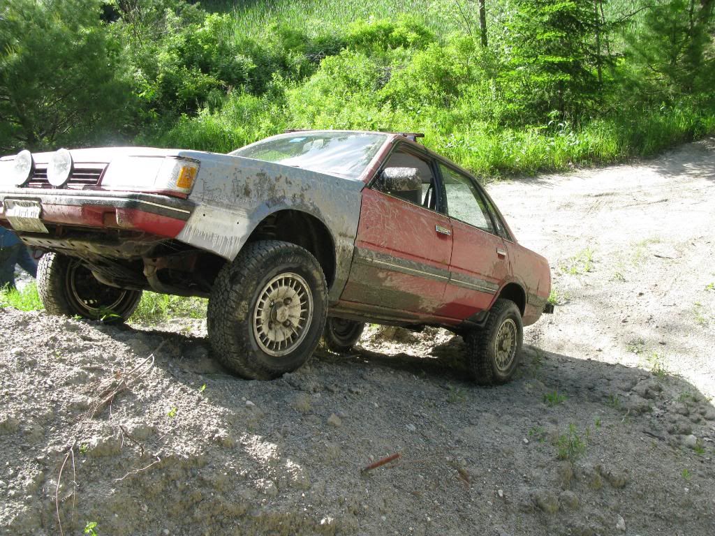

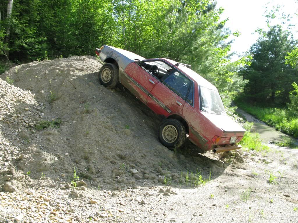

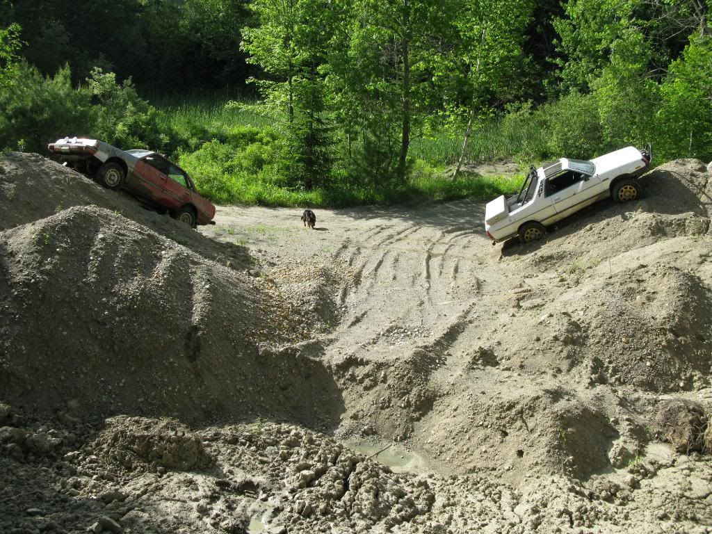

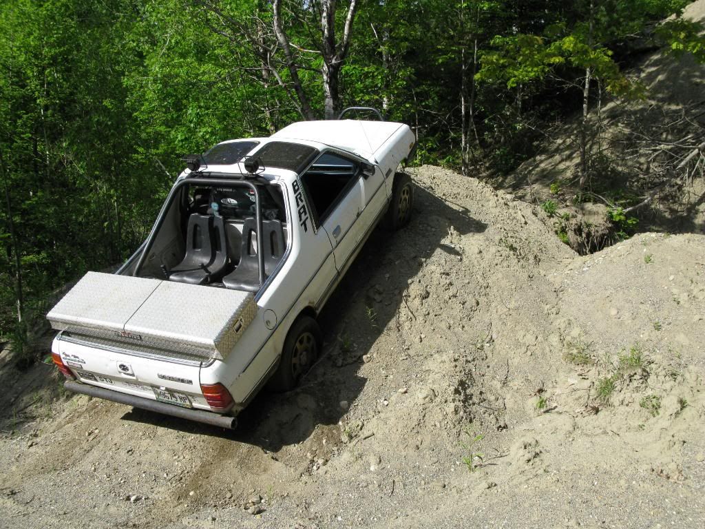

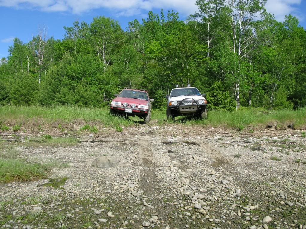

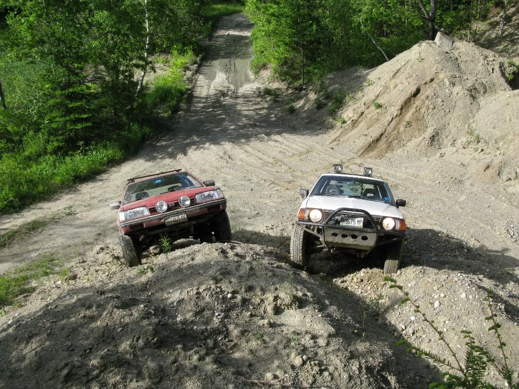

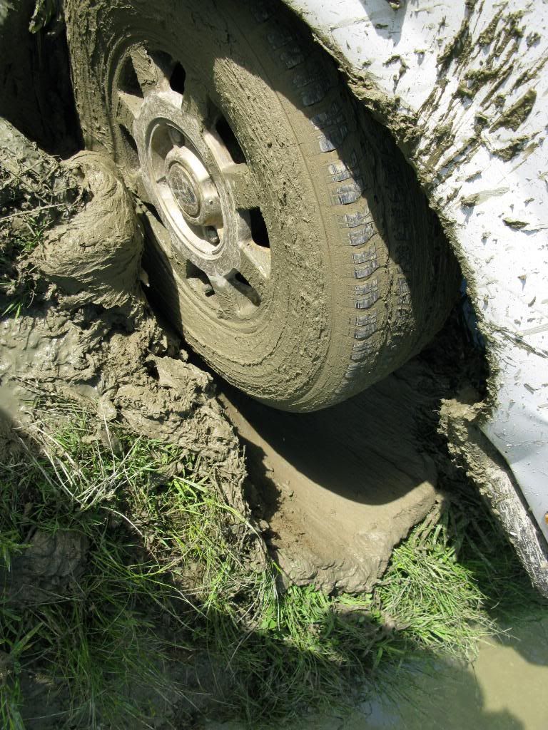

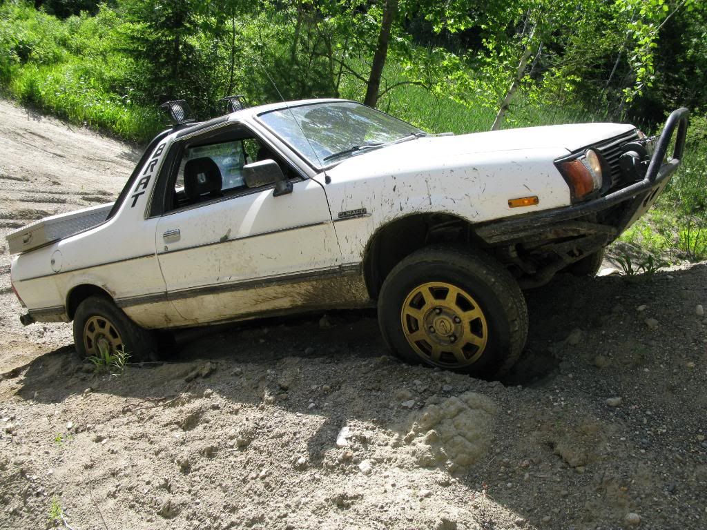

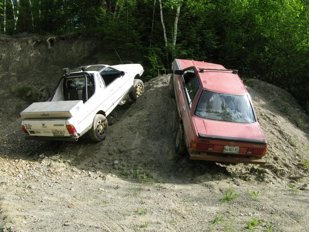

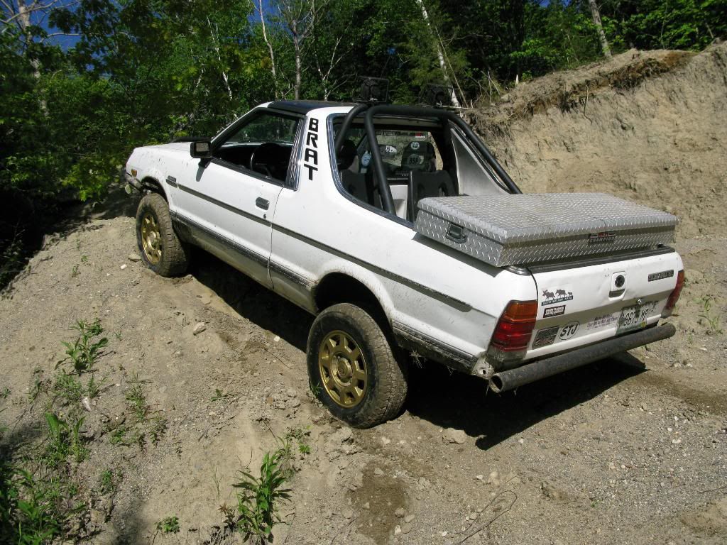

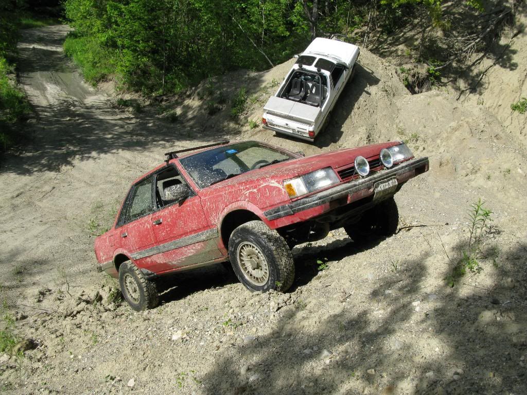

Oh right, pictures.
Umm lots of them.
STUCK! haha
Awesome pics!! I really don't think I broke anything today, I think that has been leaking for quite a while and I FINALLY found where it was coming from!! Had a good time, hope we can do more of it!!
Def should do more! I'll have my car back on the road Monday as soon as napa gets my axle in. Watch the other axle go next time... hah.
Yeah that wouldn't surprise me! I really have to break down and do some random stuff to mine, and get it all legal again!
Wicked grumble.

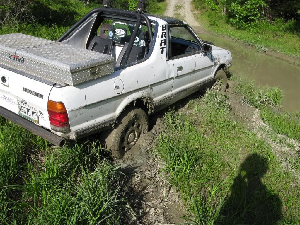

Chris, you didn't stop in the ruts at an angle and then attempt to move, and........I wasn't stuck. I was moving a foot back and forth!!! Haha I was just tired of staying in that spot!! Lol I have done MUCH more hardcore wheeling than any of this stuff in a Subaru and not gotten stuck. I wish there was better stuff around here!!! That was still a fun place to play!!

Hydro locked the engine and stalled it in a really deep puddle.
So I used the come-along to crank it out of the mud. Then since I forgot my tools

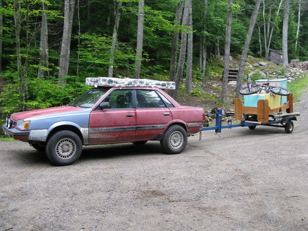

I'm pretty sure that trailer is meant for something a little pointier on the bottom...
lol, nice. The new family truck?
