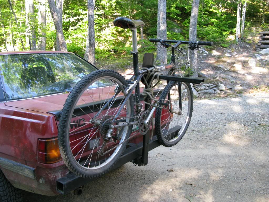

Home made hitch mount bike rack.
UPDATED WITH BETTER PICTURE
Hope you use some padding, or your frame will be killed!! And is that paint I see on the bumper?!?! Awesome!
Padding to come. Yes, I've been painting things lately.
It's not like that bike isn't beat to hell ... but yes. It shall get padded.
