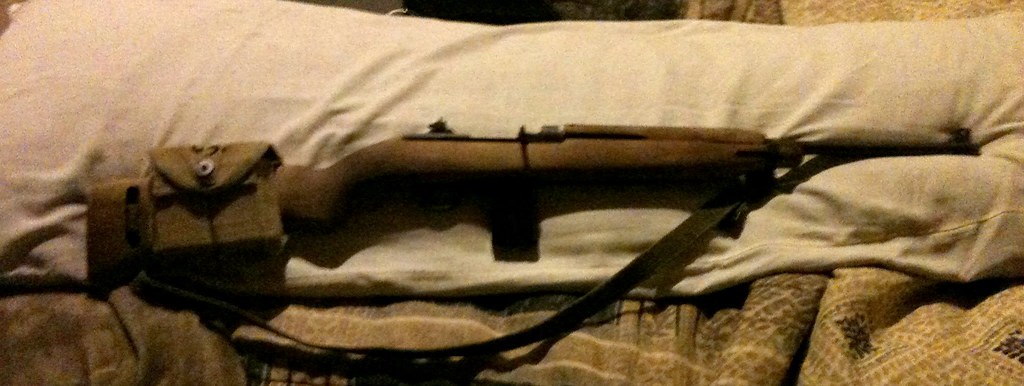

Well, iphone does not like dark pictures, but here she is:

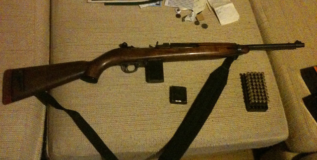

Compared to when I first got it:

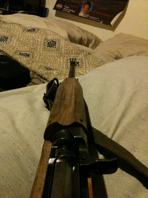

New handguard with the cutout for the flip sight

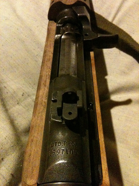

The half-way rear sight...
I still need to pull it apart again for oiling and I need to oil up the stock, but overall I'm happy. Well, except for my issue with the rear sight...and the fact that I already lost the new slide stop spring. It shot across the room while I was putting the gun back together *doh!*.

Sometimes the dove tails are tapered. Meaning they have a smaller opening on one side. Not sure if that's the case for your carbine. Mine (reproduction) has equal openings and slip right in and out when I experimented with the scope mount and red dot but its very similar looking to yours. Mine has a set screw that anchors the rear sight.
That will come to life once you oil the wood. I'm coming over to see it once its done.
Yea, this one is tapered. It's just reached a point where I need to stick the thing into a vice and tap the sight in with a brass punch or something. I was doing it with a block of wood and a hammer with it on the floor. I almost want to get the rear sight tool...but it's just too much money for something I'm going to use once and then never touch again.
