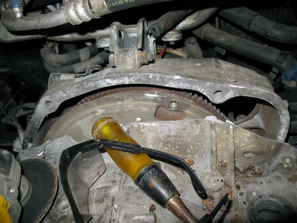

I won! The engine is sitting on the floor with a severely cut to hell bell housing.
I'll post some pics later.
I ripped it a new one...

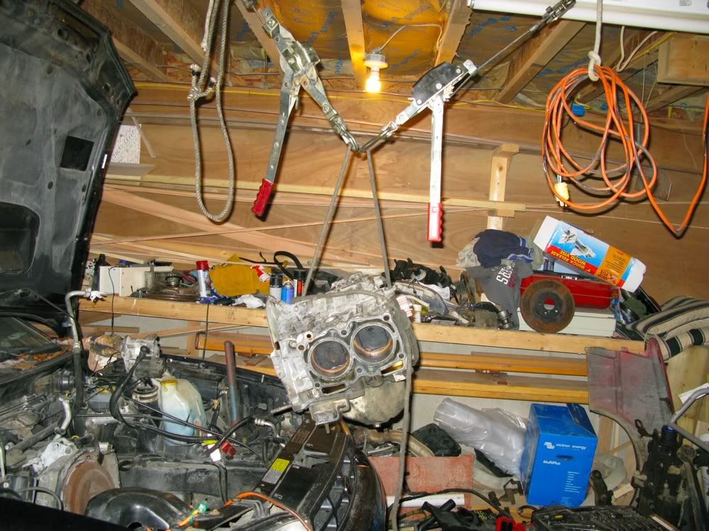

Hauling the chunk out, and transferring to the second comealong to drop it down infront of the car.
Yes, I can lift an engine block myself, they're not that heavy. I was tired and didn't feel like it.
Combination of angle grinder and sawzall. My most favourite tools. You only have to cut it about 50% of the way, then beat on it with a sledge and chisel, and the bit of aluminum pops out.
One bolt was near the top, that made that one easy. One could be accessed from the access port at the bottom behind the oil pan.
The other didn't take much to get to, and the last one was a PITA. I could only get it out about 5 threads at a time. Had to pull the engine forwards, unthread it more, pull forwards, unthread more, etc.
