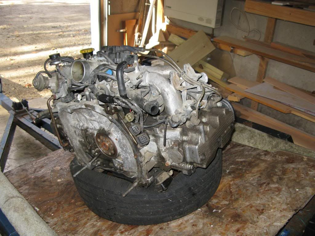

I now have an ej22 to go along with that spaghetti above
I'm gonna make a run-in stand to test it out, but ultimately before I install it I'm going to do at least torque grind cams, maybe some porting and polishing.
I'm excited that the parts are starting to come together!

I got the engine home!! For now it's just sitting in the back of my garage with a tarp over it to keep saw dust off. But it isn't forgotten about!! In the next few weeks I'll be working on getting the harness stripped down, engine cleaned up, and making a run-in stand to do a test start. If she runs nice she's under he knife for torque grind cams, timing belt, etc. If there's bottom end trouble I'll have a lot of learning ahead of me!
I was surprised at how light the engine is, last engine I was working on was a steel block V6....
On my trailer in my garage waiting for someone to get home and help me lift it off.

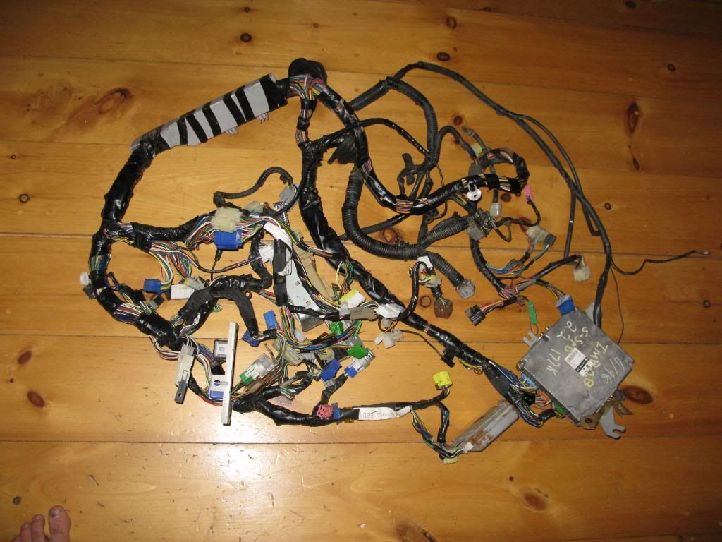

So I took the harness out to the garage for a meet and greet with the engine. And they don't seem they match... The engine harness plugs don't fit together. That could be an issue. haha......
i thought of that after you left the other day the motor is a phase 1 but the harness is a phase 2 so if you want you can come and pull the harness from the impreza when you get a chance
how do you know people put 2.2L in place of 2.5l and they don't change the harness to put it in so i assume they are the same harness and brain
