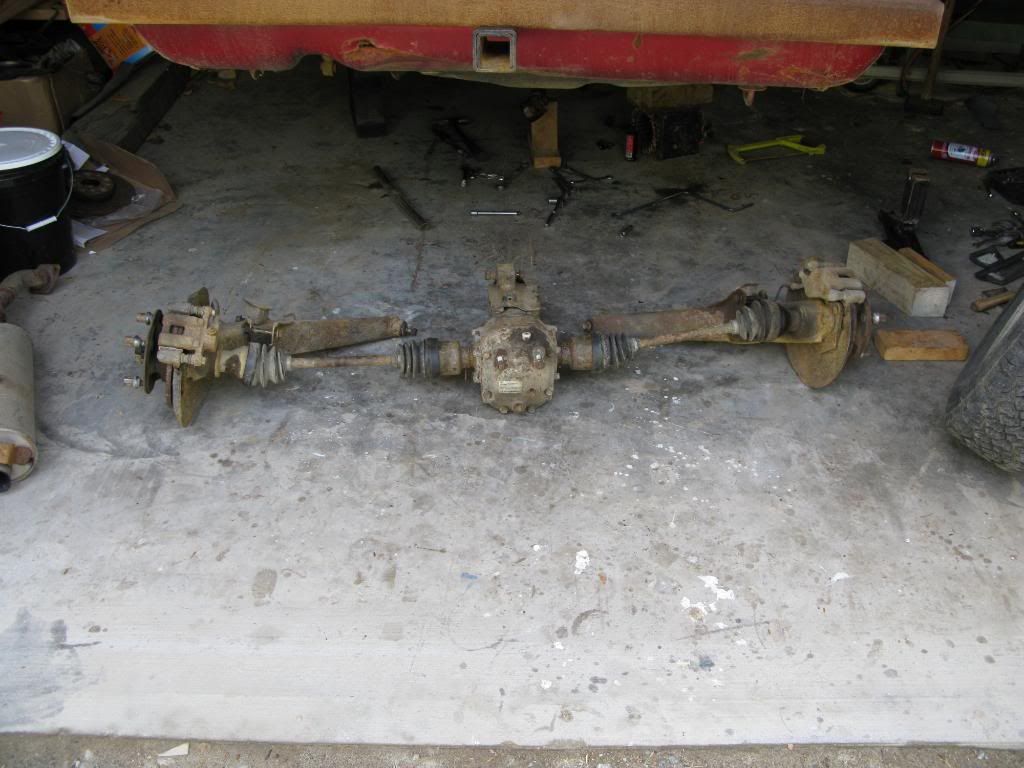

Making profuckingress! The whole rear end of the car is on the floor. Since I can't get my axles out (which a bigger battle than I feel like waging) I had to drop the diff, and both ends at the same time. I'm one person, I don't have a floor jack. It was a pain in the back.

Rear end hanging out. GOD DAMN that thing is heavy!!
I wish I was more than one person and I had a floor jack or two. Then I could drop that and the frame as one piece. Oh well

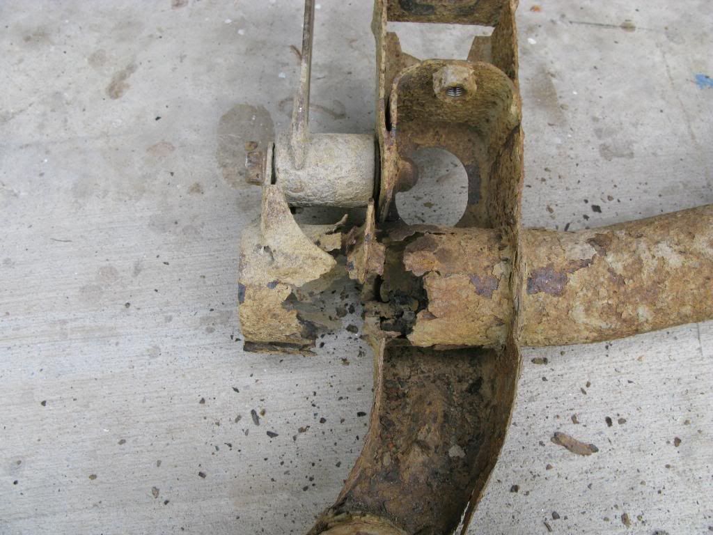

Here's the damage!! A LOT worse than I could tell just looking at it on the car! Holy FUUUUUUUUUUU, it's so flimsy I'm lucky I didn't have it break on me. REALLY lucky.
