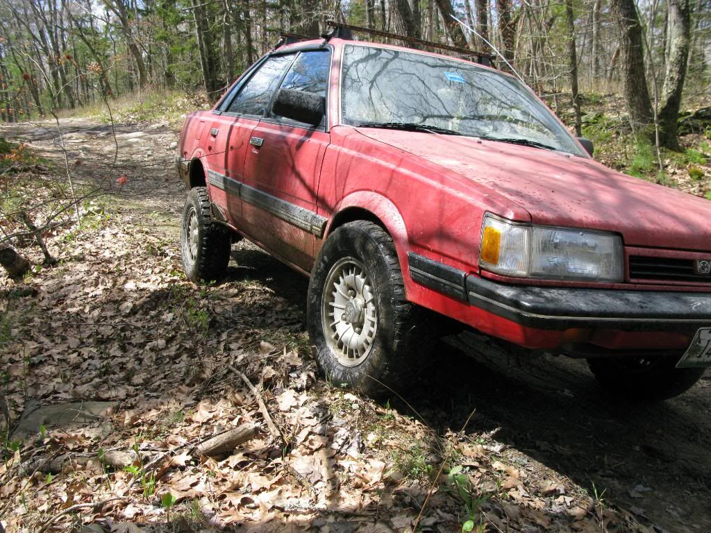

So today I was in Damariscotta, as I was getting out of the car some guy walked by and said "That's one badass ride you have there!" and gave me a thumbs up.
Awesome!!! I knew you took pics!! Yeah I'm thinkin pretty seriously about getting my Brat back on the road. It really doesn't need anything, just a sticker and registration. And now that Chris has my old GL, I'll actually have someone to go out and have fun with!!! Thanks for postin the pic!!

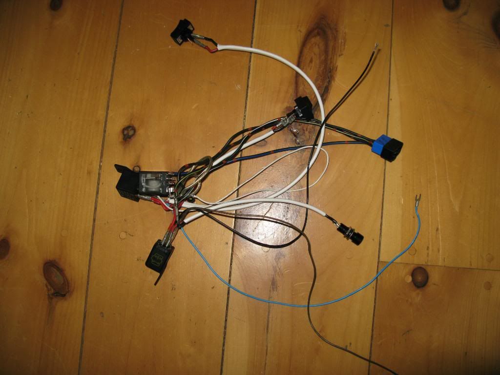

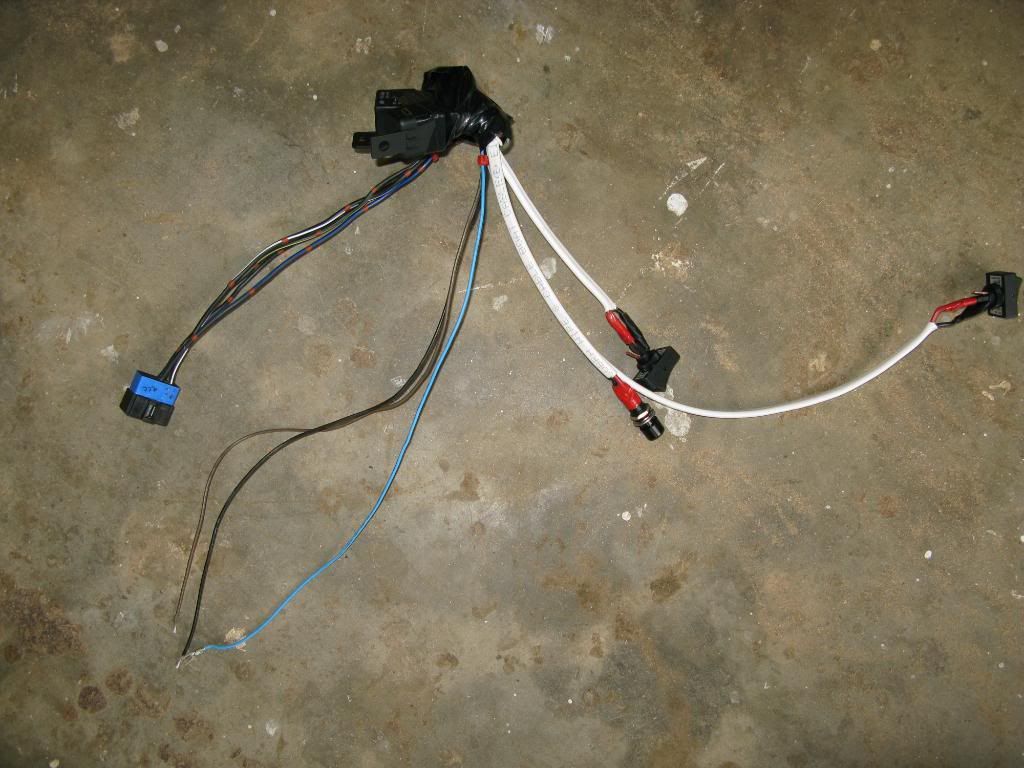

Some new wiring before I gave it some zip ties and electrical tape:
all cleaned up, what could it be?
It definitely isn't for a radar detector

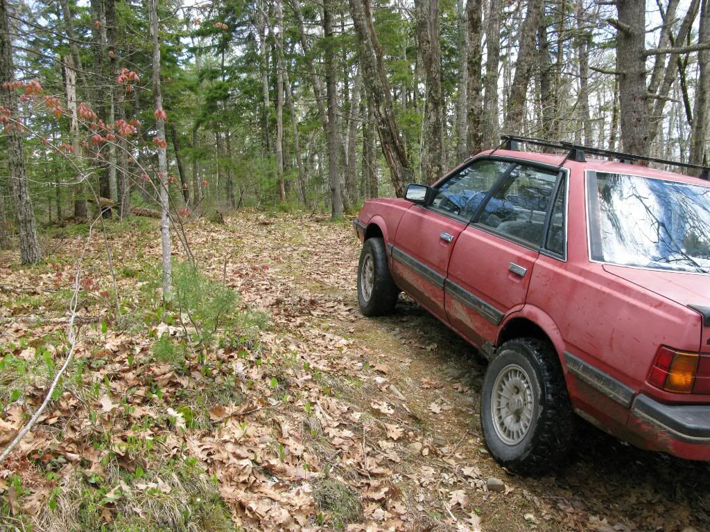

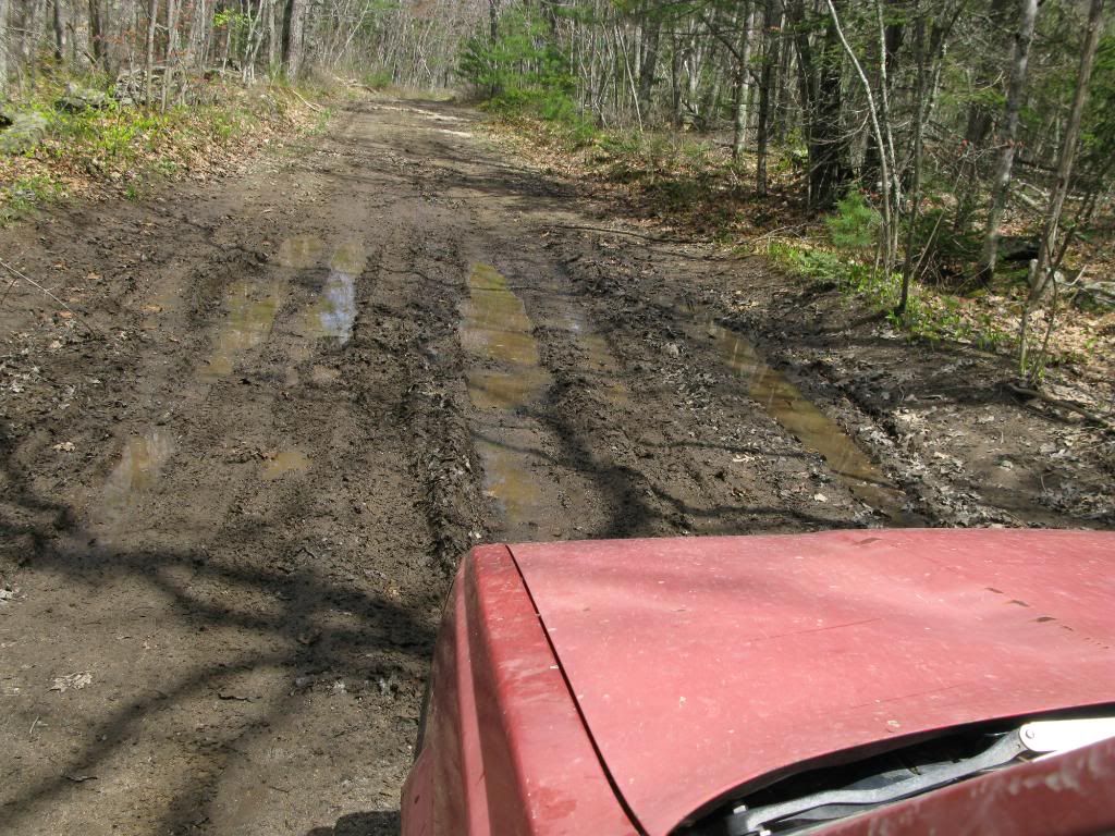

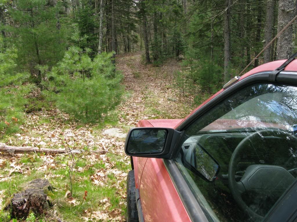

Mmmm, my kind of road
where can it go?
Enjoy
Haha nice!!! Did you get that wiring in yet??
Good to see you are using the car!!!! Can't wait to go out!!
