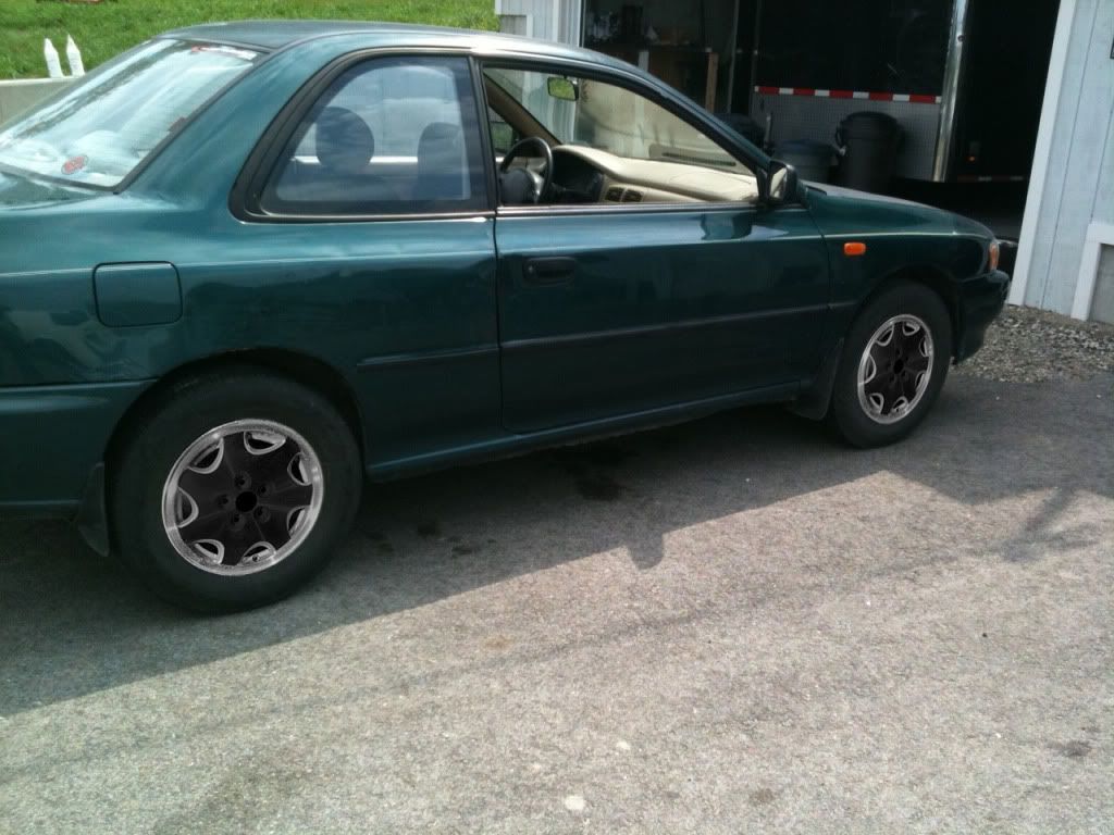

Thanks to DrakeHale I have a rendering of what my wheels will look like once they are done. With a silver insert in the center if I can find 4 good ones. The wheels only had 3 and atleast 2 are junk.
They will definitely have black but where and how much I am not sure. What do you all think?
