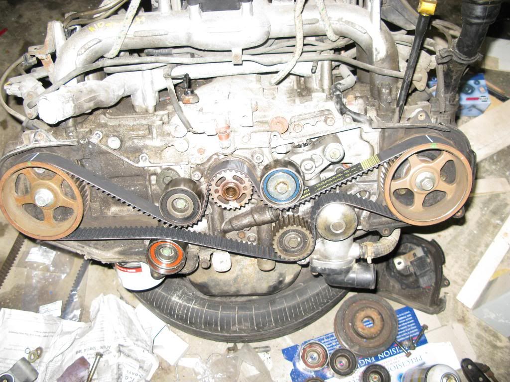

Tonight after I warm up a little bit I'm going to go back out and get the timing belt on the swap engine! That'll be exciting.

Here's a pic.
Looks good. Glad all those parts worked for ya!! And the crank seal too?? Did you consider doing the valve cover gaskets while the motor was out?
oh poop. I forgot about the crank seal. haha. I should really do the cam seals too. It isn't leaking though... Yea, I should do the valve cover gaskets, those always leak. And I've had one off. It's a lot easier to do out of the car...
Hmmm, well just hope none of those start leaking anytime soon. Because then you'd have to take it all back apart again, and in the car!!
Yea.... I know. Oh well. haha. I'm gonna find an ej25 for it eventually anyway. So it's not staying in there forever.
