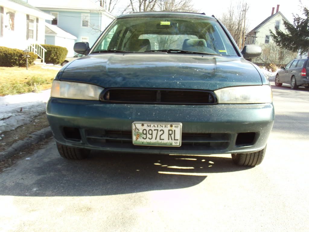

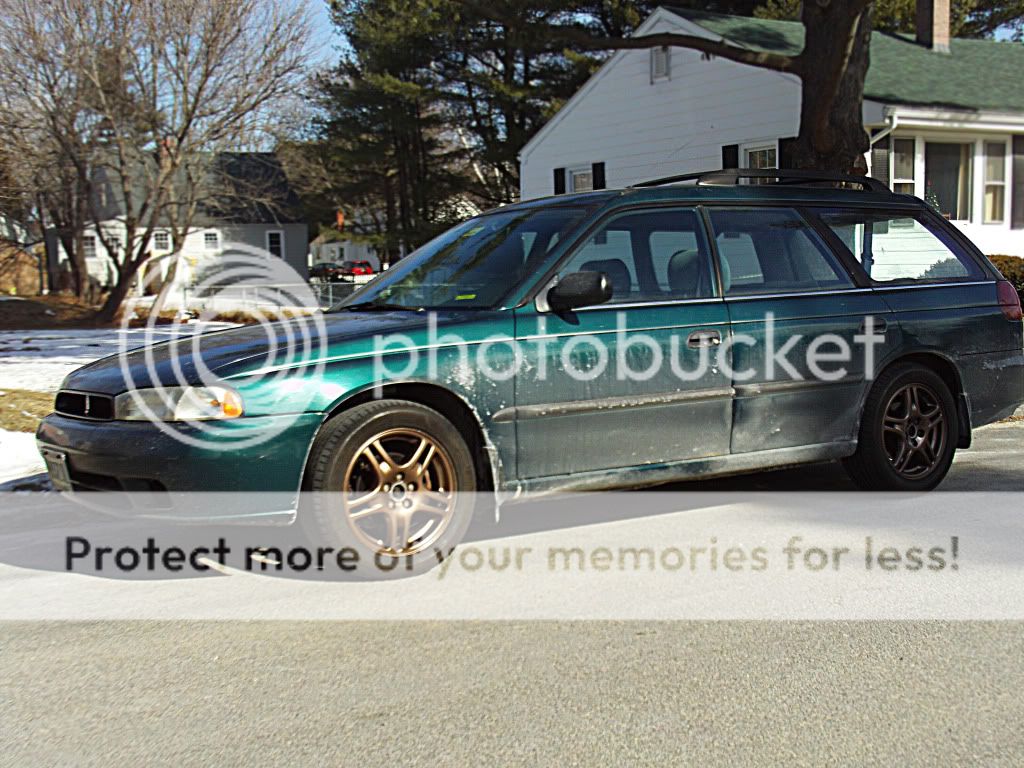

This was the car when I bought it @ 130,000 miles:

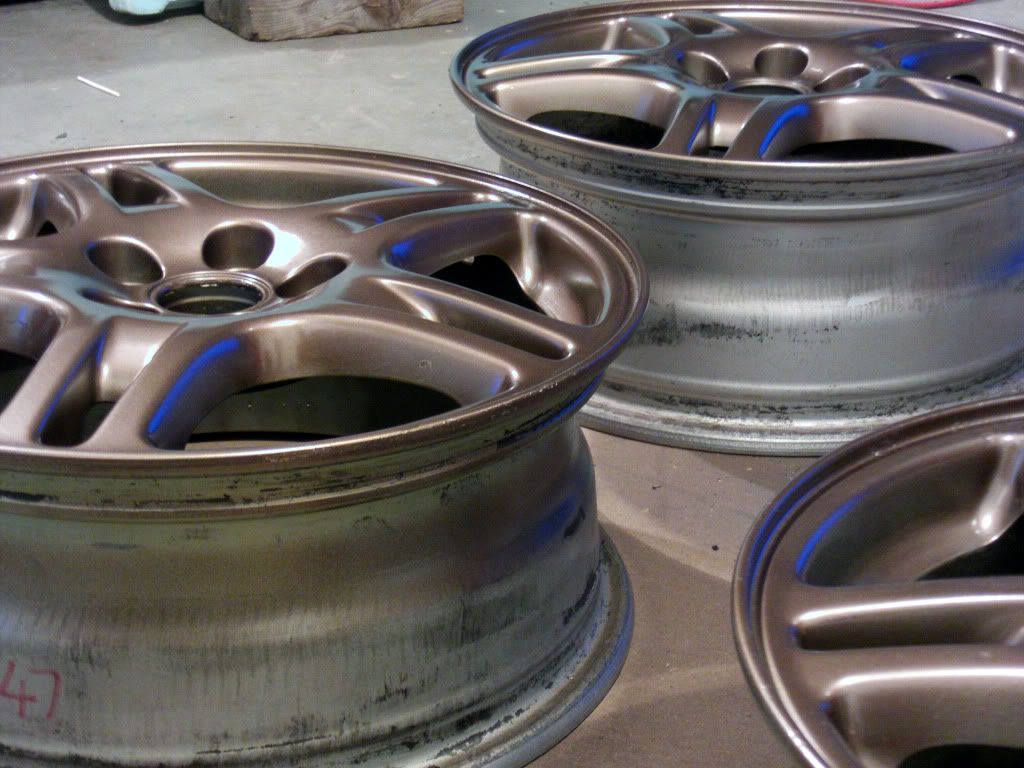

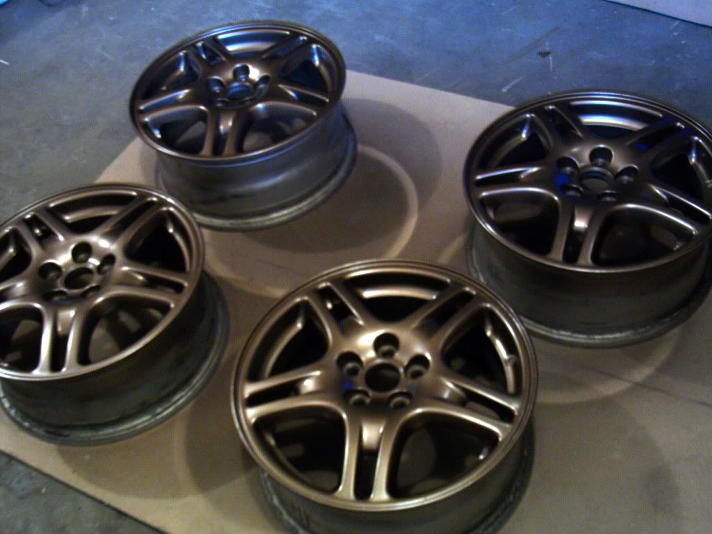

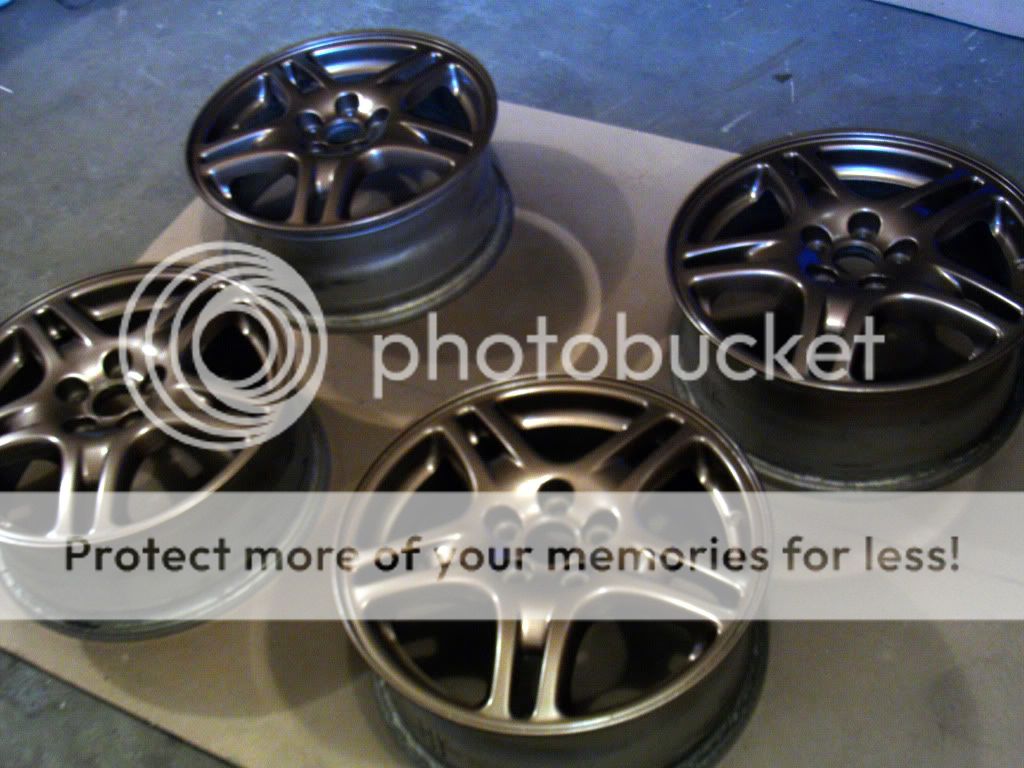

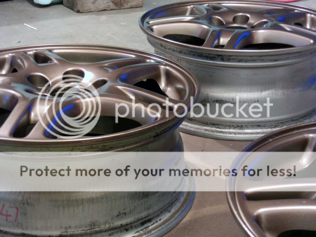

Set of 16in 02 WRX wheels painted bronze

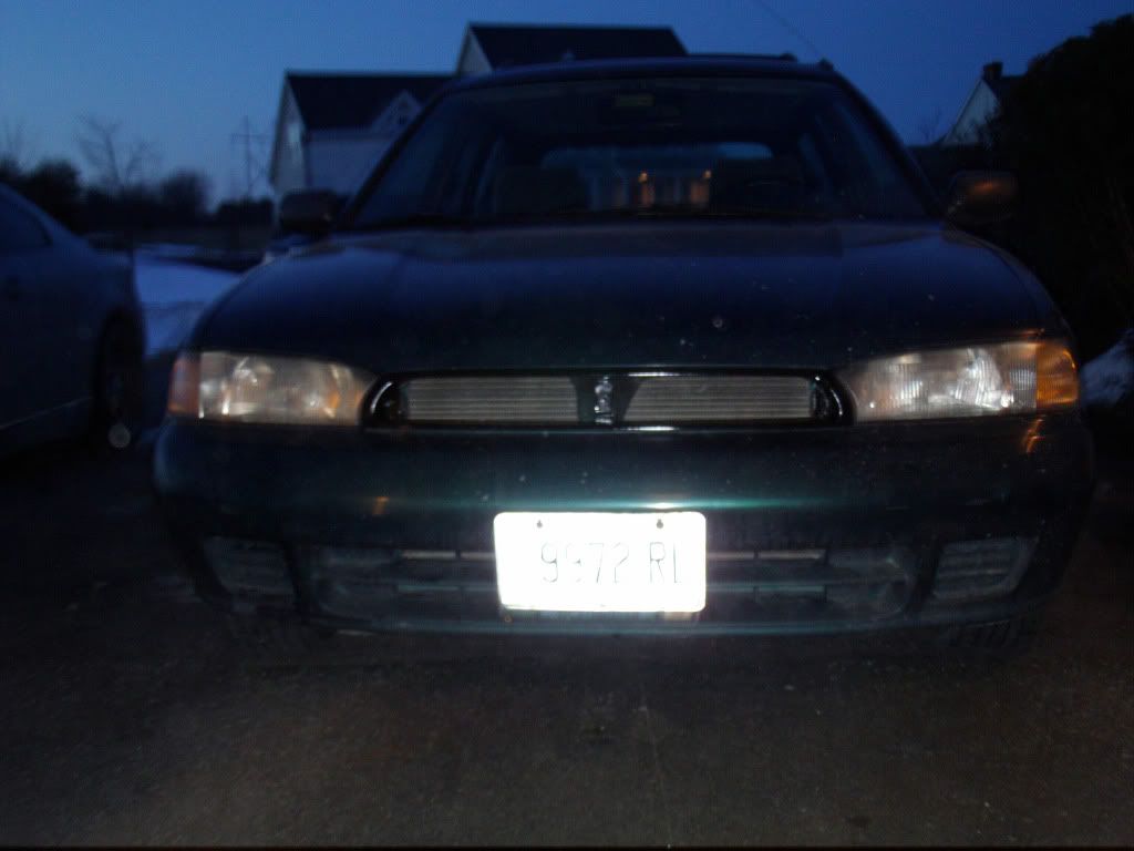

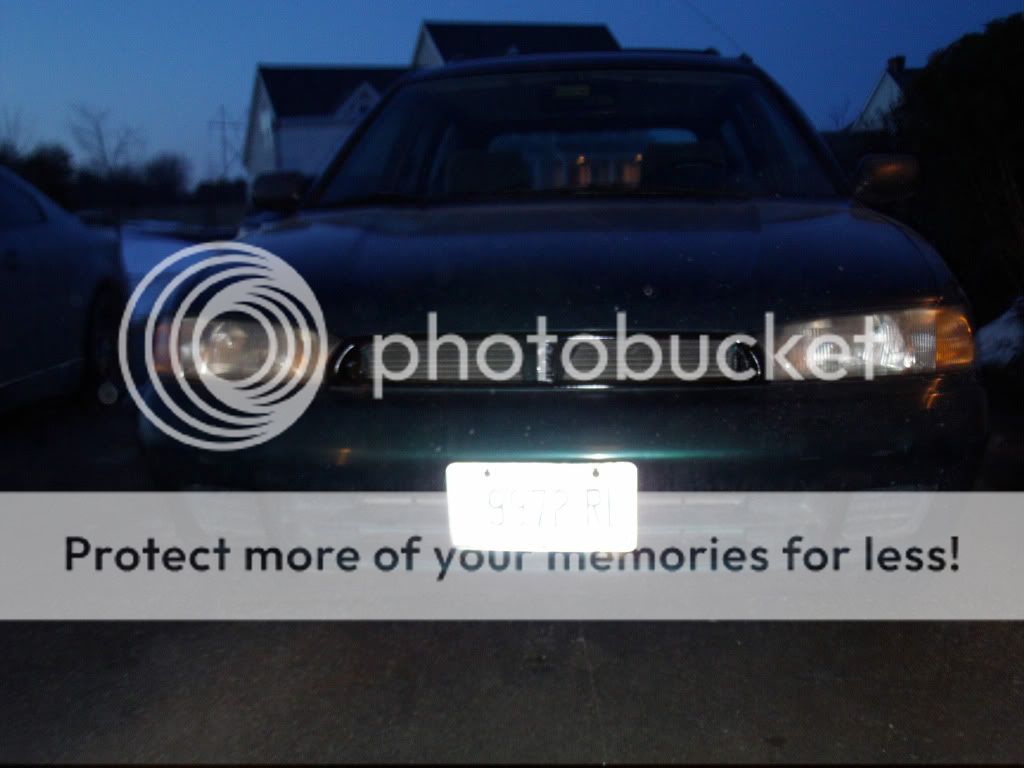

Modded stock grill... waiting on emblem (pink stars badge) and my new yellow ion fog lights to put behind it (both are in the mail).

That was fast pat. Did you end up just sanding them down a bit?
I soaked them in the bath tub and got someone to sand them down for me... Just wanted to get them on (fixed the spot with jb weld)...
I will prob just use these as winter wheels if I do get the swap. Trying to find one to get into it before march... but I am on a tight budget!

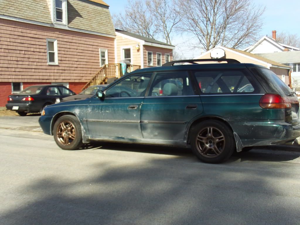

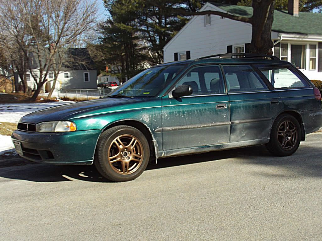

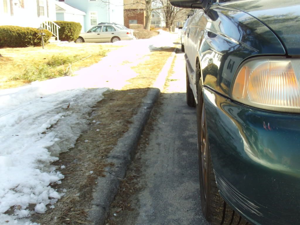

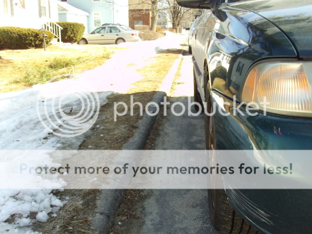

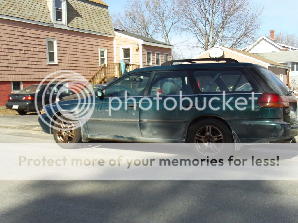

Got the WRX wheels on... IT NEEDS TO BE LOWERED NOW!!! WAY TO HIGH FOR ME! (205 55 16 bridgestone Turanza EL42 RFT... hey they are free and almost new)

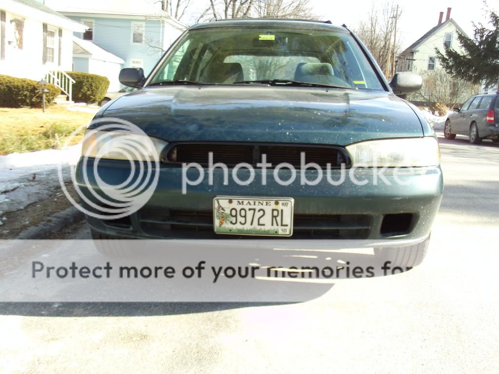

Also cut out the sides of the bumper for the new fog lights to go in.
hella flush??? LOL
