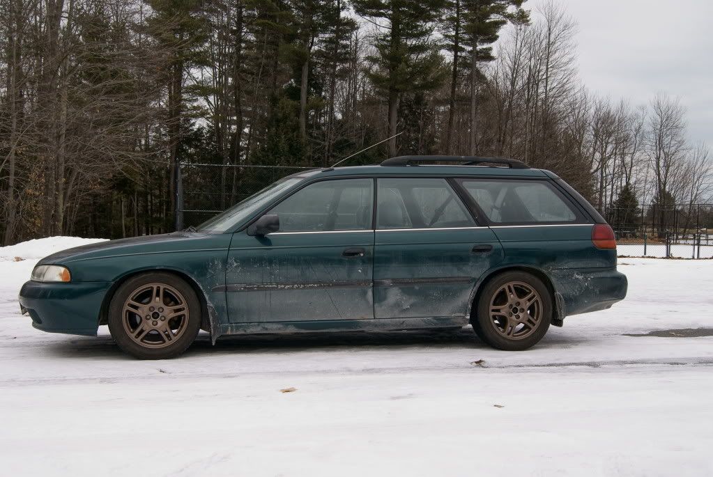

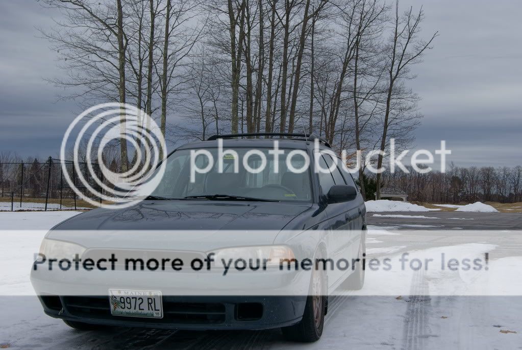

3.5 inch drop in front/3.25 in rear...

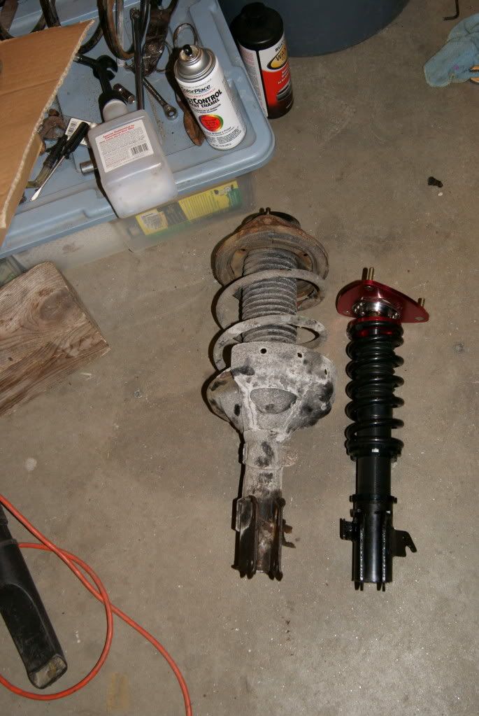

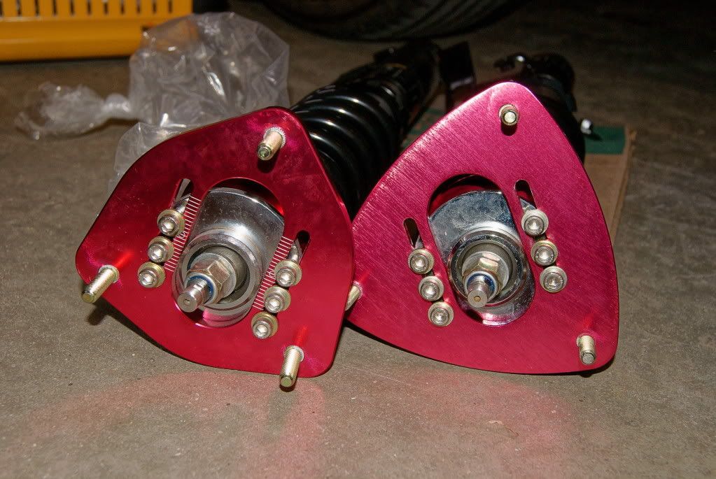

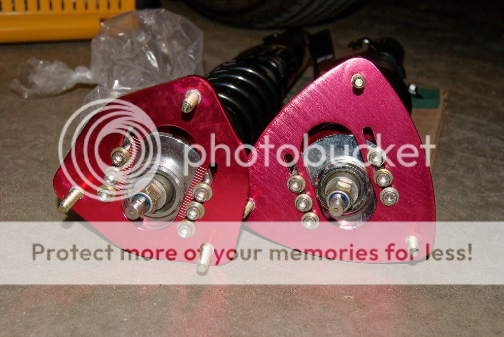

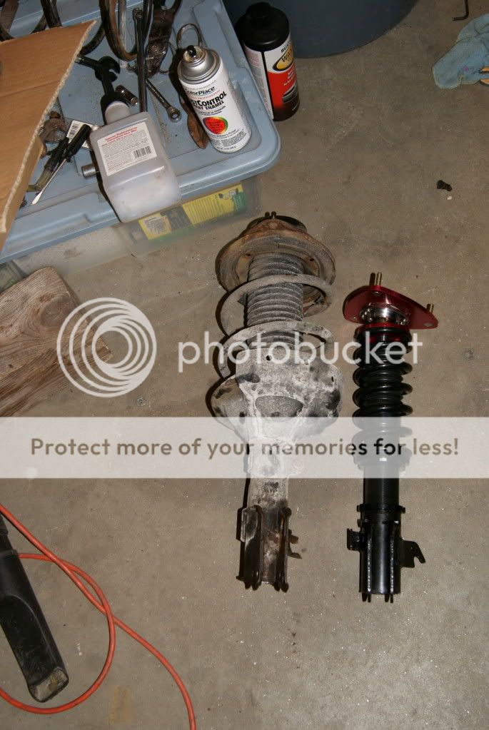

Got a set of EMUSA Full Coilovers for a 02-up WRX.
16 way adjustable... full height and preload adjust... 8front 6 rear spring rates... Pillow ball camber plate mounts.

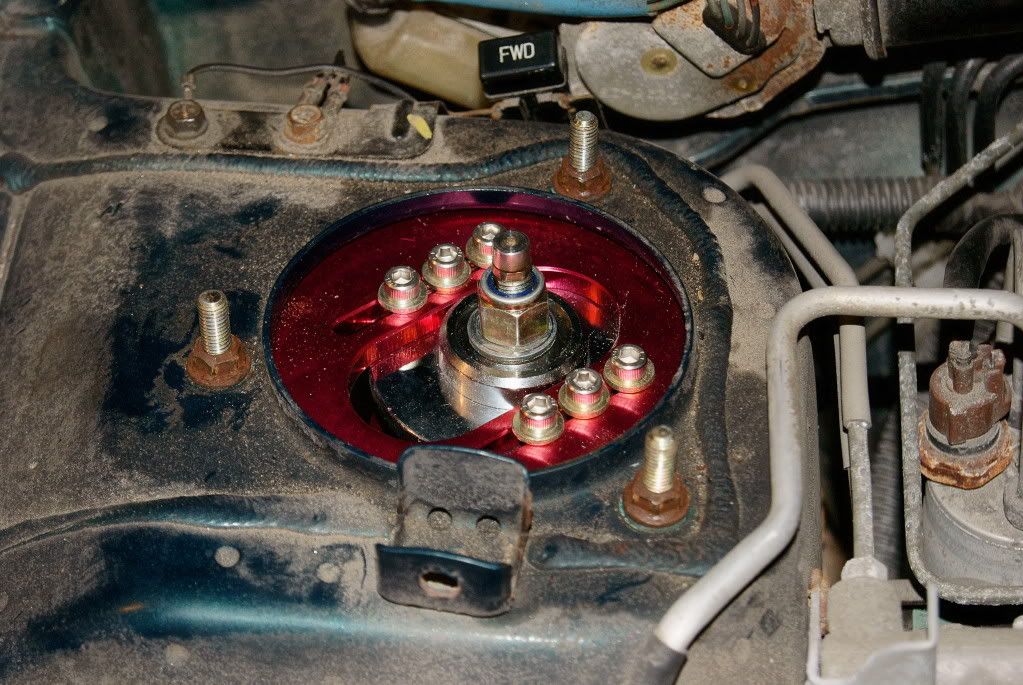

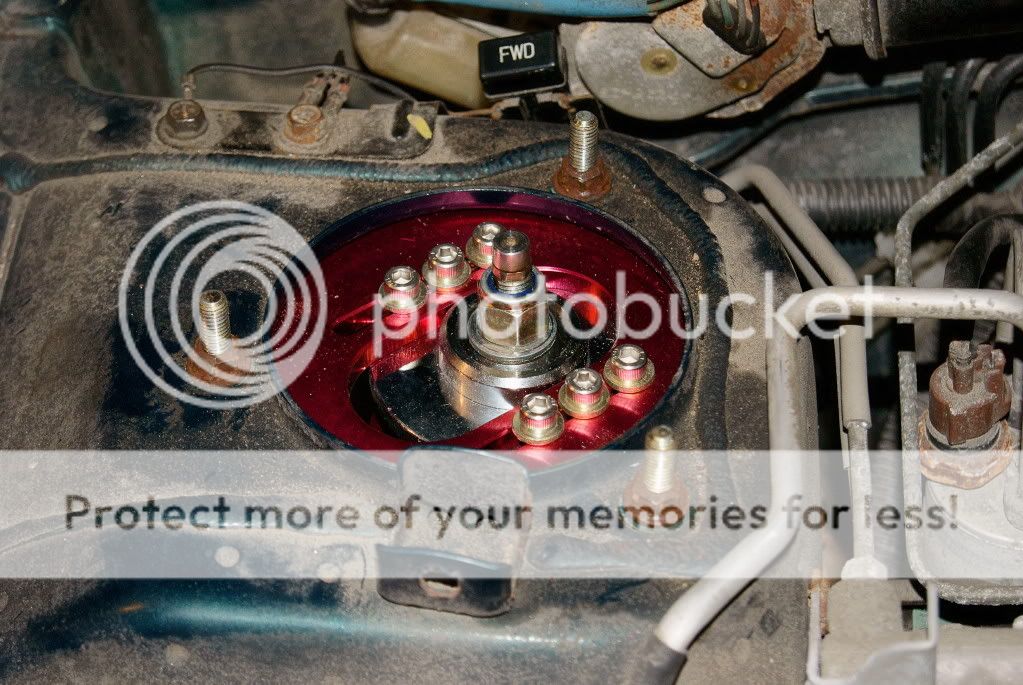

Had to slightly mod the bolt holes on the lowers. Also the rear camber plates line up perfectly... the fronts are off so it does a toe/camber adjust (we measured and put it dead center and kept as close to stock... a little more camber
Had to drill upper camber bolts and all rear bolt holes out.

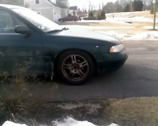

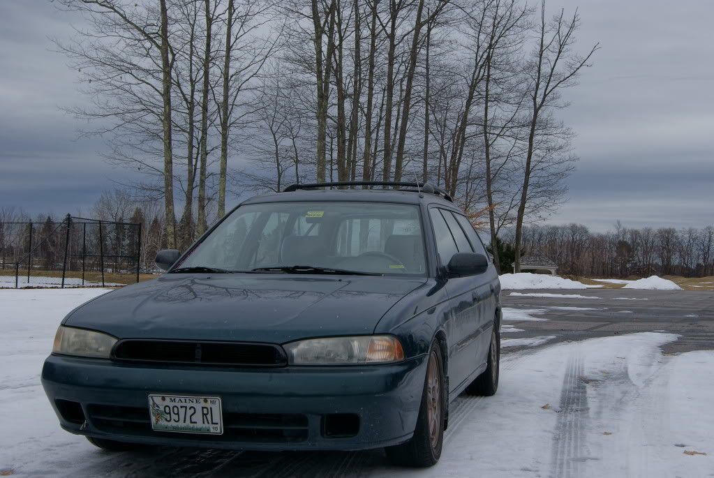

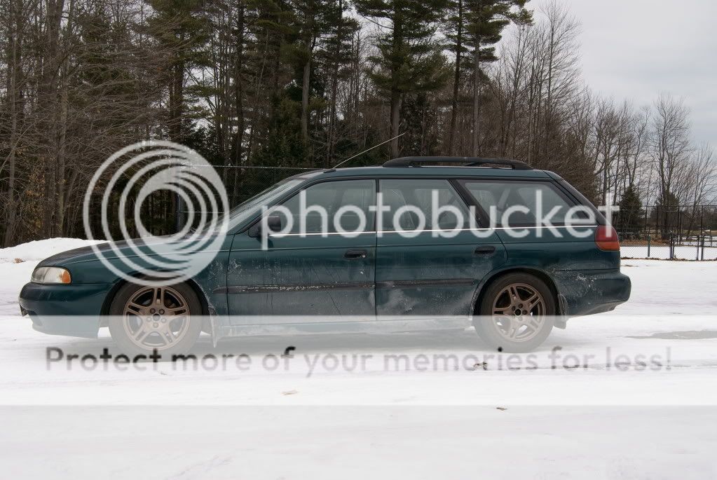

draggin frame

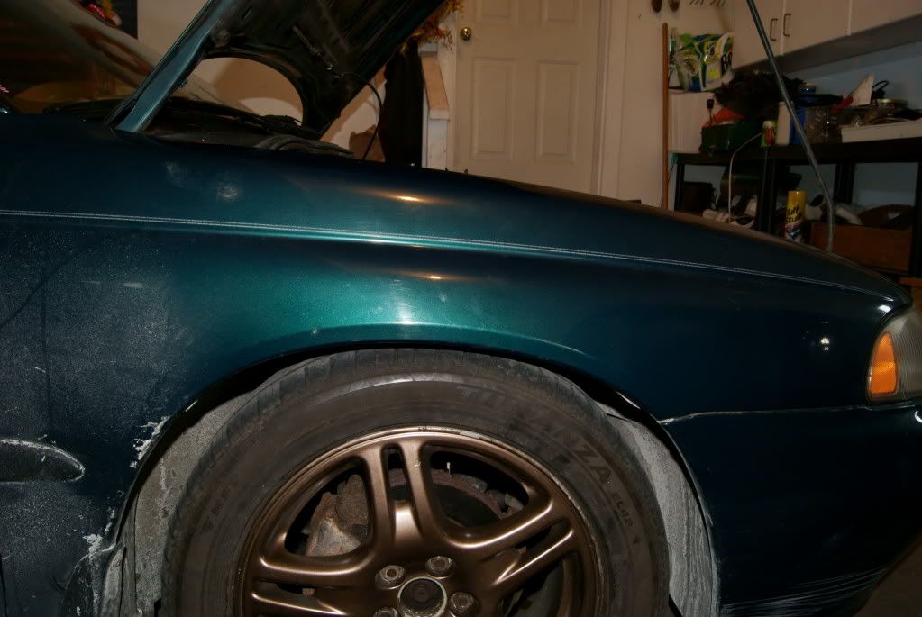

No it isn't that low... Its winter mode. It could be dropped another 1.5 inches and still be fine. It really doesn't look low either. LOL but this summer is wagon drag'n time!
those front camber plates should not be sideways like that....
Yeah they should... the are for a wrx... They are now set closer to the middle. You would have to either drill out the strut towers and resheet the mounts because the welds are in the spots to drill in the front or measure(like we did) and get centered. The rears fit perfect.
Its how they do it with these (saw a few threads on it and it works my allignment is fine now... took a few resets but good to go now).

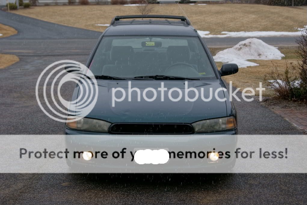

Got some new 3in foglights for the front.

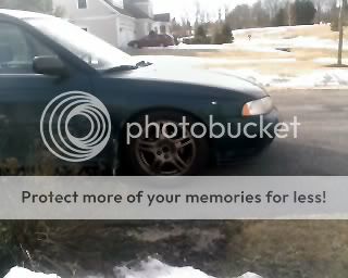

These are a few quick snapshots I took around my house... ill get some better shots when i wash it and its painted!
Yellow Fogs (they are bright yellow)
